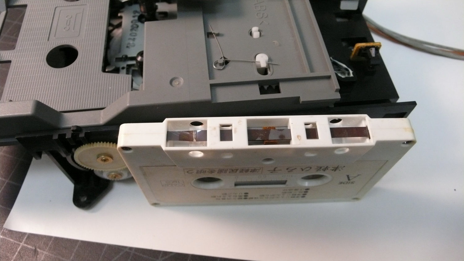

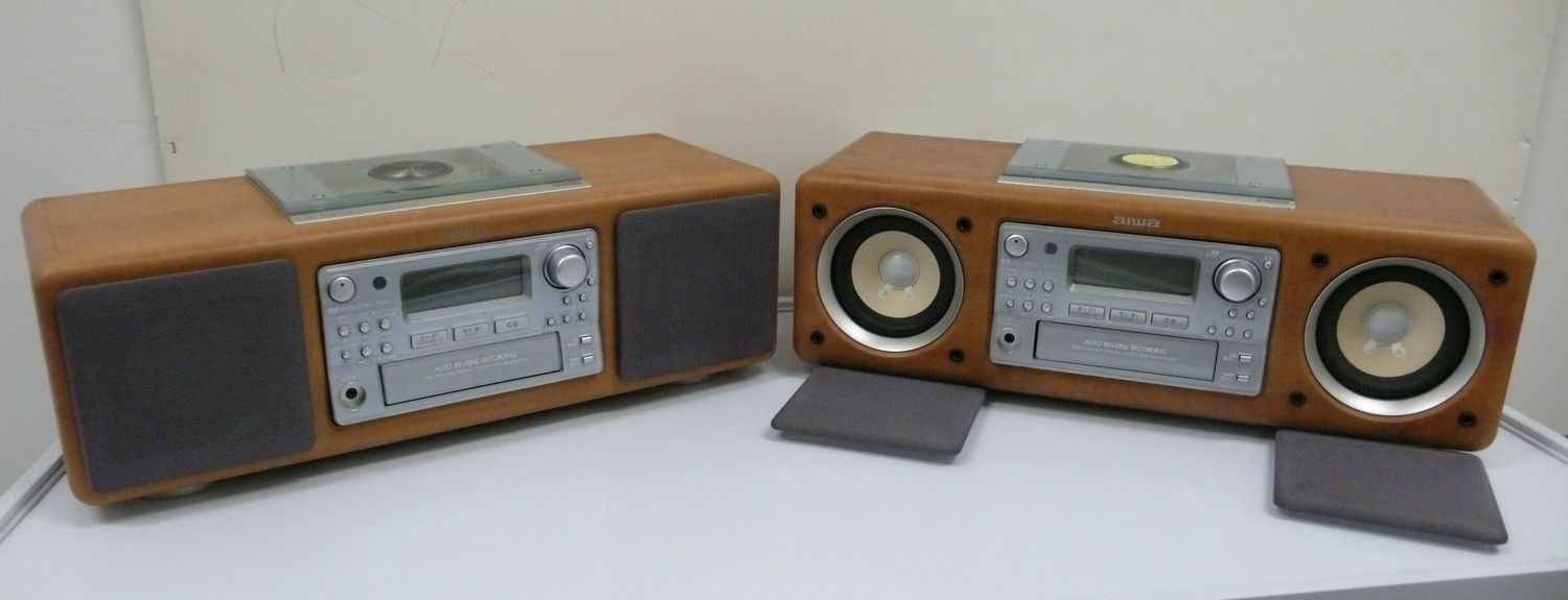

    Happy ending first: after a few weeks of cluttering my workbench two CSD-NS1 Aiwas are back in two pieces and ready to get out of my sight:
    Both Aiwas died in Play mode, with cassettes inside and pinchrollers pressed against tape and capstan for God knows how many years:
    Once you get over the usual of melted belts and recent tenants...

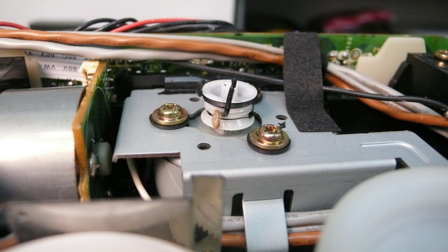

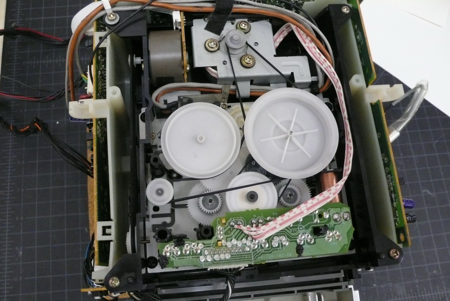

    you get a chance to admire the "state of the art" of mechanics circa 2002:

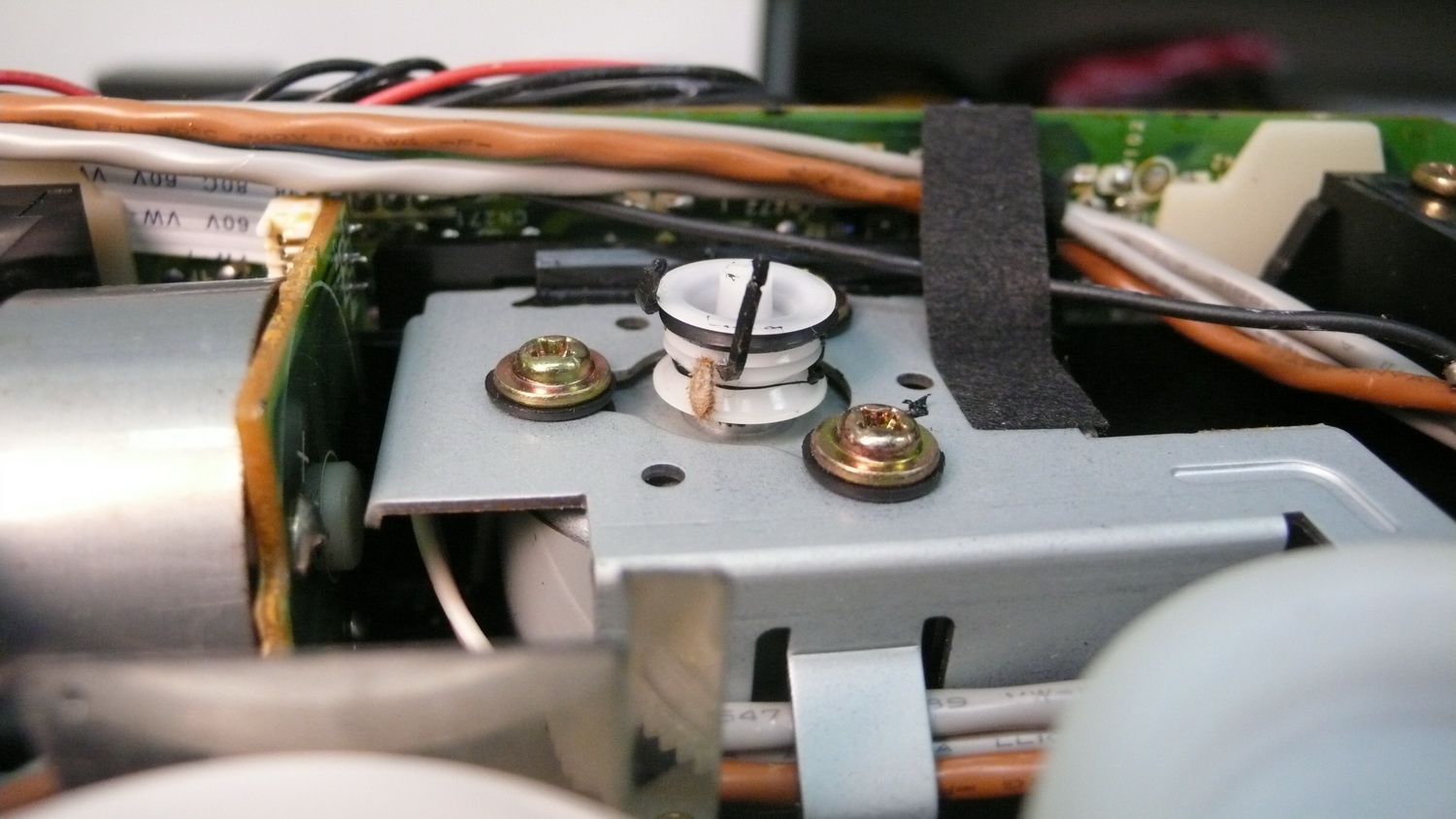

    feather-light plastic flywheels, four belts of different sizes, whats not to like? More surprises on the flip side:

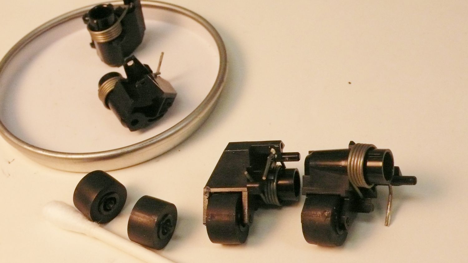

    Two autoreverse decks, four pinchrollers (and No, these are not closed-loop dual-capstan mechanisms): how did we get three out of four rollers dented??? As Kung-Fu master would have said: your math is better than mine! Anyway, one Aiwa gets one good roller for Forward Play, slightly dented for Reverse. Second Aiwa gets the leftovers.

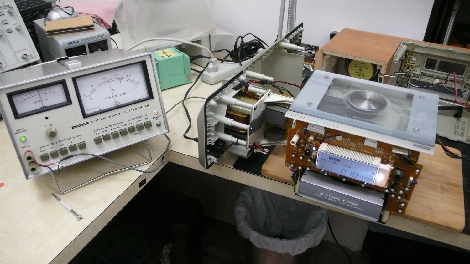

    As a reward for the efforts, what do we get? W&F at 0.4, speed adjustable through a pot on the control board: No, it is not a quartz-locked mechanics:

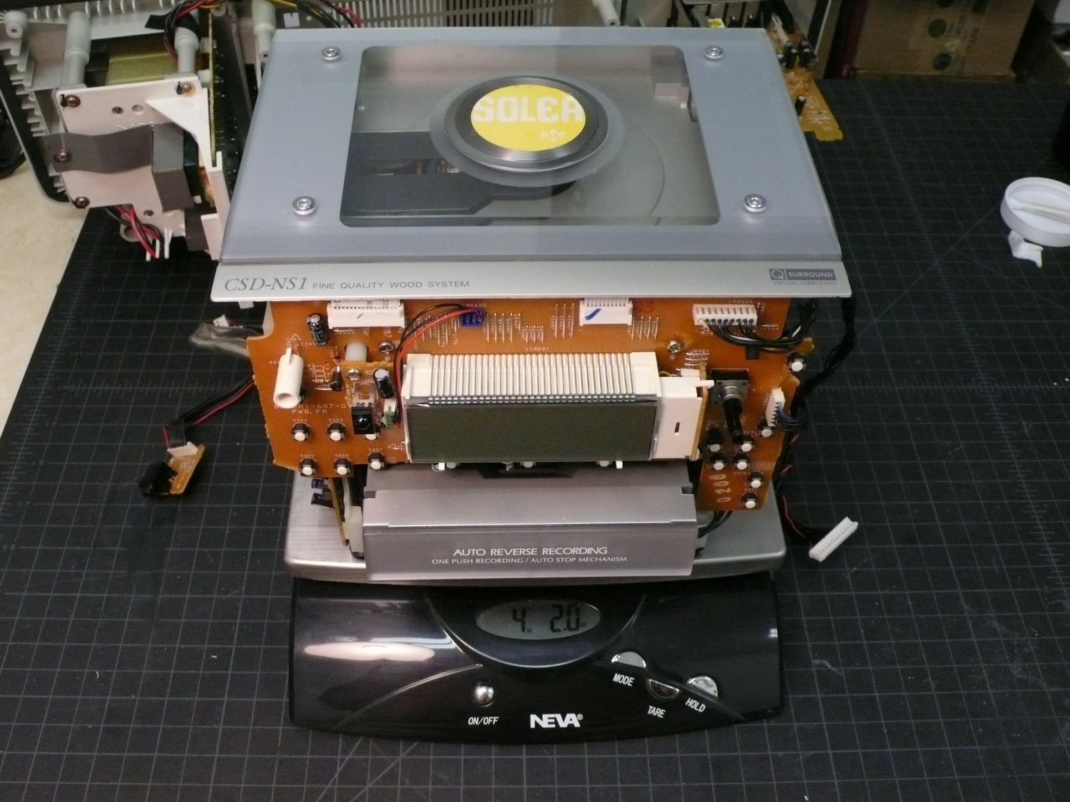

    More fun ahead: the whole cassette-tuner-CD block weights over 4 lbs

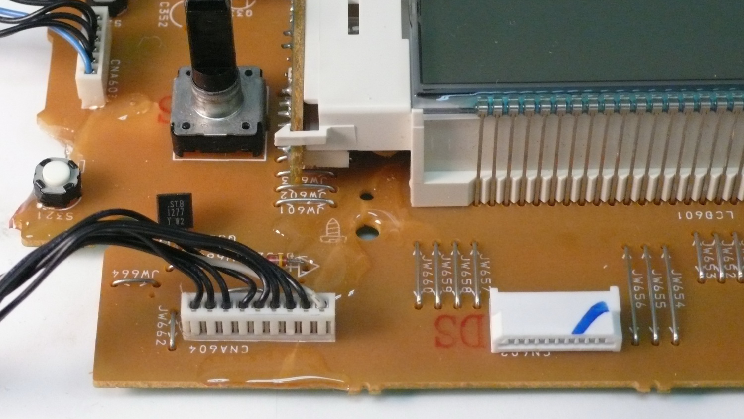

    but it is secured to the front panel with two screws through the front control PCB. What a Grand Idea for collecting on shipping damages:

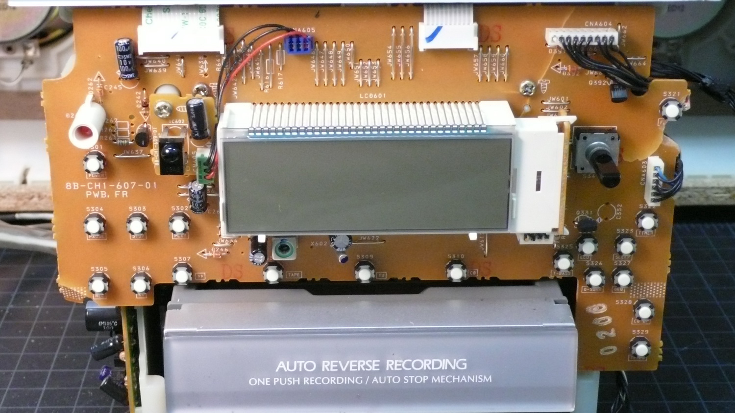

    Generous amounts of epoxy to strengthen the board:

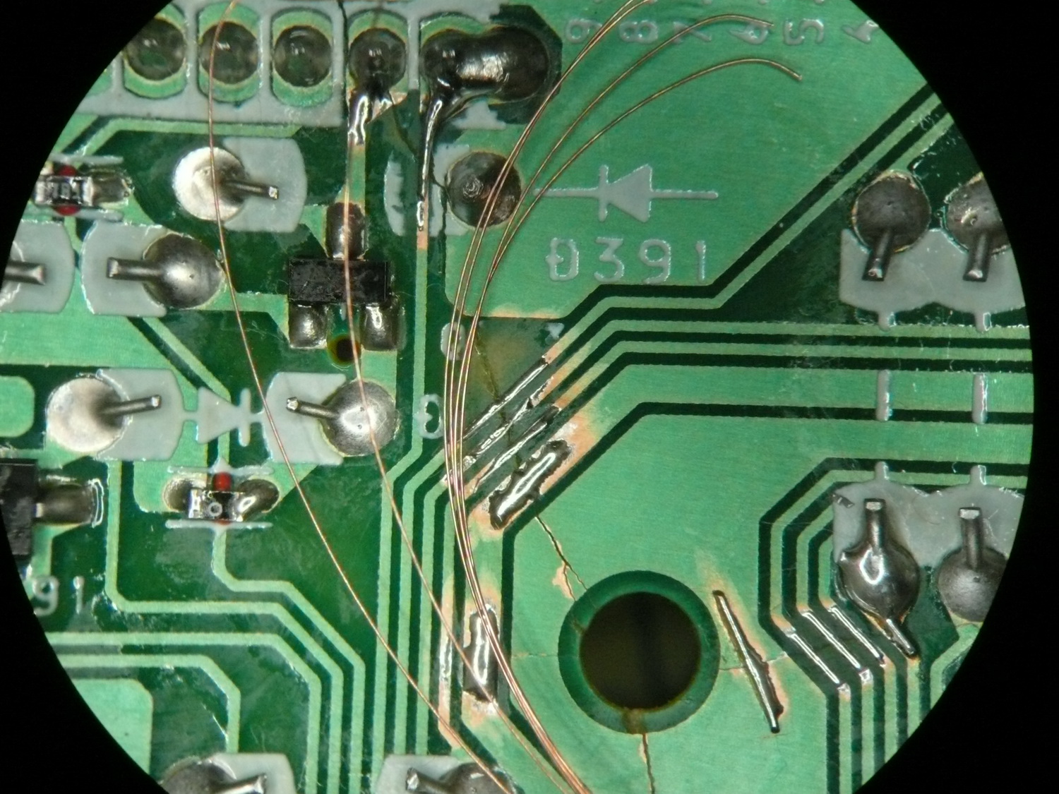

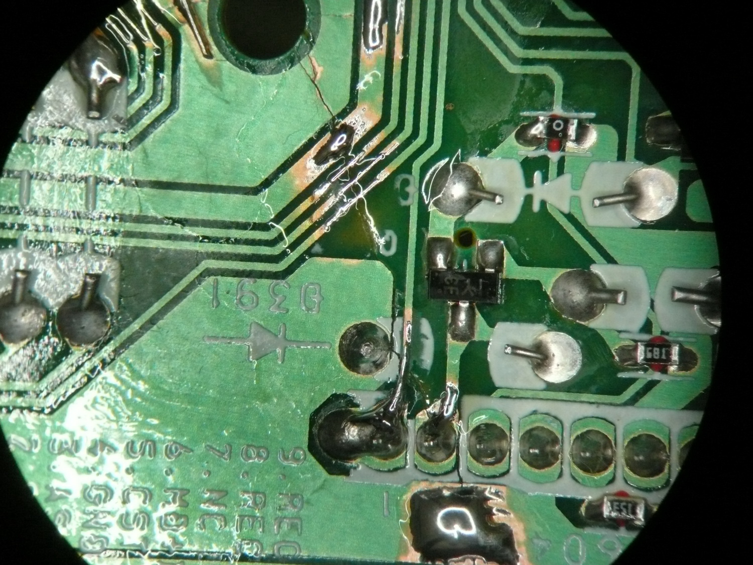

    Before you ask: these cracks go all the way through the traces, time to do some microsurgery
    short pieces of multistrand copper wire and some patience with Hakko tip fixes the traces

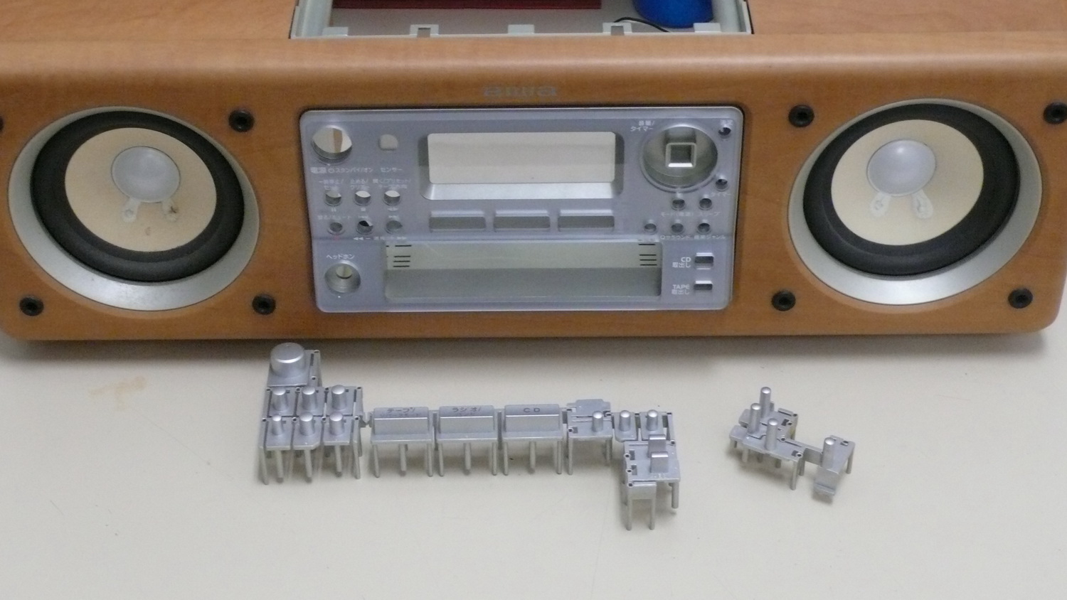

    The fun part of thorough cleaning and waxing finishes the job
