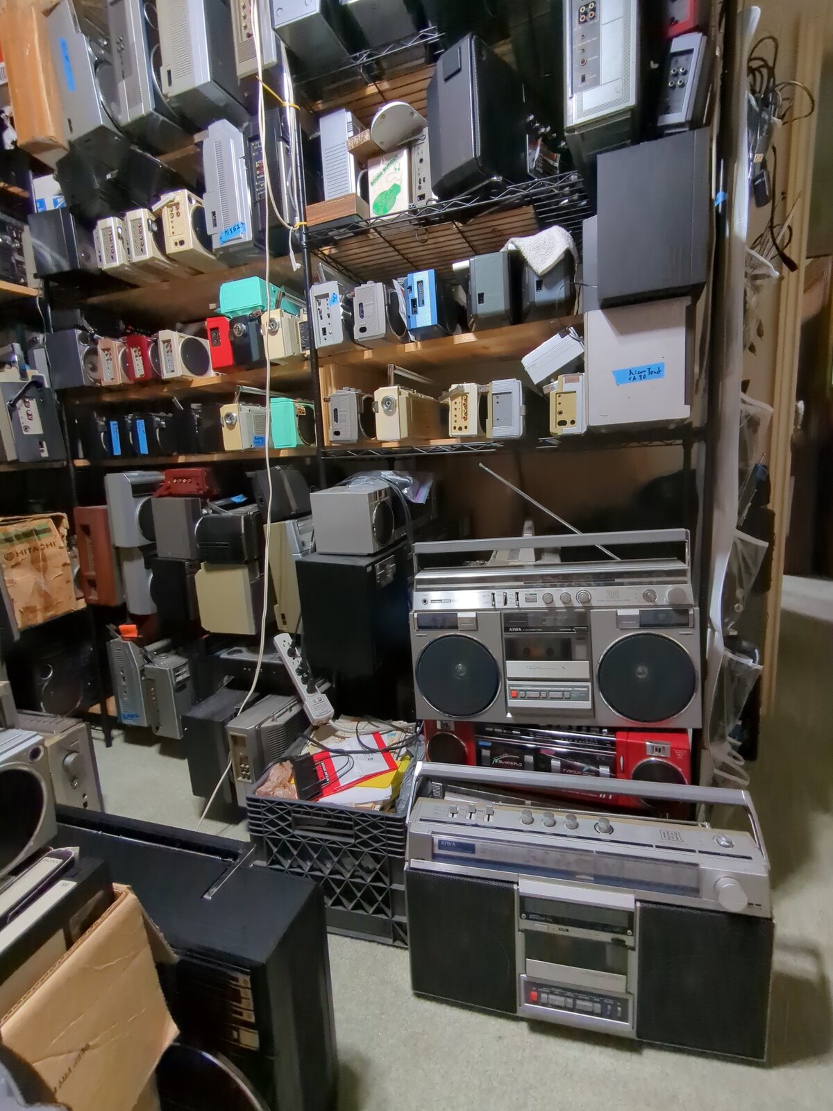

    That's my video where I played it. And yes, the motor constantly runs the moment you plug it in but I made it that way as I didn't want to try to repair it or fix it so that the motor would shut off when you turn it off. The motor simply runs all the time on this particular model with my example. decentman4you2007@gmail.com if you have any questions. 17187342225233786374874726087864.jpg
    Yes I have both models and a few others. Ps did you ever fix yours?

    Send me your address and I'll ship it to you. 17187444946721179623745180598067.jpg
    Here I put my one of my best tapes in it. Played it and took a picture. decentman4you2007@gmail.com send me your address and I'll ship it to you. I did not stutter. I don't think I can say it any simpler.
