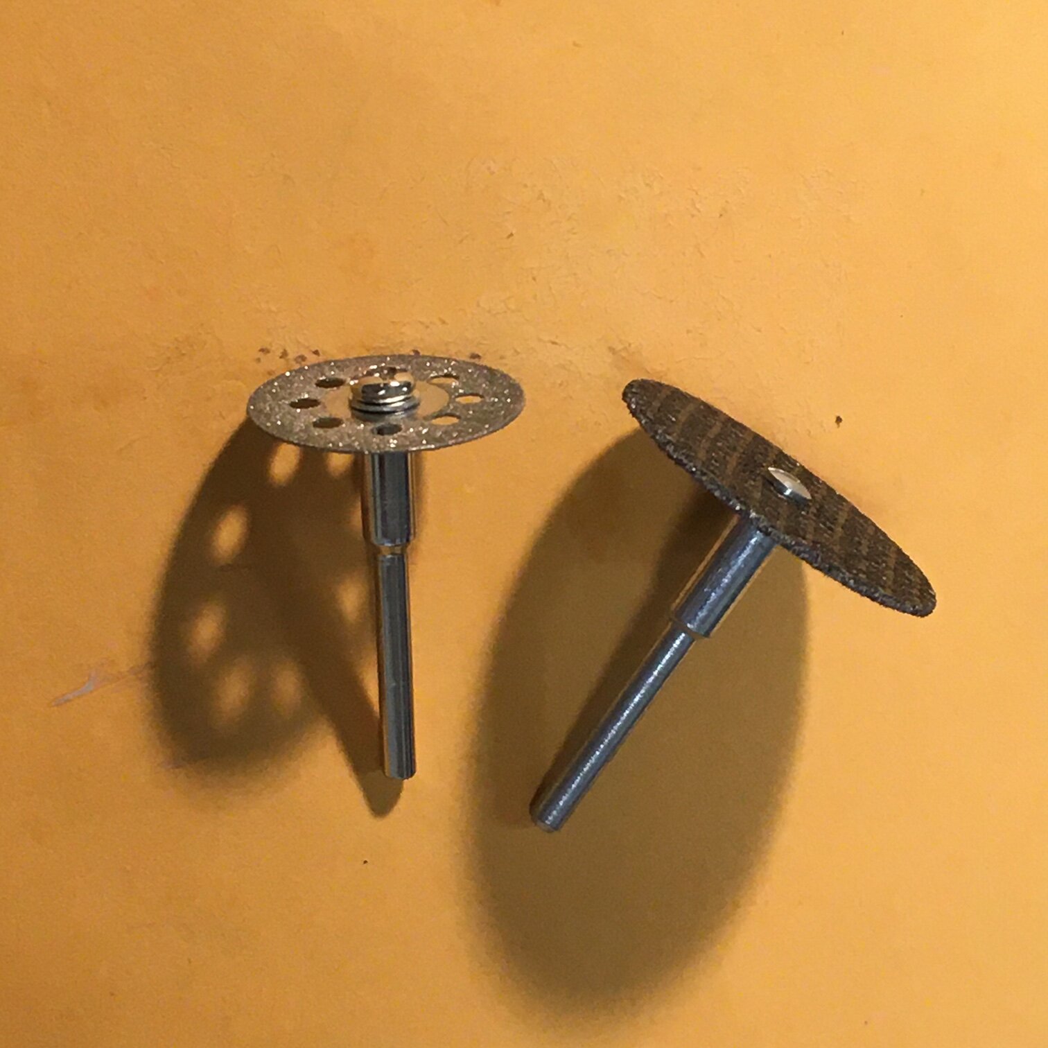

  11. kanamaster
    kanamaster Member
    64
    Germany
    Could you please give one or two links where I can exactly see the kind of tool and disk you are telling me.
    Thanks in advance.

  13. kanamaster
    kanamaster Member
    64
    Germany
  14. Jorge
    1,772
    maybe get diamond #545 wheel. It is much thinner: 0.5mm, not 1.1mm:
    kanamaster and Valentin like this.
