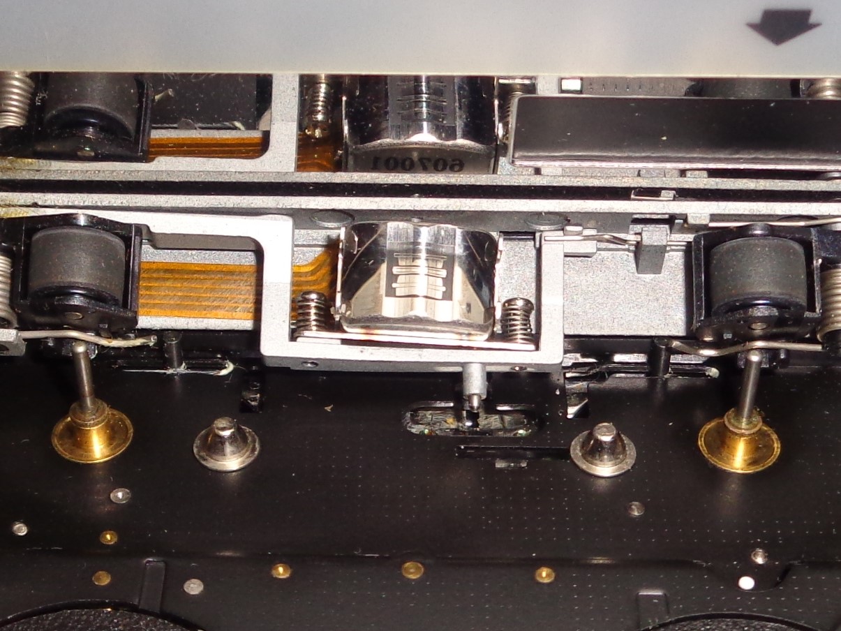

    Something else I notice on closer inspection of the cassette compartment is the azimuth is visibly off (head tilted to the right). This seems to have a bi-azimuth, meaning a seaprate adjustment for forward and reverse, so you will need to adjust both, as one will influence the other.

    Valentin I don’t think the azimuth is off just by looking at it, if I remember correctly those particular Aiwa’s have by-azimuth adjustment. If you look closely you will see a protruding bit of metal at the bottom of the headblock, that moves in and out to control the azimuth while in play mode for forward and reverse.
    I don’t have my Aiwa around to check.
    woofaki don't go messing with the azimuth till you have played some cassettes, even then don't go messing with the azimuth.

    It is possible that it is like you say. On some units with bi-azimuth the head gets into alignment only when in PLAY mode.
    @woofaki I recommend to check playing a tape first and see what result you obtain. And update the thread after for reference.
    EDIT: Now after @Silver965 posted the zoomed in picture I clearly see what @TooCooL4 was talking about. There is a small pin inside the aluminium frame that pushes the right side of the head up when in play. Indeed the azimuth is right on this one, no need for adjustment. So no need to update, it is clear now.
    Initially I did not see that the round part of the head frame and that center silver pin are separate.

    AHHH here's where it ended ... congratulations on your purchase .... I confirm what TooCool4 said DSC02604.jpg
