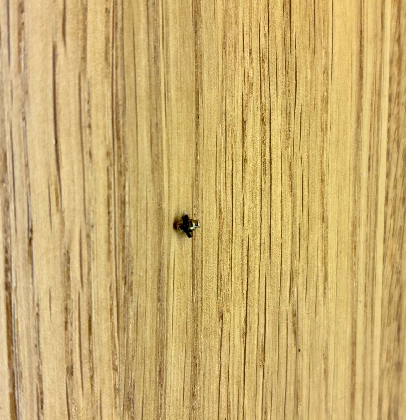

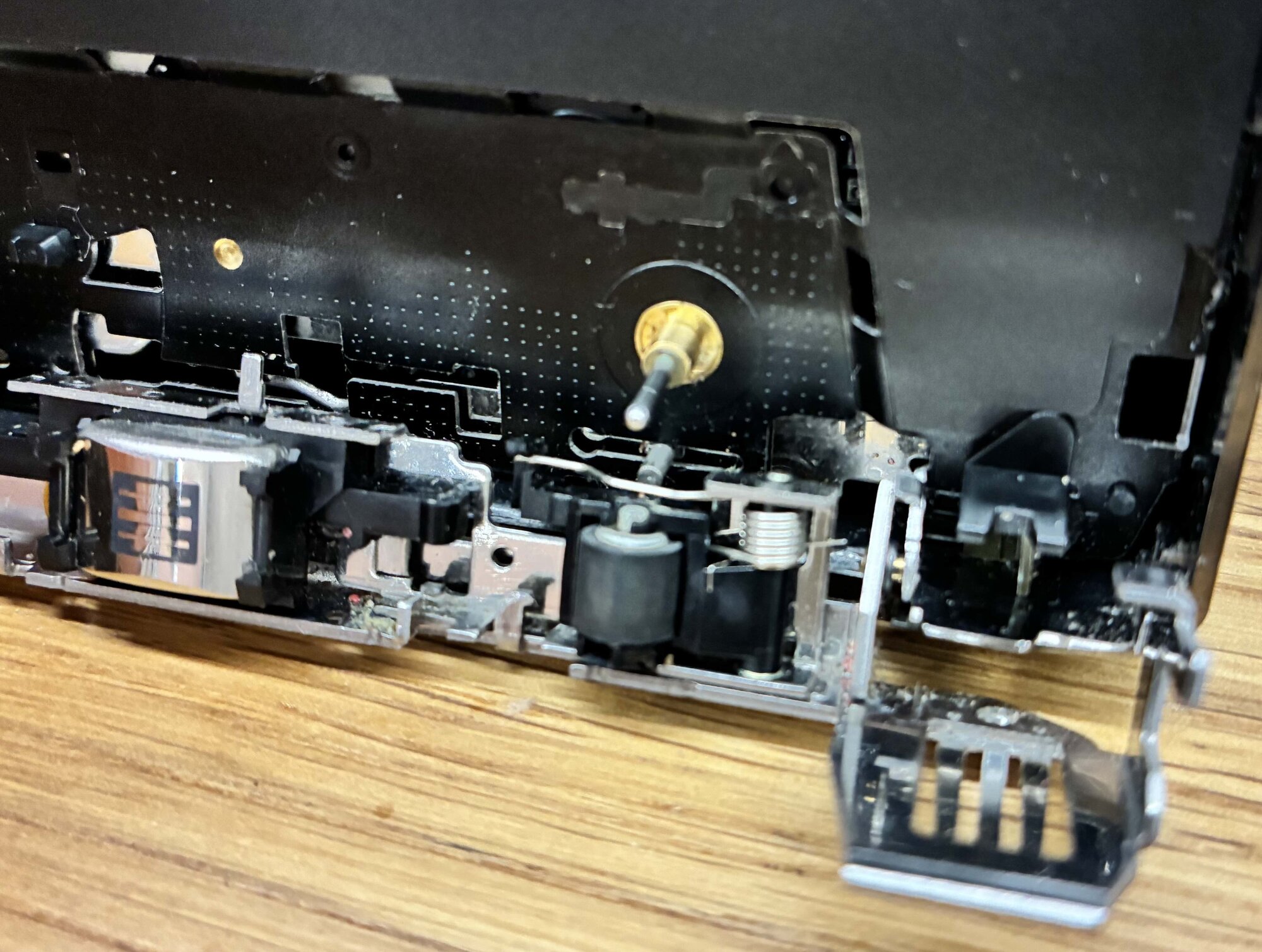

Hi, I faced an interesting problem with my Aiwa HS-PX347. Basically I already replaced belt and capacitors (which started degrading and leaking). But main issue left - door hinge broken unfortunately and while I think I have detail which got broken, I cannot understand how it goes back. And cannot find good pictures of exactly this hinge on the internet. Issue is similar to this video, but if I try to set the detail back as shown there, pinch rollers are not properly aligned. Hi-fi wiki has a nice quality pictures of this Aiwa, but right hinge is not visible unfortunately: https://hifi-wiki.com/index.php/Aiwa_HS-PX347 Attached photos of door mechanism, broken detail and right hinge. Thinner part of detail seems goes to the right, but only tip will be in the hinge and around couple of mm gap will be left, causing pinch roller misalignment. So I'm wondering maybe someone who has this or similar Aiwa, could share picture of this door hinge?
