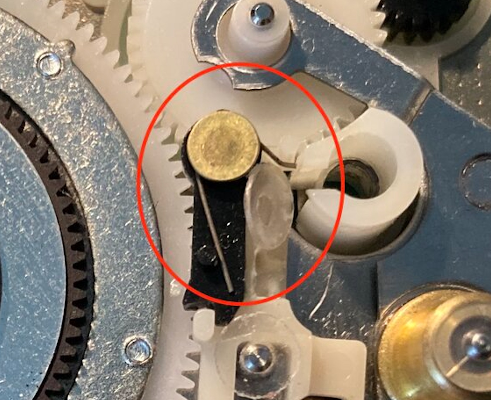

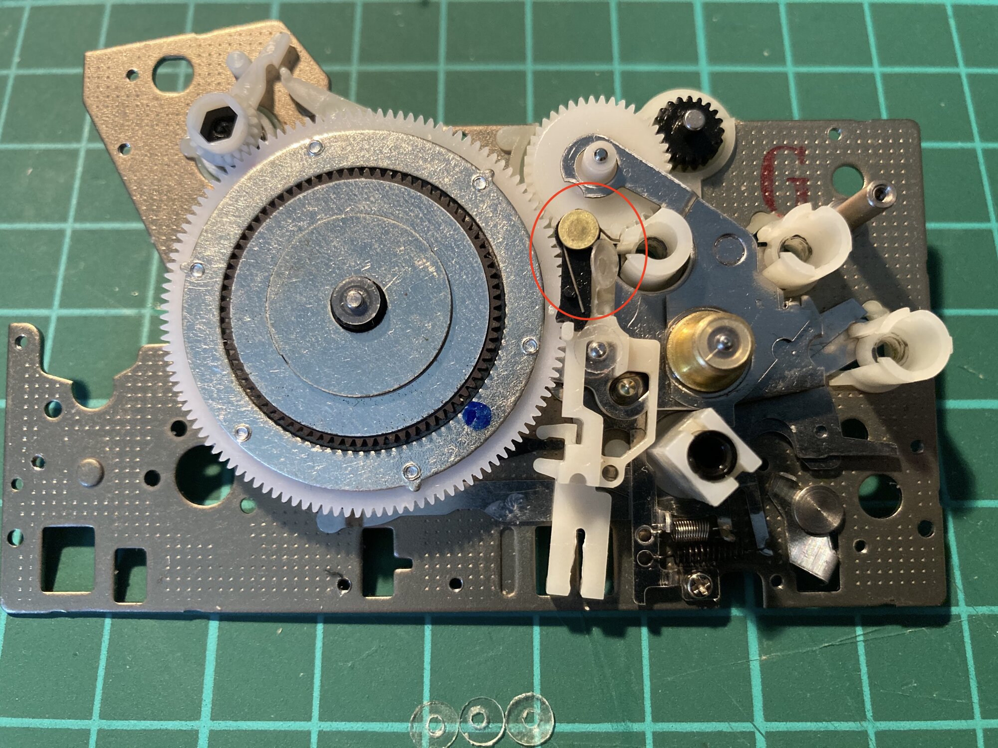

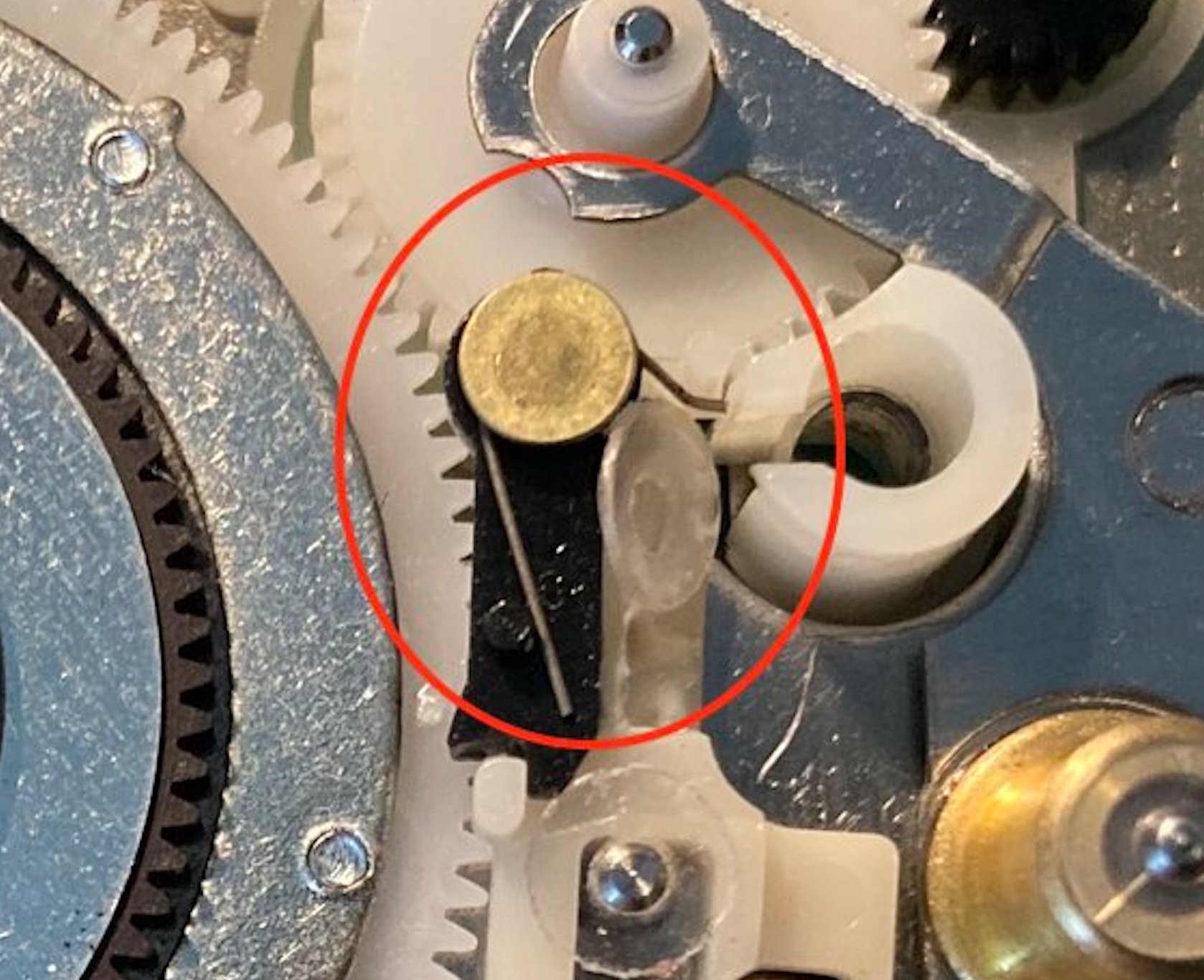

    What is this, a washer? also. the spring is not in the right place.

    Yeah, I would’ve removed that washer, it was just one I made that didn’t fit properly. Which spring do you mean?
  6. Valentin
    1,641
    It's the spring of the engaging lever. It seems it's catching in that post where the play button is supposed to go. I think one of the pins on which the spring hooks to may be broken. It's something mentioned in the tutorial of replacing the center gear and can be fixed.
