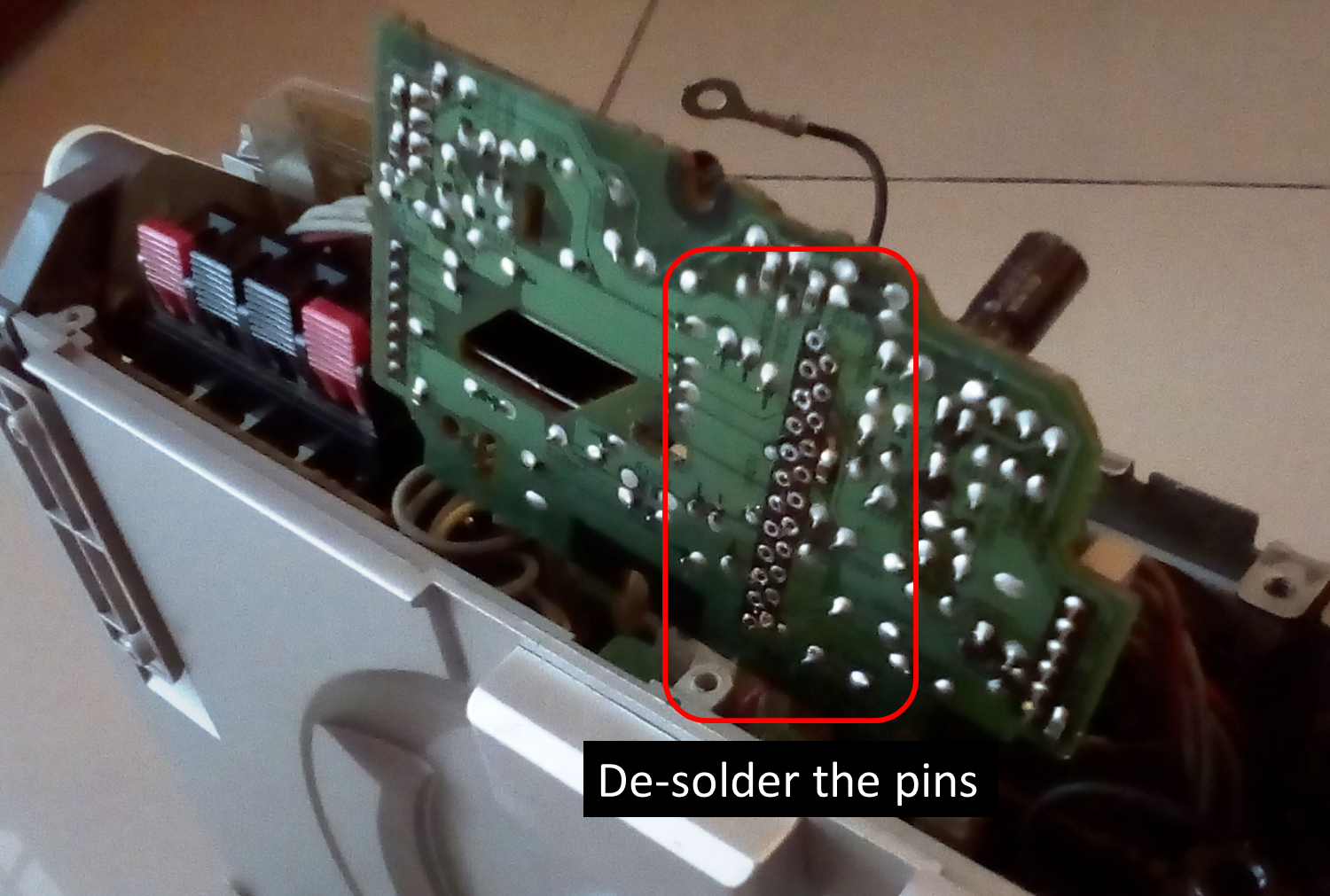

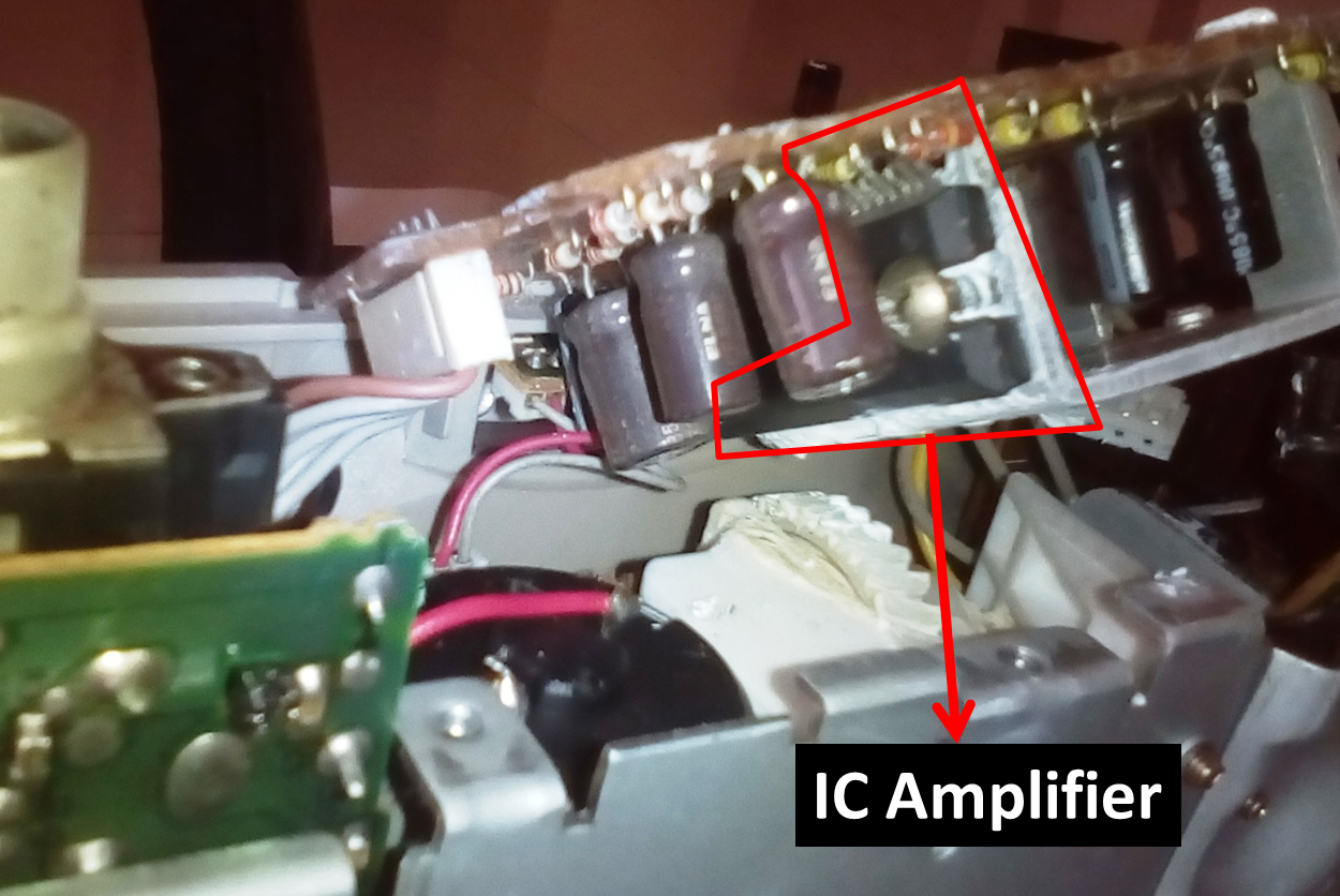

    I jammed my stereo with the recent purchased singles consecutively for hours. The beat from the extended remix was just too hype and it overheats the amplifier until it give way. Was searching around town and lucky to find the exact IC ( LA4905 ), but was told that it has been obsolete and the shopkeeper suggest me to purchase all the remaining stocks from him, well I'm still contemplating whether shall I do so.
  2. Ken80s
    Ken80s Well-Known Member
    384
    Malaysia

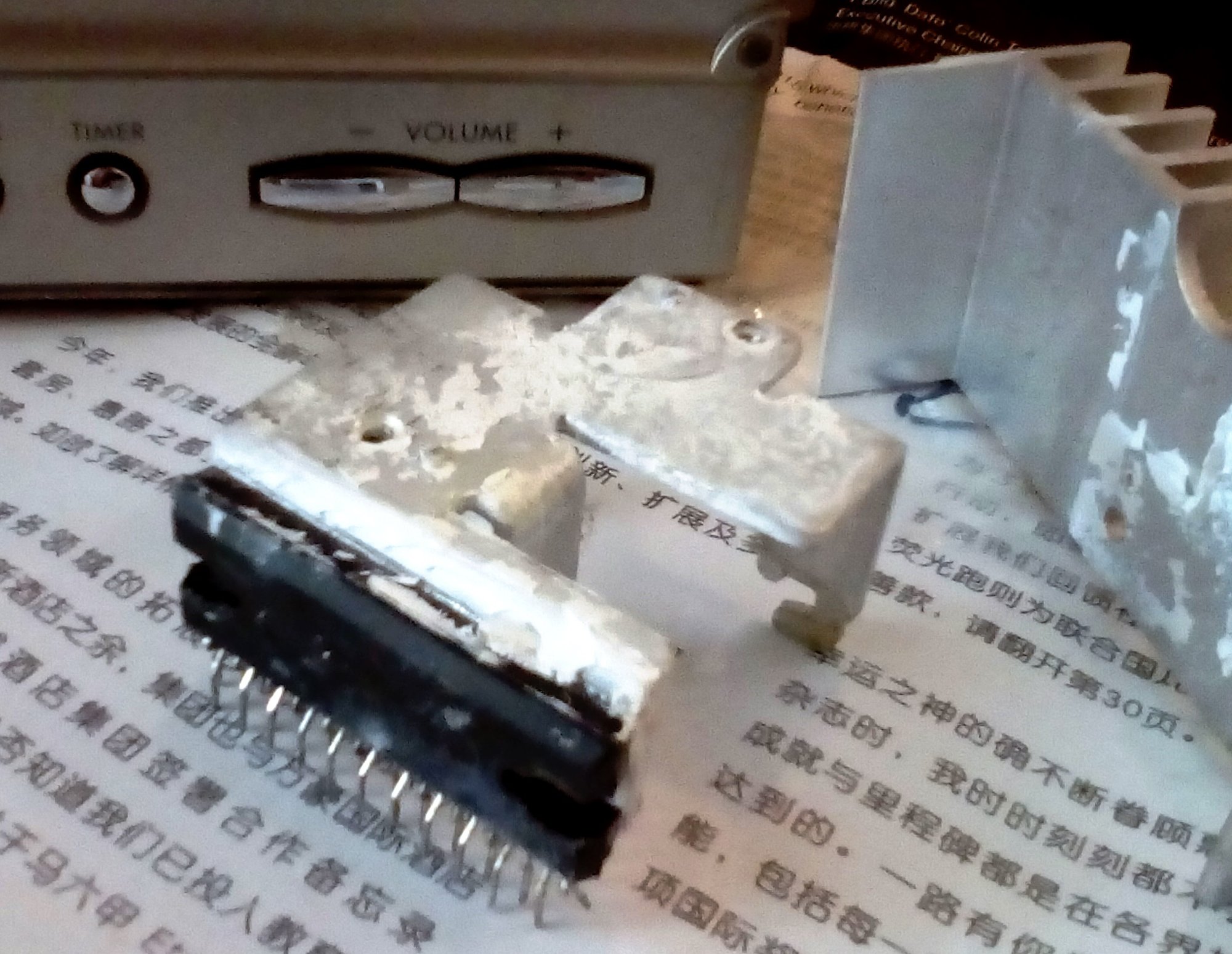

    This is the faulty IC Amplifier
    Ready to fix the new IC and not forgetting to apply new heatsink compound.
    Mission accomplished, my stereo fixed with a new amplifier IC and ready to go!

    Thanks for the perspective. I have plan to use a simple USB fan or laptop cooler
  9. Boodokhan
    2,476
    How did you find out what part to replace? or how did you figure out the problem was that IC?
  10. Longman
    3,911
    That sounds like a good idea. From experience in building power supplies you don't need a very big or powerful fan to reduce temperatures a lot. I have a Panasonic 5 CD stereo here which was designed with a temperature controlled fan in the back, as do my two DVD recorders.
  11. Ken80s
    384
    Malaysia
    In an amplifier, the component that susceptible to breakdown will be the amplifier IC either cause by output shorted or life span depending on the usage. For me I used to set to volume at about 60% for my listening. The higher the volume the higher the current will consume by the IC when heat is the next issue.
