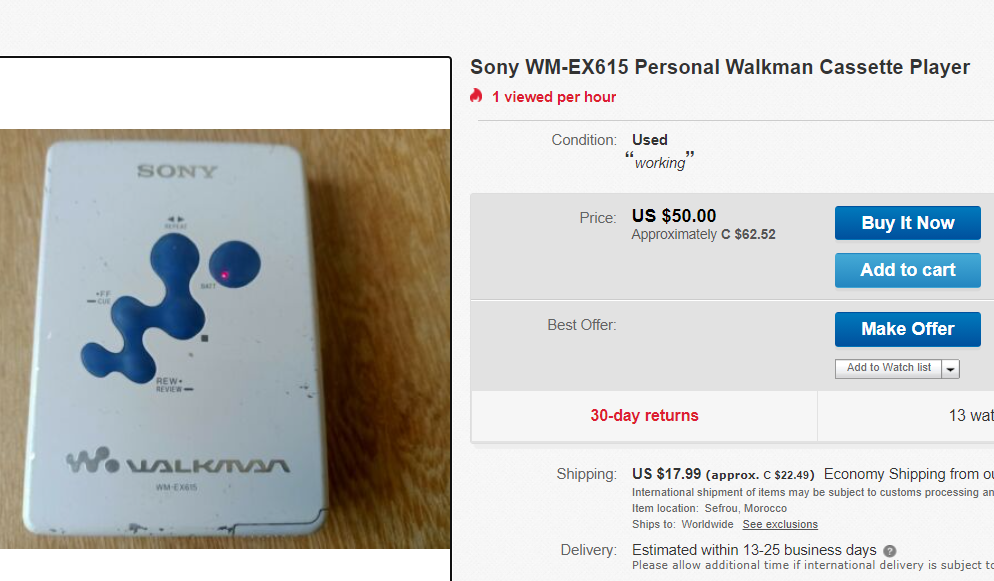

    Many thanks Boodokhan, I saw a EX615 today in a shop, the seller sent me a pic (very old school!), I am going to look at it next week. I have got a 41 branch charity shop chain looking for ‘walkmans’ for me, which they say they get weeks. Will post on here if this turns up anything, and then get it repaired.
    Will I be able to listen to a tape on the EX615 with a standard set of headphones that just have the 3.5mm jack? So not the remote connector? The EX615 look cool don’t they, especially in white! Slightly worried if no remote. Looks like headphones will plug in, but not sure if you need remote to switch on Dolby.
    Thanks again!

  16. Boodokhan
    yes, You can use regular headphone jack
    Red circle mark is for regular headphone jack and the rectangle one is when you use its original remote to play, stop ....
    This walkman comes in white color only with 2 different color on buttons and Sony logo (Blue and Green). Personally I think this is best looking Sony EX series walkman.
