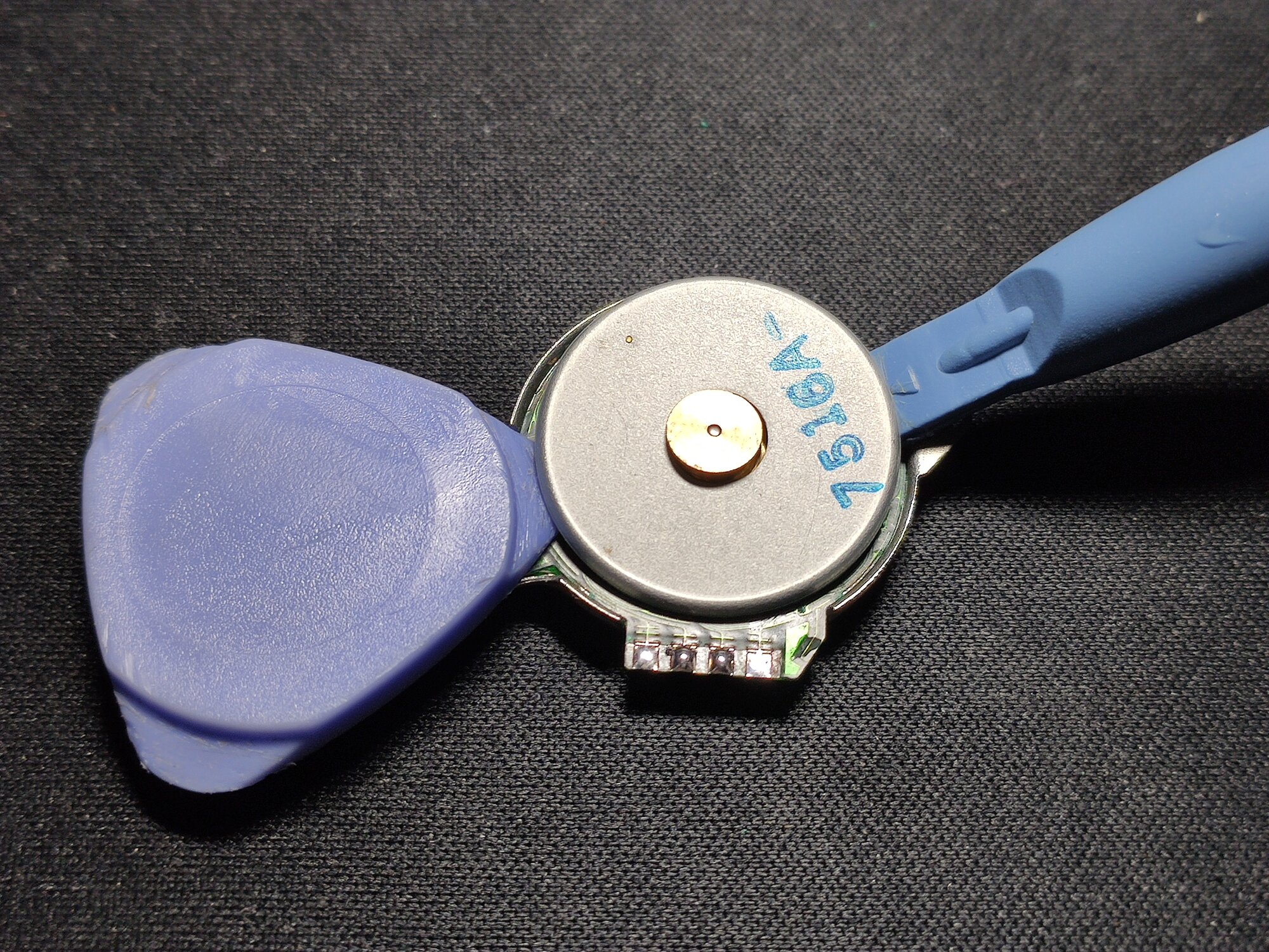

    2. Using 2 plastic spudgers, remove the top magnetic disc. Pay attention to line up the hole of the disc with pulley, otherwise it will get stuck in the pulley.
    It's VERY important to pull just the top disc, without the bottom one together with it. To obtain this keep one finger on top of pulley while pulling the disc.

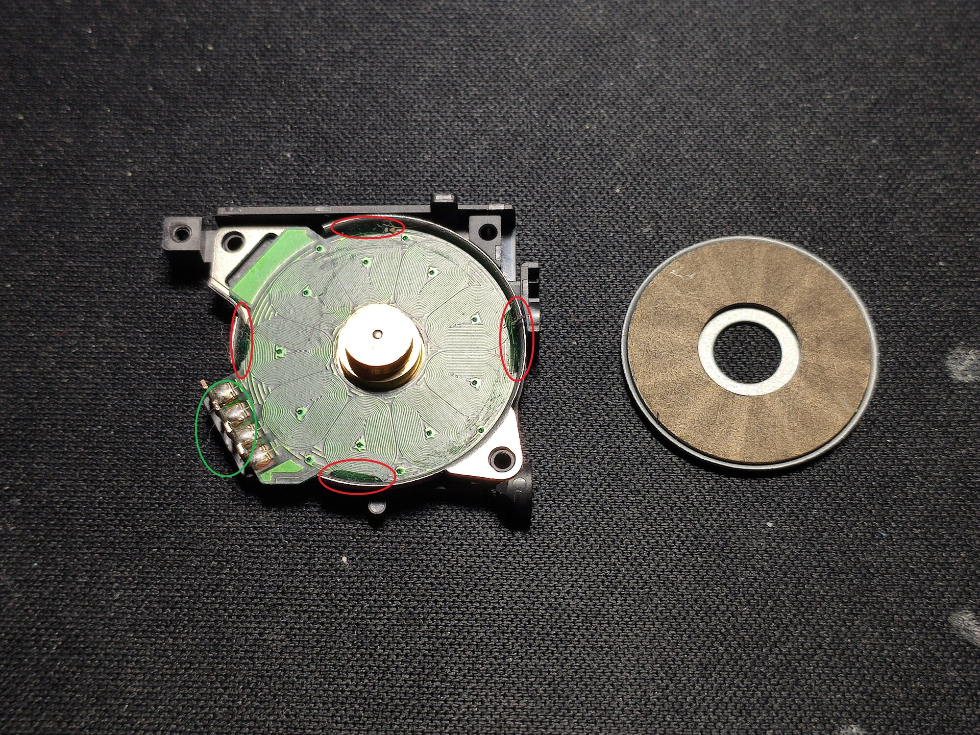

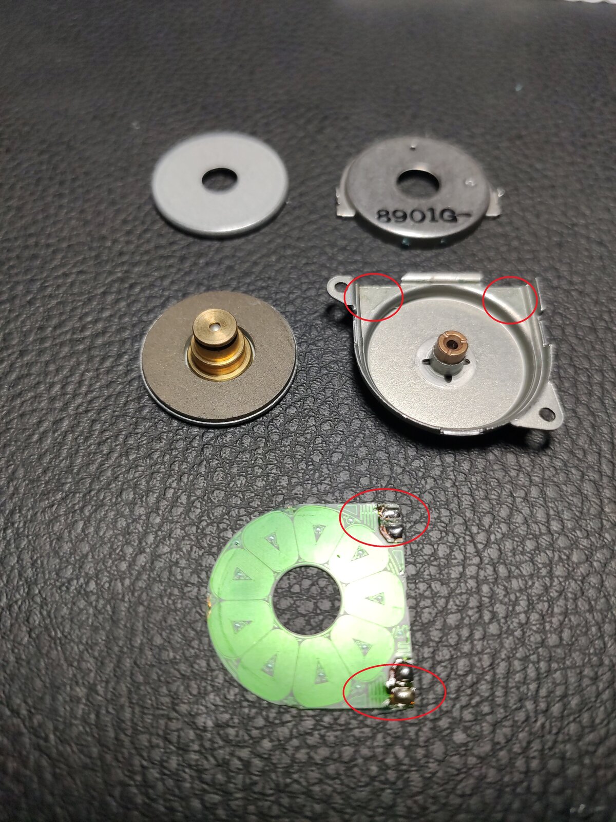

    3. Using a sharp tool remove the glue that attaches the coils PCB to the outer cage (marked red). Pay very careful attention, as there are very thin traces close to the edge.
    4. Desolder the outer plastic part with pins from the PCB (marked green).
    5. Remove the PCB.
    6. Remove the rotor.

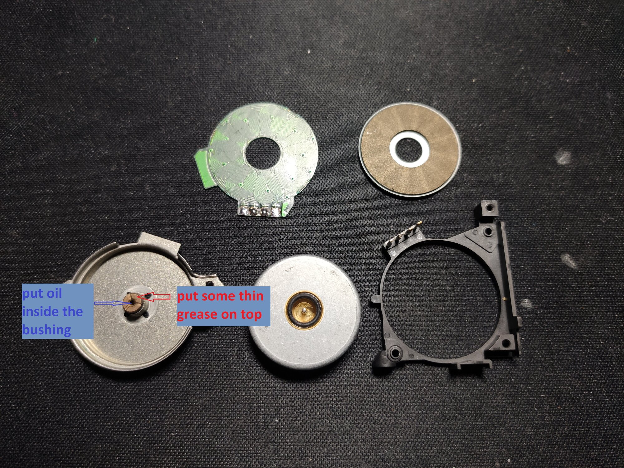

    7. Clean the shaft of the rotor and the inside of the bushing with a cotton swab immersed in IPA.
    8. Put oil inside the bushing. I recommend using watch oil. Make sure it gets to the other side, on the pastic plate.
    9. Put grease on top of the bushing, where it makes contact with the rotor. I recommend using a very thin grease, like SW-92SA or similar. You can put oil if you don't have thin grease.

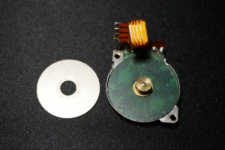

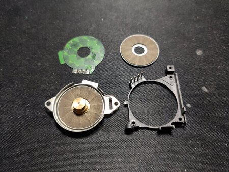

  2. Valentin
    1,696
    Want to add some clarifications, especially in regard to points 3 and 5, as these are the most diffcult from the entire process.
    3. When removing the glue, you need to be very careful to not damage the coil traces. A sharp metal tool is needed, like the tip of a pair of tweezers of a very sharp blade.
    However don't freak out if some small chunk of the PCB breaks off, that can happen but traces will remain intact.
    Heating the chassis with a soldering iron will also help in softening the adhesive.
    5. After the visible glue has been removed, the PCB will not come off without force as there is still glue underneath in the areas shown in attached picture.
    What I have found to be very useful is heat the chassis of the motor right below those areas with a soldering iron and then very gently pry off the PCB starting from those 2 areas.
    In some models, the glue in this area is very stuck and not heating the chassis beforehand will break the PCB.
    Even if you have broken the PCB, the traces are usually still intact. So take your time and remove the remaining part carefully and you will be able to put the motor back together.

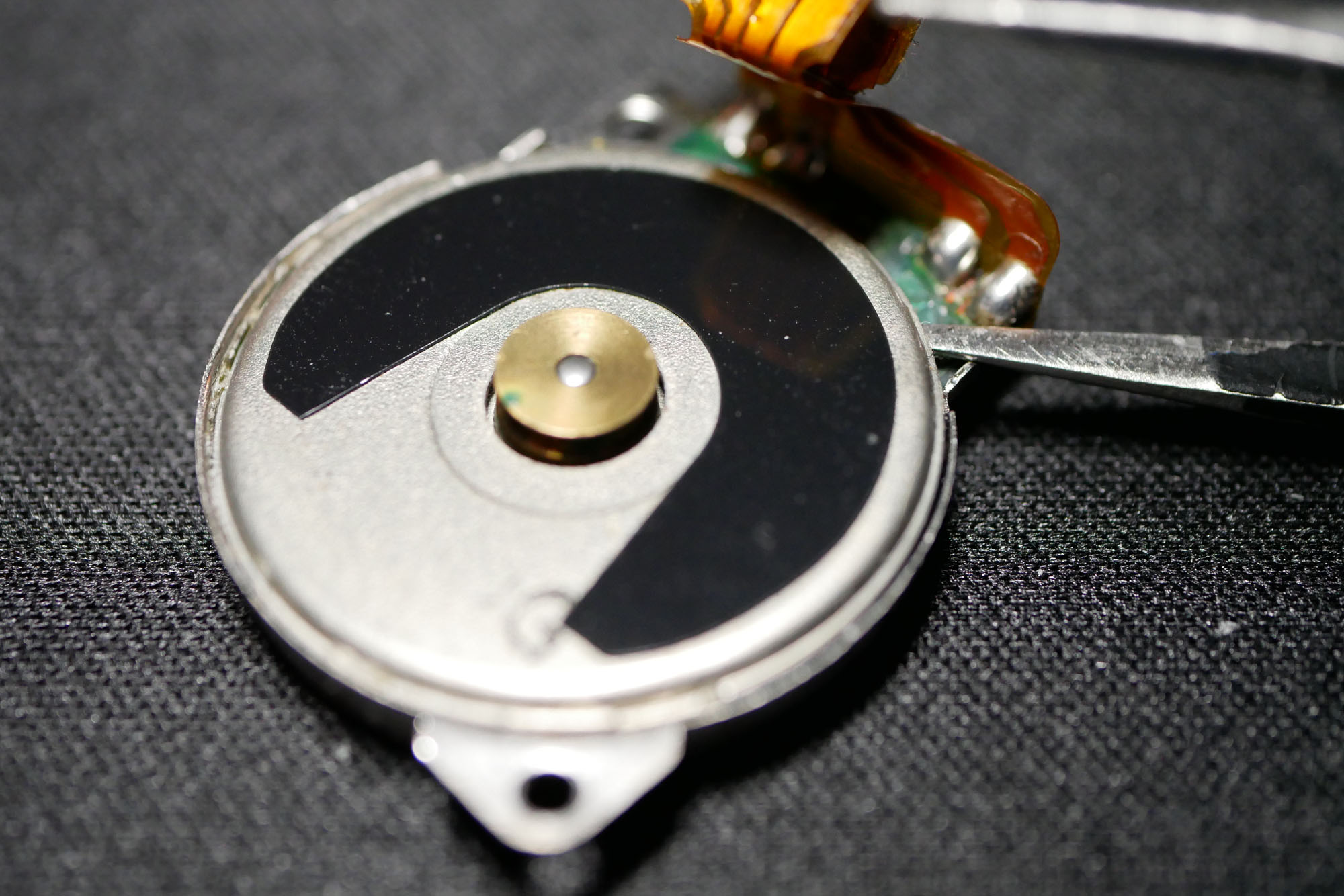

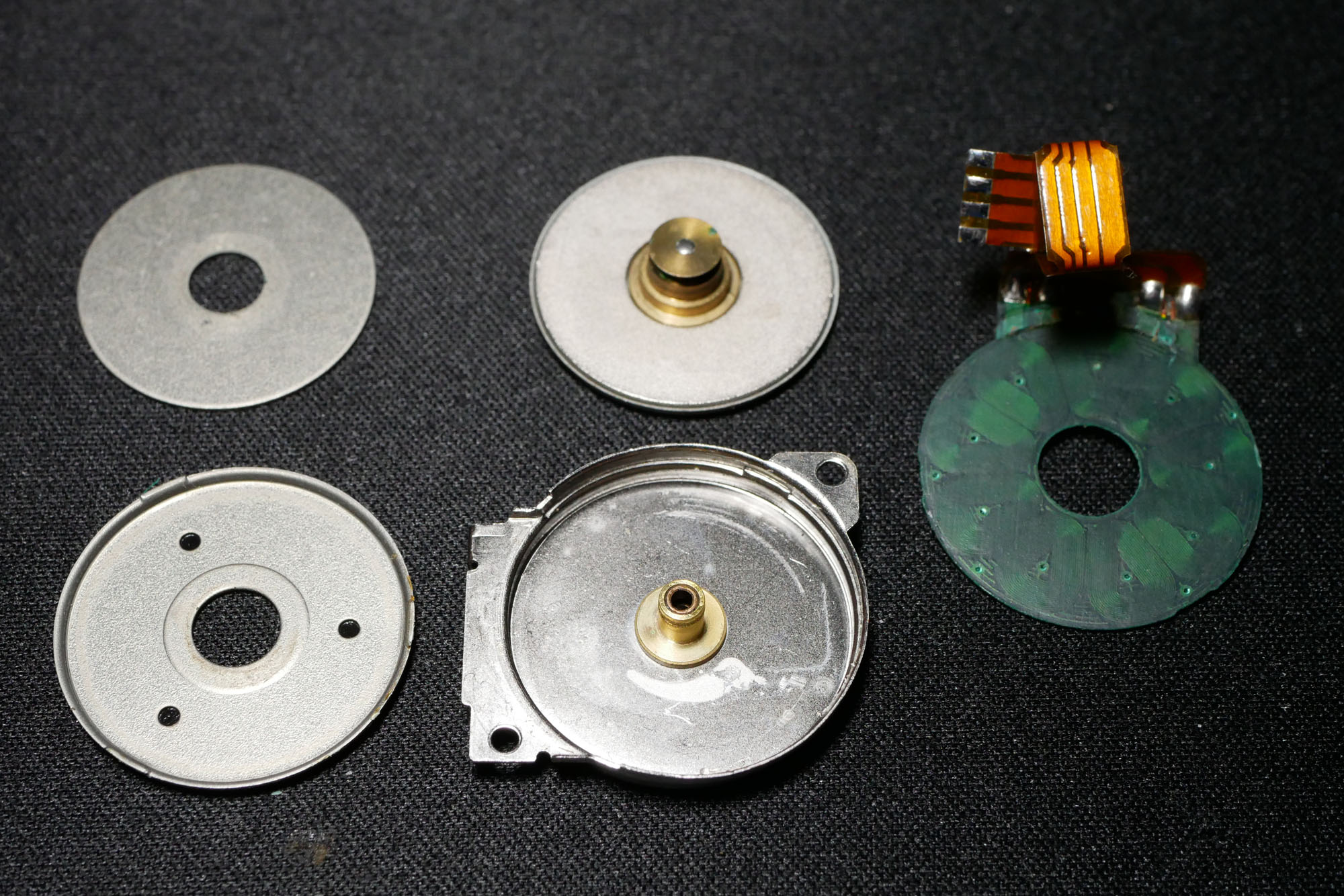

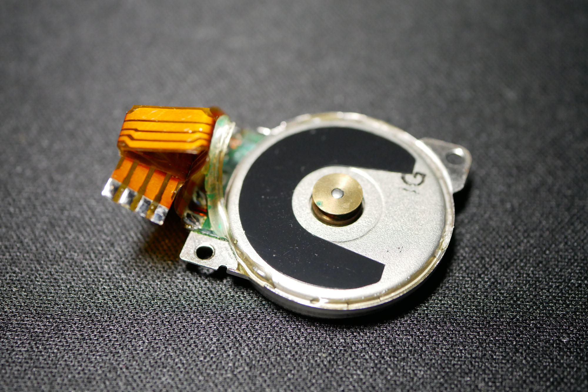

  3. Valentin
    1,696

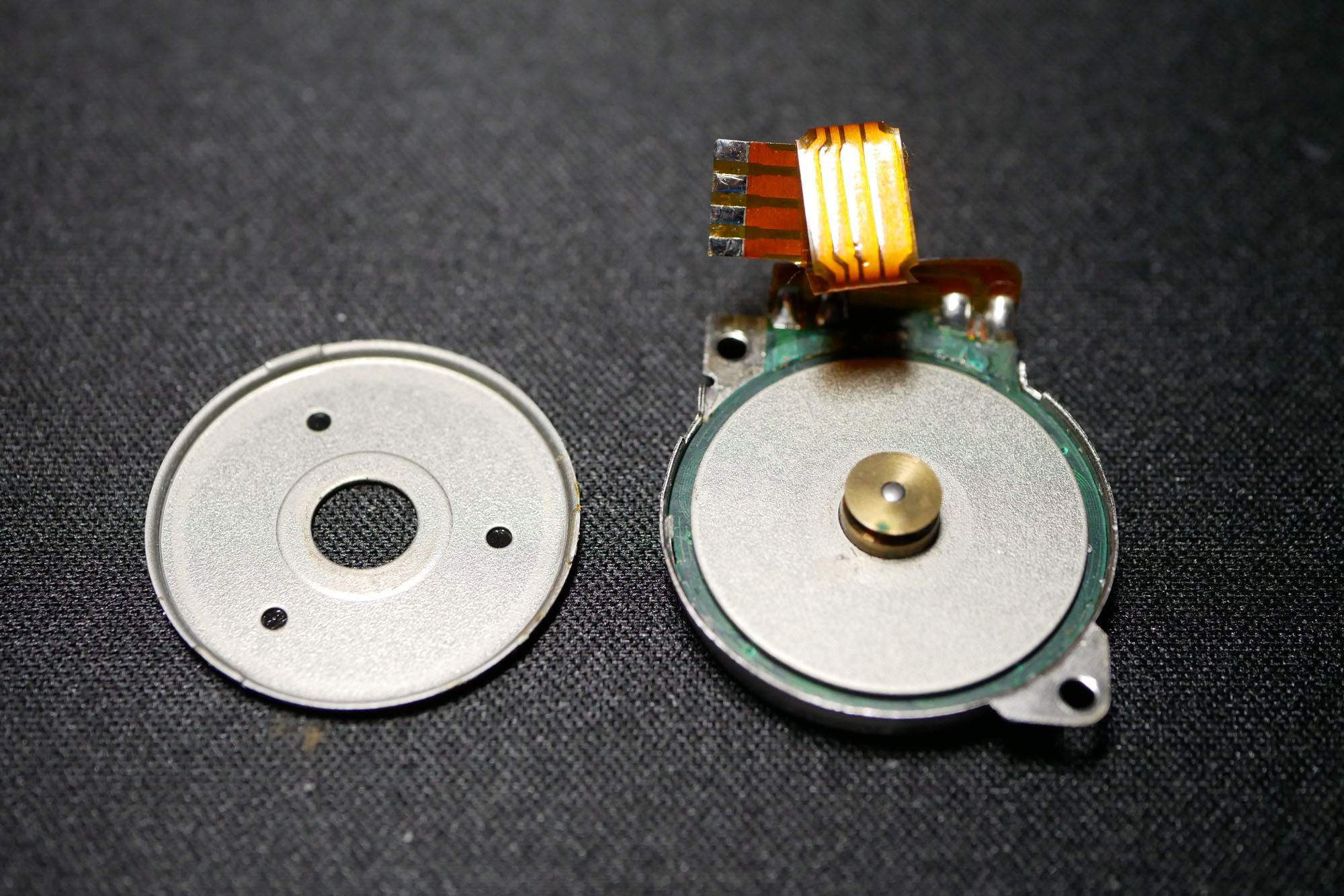

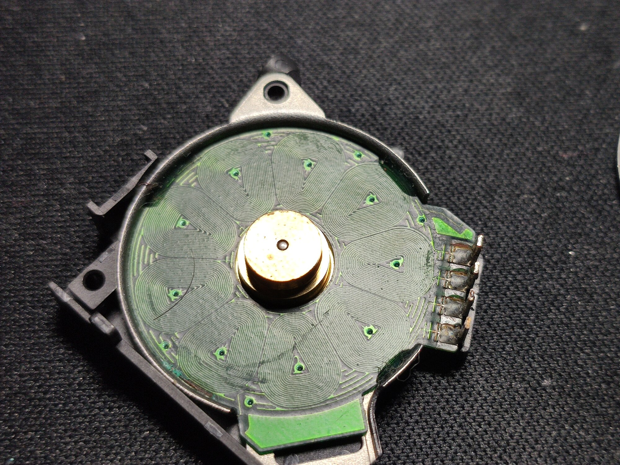

    Here are some images with motor used on WM-EX60/EX70/EX66/EX77/EX88/FX707.
    Motor is very similar to the ones depicted above, only differences being the case and fact rotor has only 1 magnet not 2.
    Unlike one shown in first post, the PCB is not glued on the case on this one, hence easier to disassemble.
    For easier removal of glue, heat the case with a soldering iron.

  6. lavryev
    lavryev New Member
    2
    Kazakhstan
    First of all thank you very much for this manual you published in the Net, it help me a lot because the motor issue was the last point in my trying to reanimize my WM-GX654 to the normal working condition.
    I'd like to share one trick for PCB safe remove. The most part of glue drops which fix PCB in the metal body frame I roughly remove by soldering iron with cone tip. Further I use Gilette-type razod blade by placing it between PCB face end and motor metal body and cut-off the preheated glue via carefully moving the razor blade along the glued PCB end face area. Here it is simply necessary to control the movement of the blade at the same constant depth and not allow it to jump out onto the front side of the printed circuit board.
