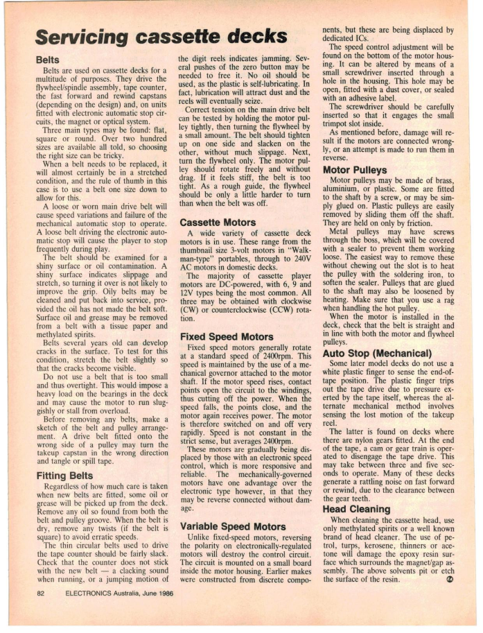

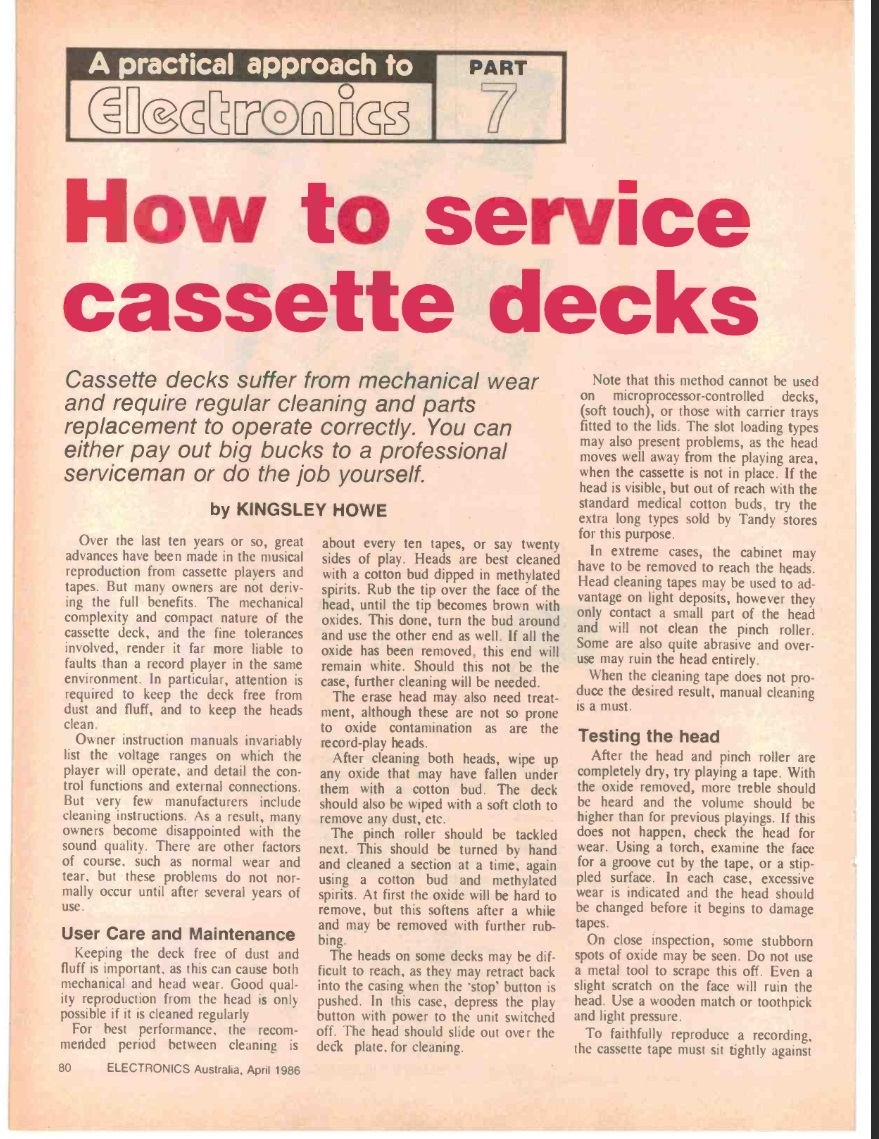

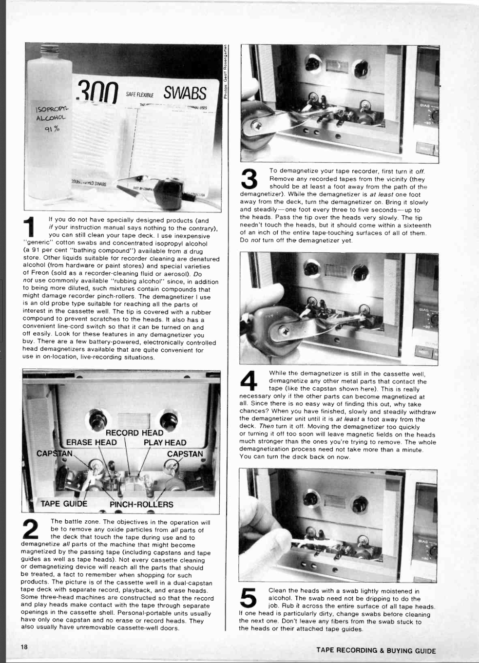

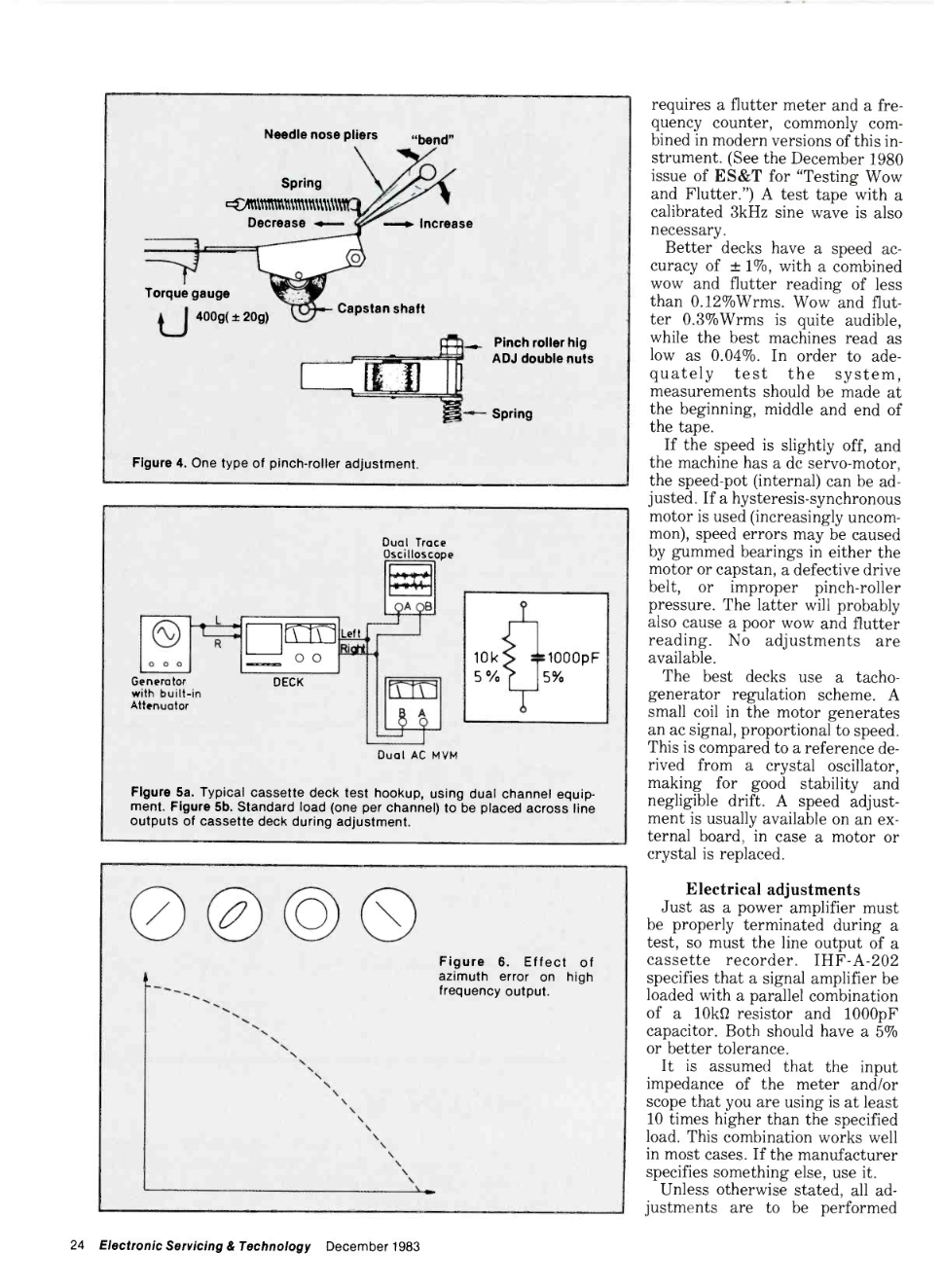

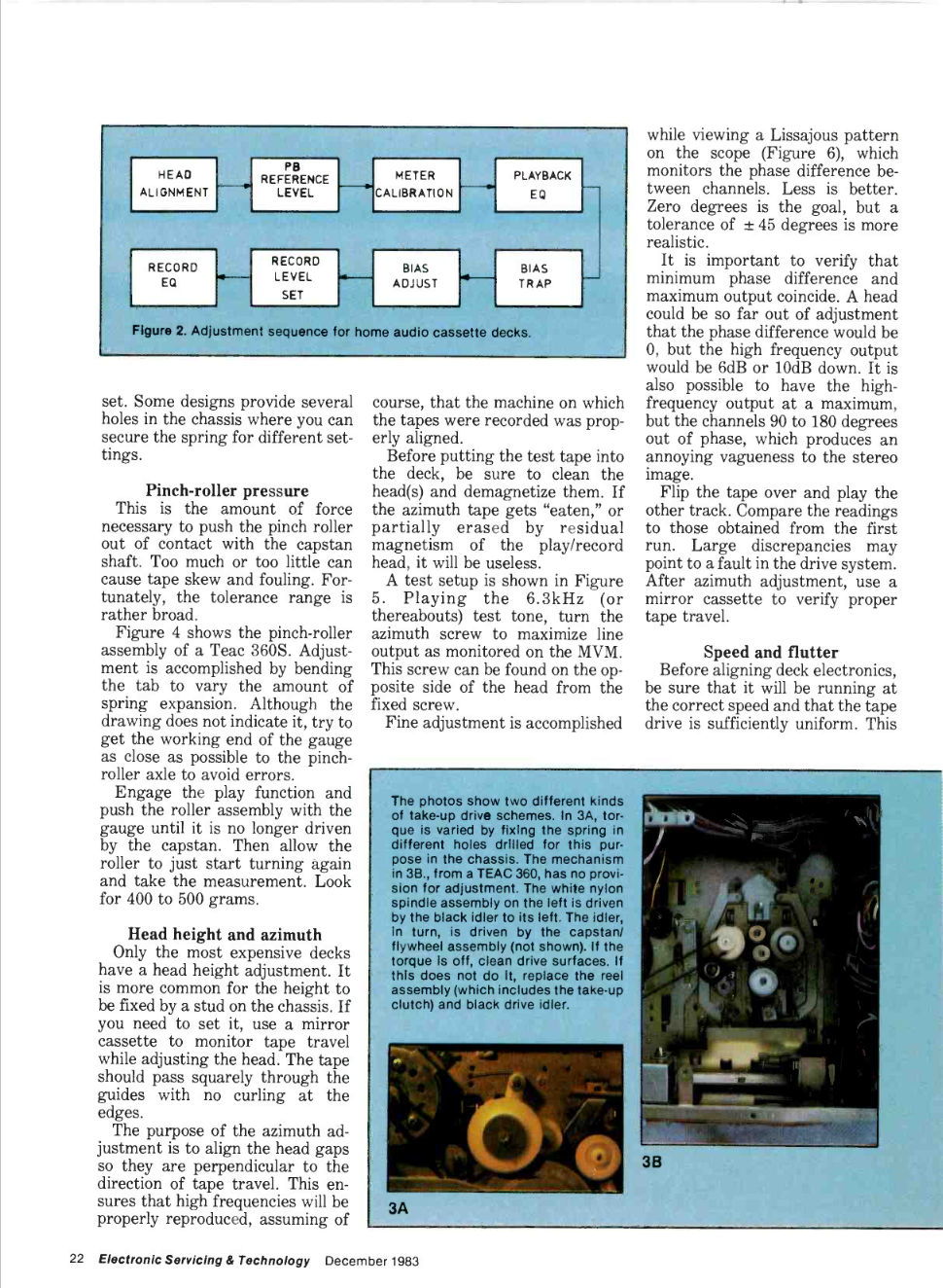

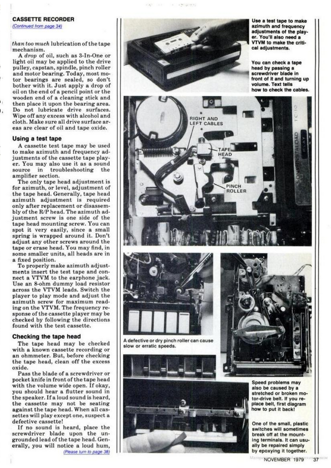

    Great tool, thanks for the share! Just a question though - is the pinch roller issue (mentioned to cause dimples at regular intervals in tape) common in Walkmans? I have serviced all my units as best as I can, and my Technics deck seems fine too, but how would one go about checking for a regular pinch roller before encountering this problem? Would you just move it manually - as this guide says - and inspect for any irregularities?
    Hey stereomecha99, I didn't see you replied to this thread, my experience with the rollers is more from reel to reel where "tape shred" is much more common or even VHS machines. Little tiny pieces of tape stick to everything, some of the pieces are very small. I had a job as a tech measuring how dirty the transport was and then we'd clean it with our cleaning tapes.
    I have several R2R machines and there's always a chance the tape has turned to goo and it sticks on everything, cassette tape seems to be a huge improvement but it can still leave small pieces in the player. Get out a microscope or even feel with your fingers if there's room. The goo can be like tar and difficult to get off and it can ruin your day.

    In my (admittedly very limited) experience reviving Walkmans, they (Walkmans)have a nasty way of being left in Play Mode when Dead. Esp auto-reverse models. With a pinchroller being pressed onto capstan for 30+ years it gets a dent! You see the dent, and if it is there you must get a new pinchroller:(
    I wonder if that dent can stretch tape, maybe on a hot day?

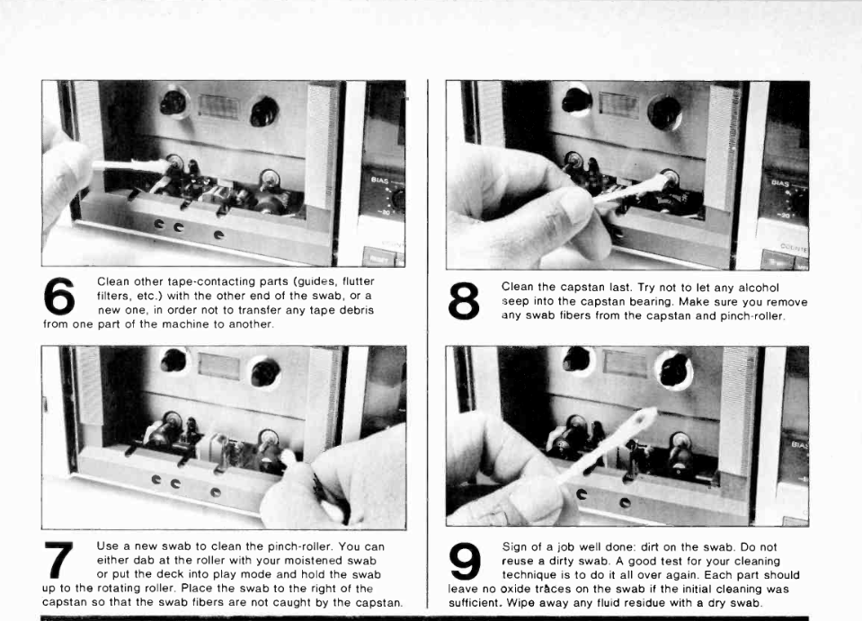

    Some more basic information with some great phots on cleaning the tape deck. From HiFi Stereo Review 1984 Tape Recording Issue.

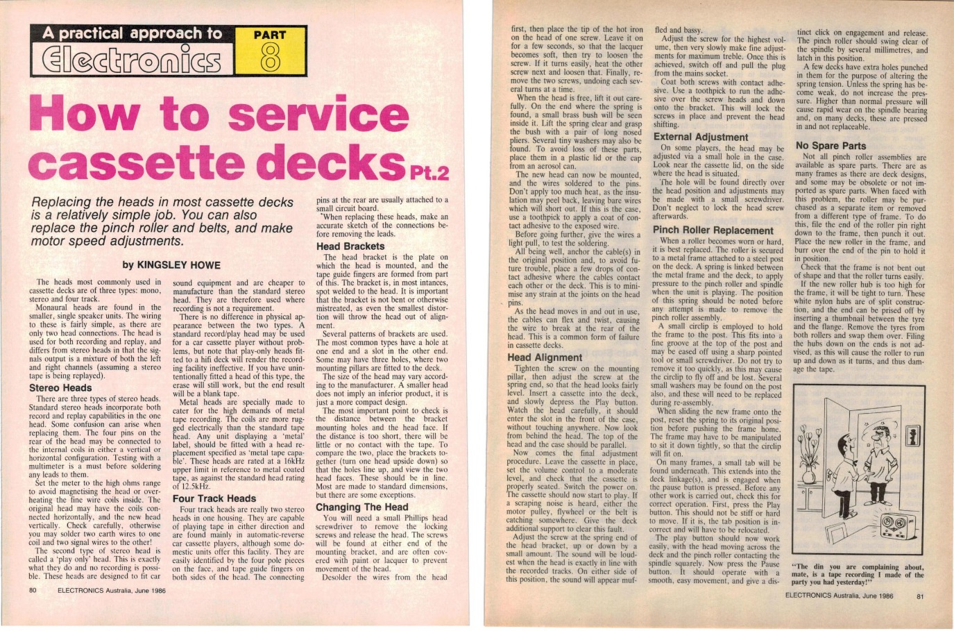

    How to service cassette decks part 2
    Trying to find this to add more....

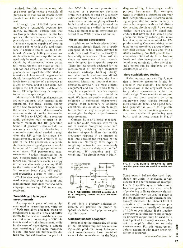

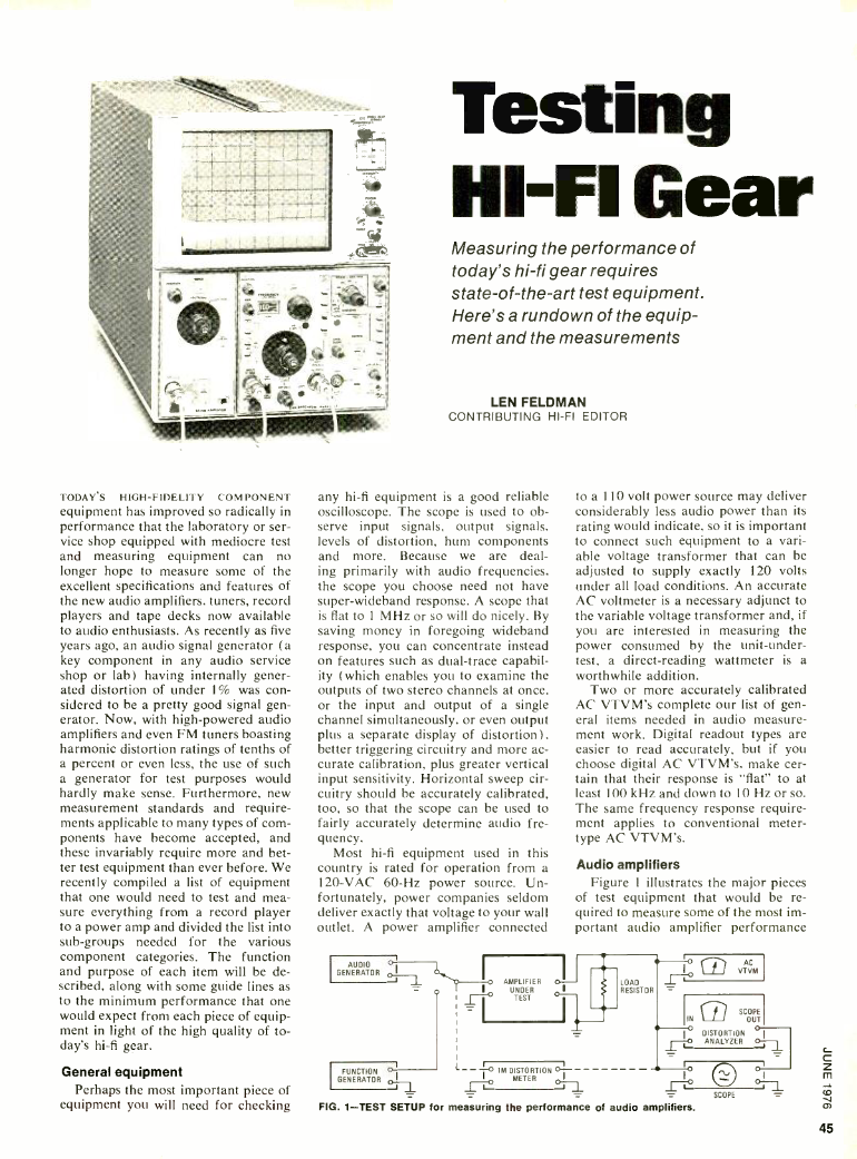

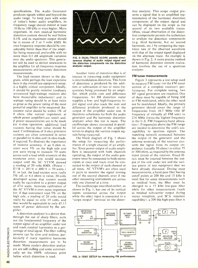

    Radio Electronics 1976, Len Feldman was a staple at the HiFi Magazines around here.
