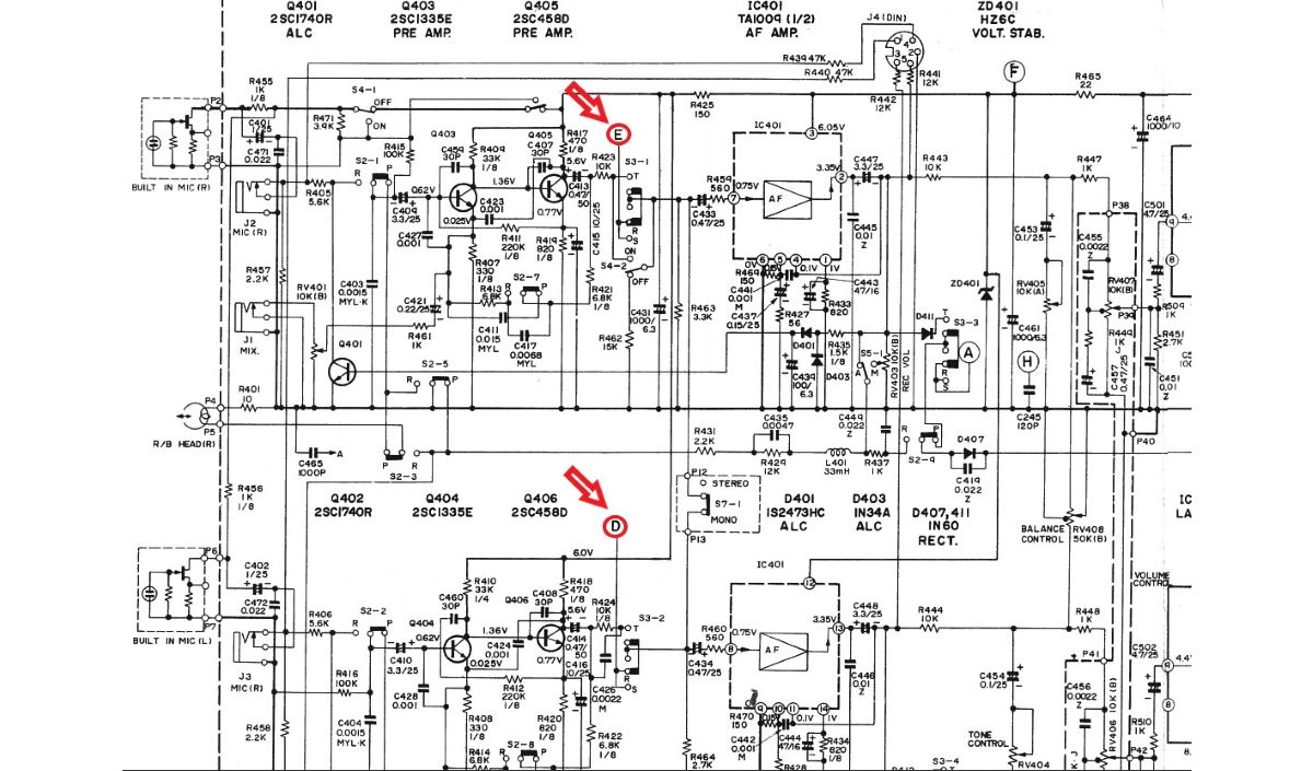

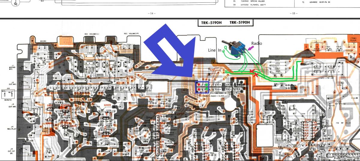

HI I'll try to help you as much as I can I downloaded the diagram of the trk and the radio input and marked these red points...they enter on S3-1 and S3-2 on the motherboard this double switch is marked by the blue arrow The two red dots represent the cassette's audio input The two green dots and the radio's audio input following the diagram, the modification that can be made to have a line input and mount a double toggle switch on the rear panel or where more convenient cut the two tracks ... and solder as shown
