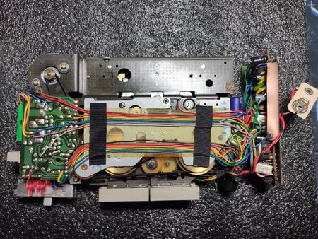

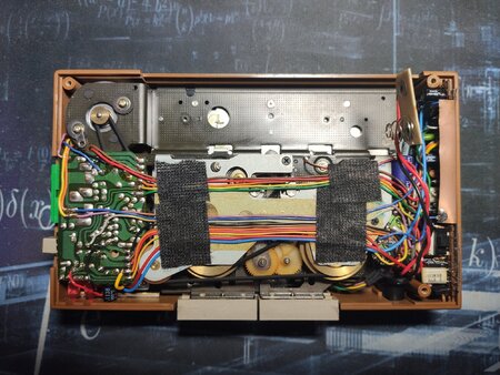

    1. Take the battery cover out and proceed by taking out the 6 screws that hold the back cover on. After that, carefully remove the battery terminals from the back cover and remove it completely.
    2. This will be the most time consuming part, as you need to note which wire goes where, as most of them will need to be desoldered to recap the main board.
    When I repaired the walkman, I did a hand drawing of the board noting each wire's color and where it needs to be soldered. You need to keep in mind that there may be more wires of the same color (I found this to be the case), in which case you need to note additional information, such as where it goes on the other end or if the wire if thin or thick. I also took pictures as a backup. Also do not take my pictures as a reference, as it may vary from a unit to another.
    This step is absolutely critical, as you will not find a schematic for this device.
    3. Take out the board bewlow the motor toghether with the flex cable and the thin board that attaches to the mechanism. At this point, if you have all the wires desoldered, you can also take the main PCB out.
    4. Take the cassette lid cover off (it has 2 black screws)
    5. Take the last screw (silver) on the bottom right of the mechanism out. After this, the mechanism is only held in place by 2 plastic nipples on the back. You need to bend the plastic 1-2mm to take the mechanism completely out of the case.

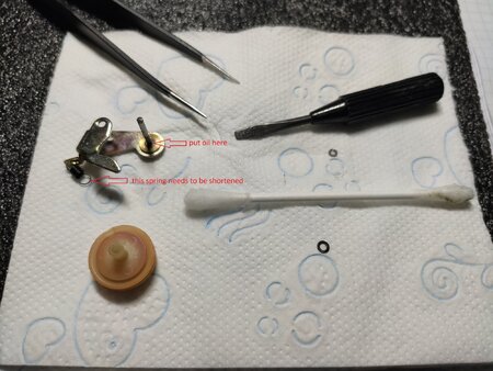

    10. Shorten the clutch assy spring by cutting 1-2 coils. The clutch spindle must be lubricated with oil and the belt groove cleaned. Also clean the flywheel bushings and lubricate them. At this point you will need to reinstall the small belt.
    The spring will need to be shortened even if you replace the rubber tires, as in its original length it applies almost no pressure at all on the rubber ring.
    I do not have its dimensions, as I have used one from a pack of many belts (flatnees of this belt is not critical, unlike the large capstan belt).
    The belt needs to be a little loose, as it will tighten when PLAY is engaged and cluch assy moves in place. If the belt is too tight, it will act like a spring, counteracting the force of the clutch assy spring, lowering the takeup torque to the point that it will chew up your tapes.
    11. Clean the flywheel, idler and motor pulleys grooves and install a new capstan belt (I used an 88 x 1.2mm in mine, which is on the tight side, so I suppose that any belt between 88 and let's say 92mm will do the job). After this, you can oil the motor upper bushing and put the back and front plates back in place.

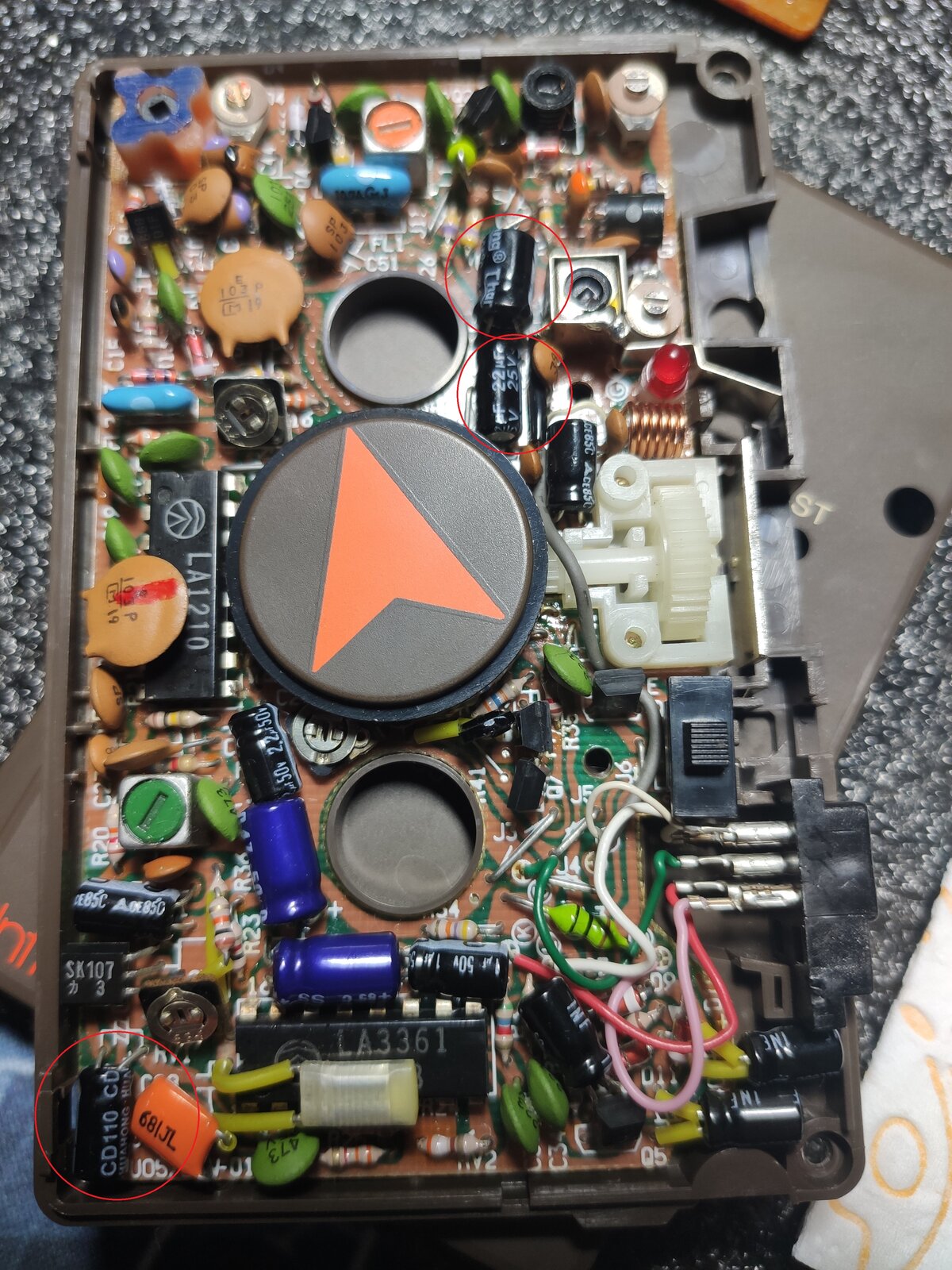

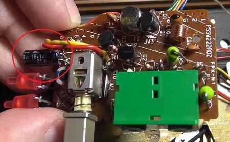

    12. The next thing to do is clean the volume pot with contact cleaner and recap the power amp board. Note that it is likely to find corroded traces, that will need repair. After this step, you can proceed to put the power amp board and volume pot back in the case, followed by the mechanism and cassette lid.
    13. The next time consuming part is recapping the main board. Here, it is also likely that you will also find corroded traces. Also, after taking old capacitors out, clean the board well with cotton swab and IPA. I recommend replacing one at a time (or all that are the same value), to keep track of which one goes where. It is also possible that the Dolby adjustment trimmer has some corrosion on it. If so, spray some contact cleaner on it and wipe the green residue with a cotton swab (let it sit for a couple fo minutes for the corrosion to dissolve). You may need to repeat the process a few times to get it clean.

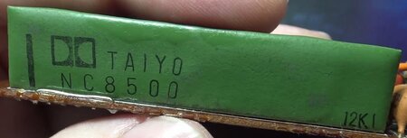

    16. Dolby adjustment: Given that a service manual or schematic for this unit cannot be found; I could not find any info on the Dolby hybrid IC (NC 8500) either, so decided to go on an alternative route, as playing a Dolby tape sounded noticeably muffled. Given the fact that there is only one trimmer pot, I suppose that what it does is not adjusting the Dolby level, as in other walkmans I have repaired, but the reference voltage. I will describe the procedure that I came up with, mentioning that it is how I did it and not necessarily the best way to do it.
    - I grabbed an azimuth adjusment tape (6.3Khz -10dB). Used this because it's something that is easily available.
    - I made measurements playing this cassette on a calibrated deck with Dolby OFF and with Dolby ON, noting the ratio between the two.
    - I adjusted the trimmer pot to obtain the same ratio as in the reference unit. Rotating clockwise decreases the ratio, rotating counterclockwise increases it.
    After I made this adjustment, playing a Dolby encoded tape sounds completely neutral, as it should.

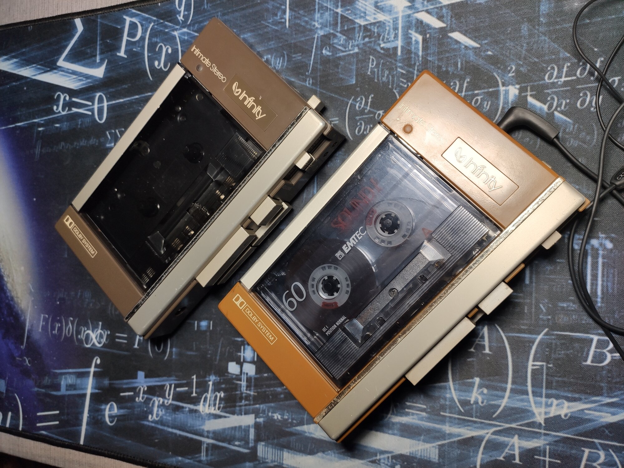

    Nice, you have to love the internal wiring, they did such a nice job on it. I had no idea there were two shades of brown on this model.
  3. Valentin
    1,664
    I had no idea either, the seller sent me a different unit than the one in the pictures, but in the end I was happier with having 2 different ones.
    From what I have seen internally, the dark brown seems to be a newer version, since it uses a flex cable instead of just wires connecting the 2 boards on top of the mechanism.
    It is to be noted, for people who want to have one, that there are units available on ebay from time to time. The best part is they are usually sold at insanely low prices, given how rare they are.
    I paid about 50$ for the dark brown one and about 30$ for the light brown. The first was being sold either as functional or as not tested, I don't remember which (of course none of them was functional in reality).

    I was confused, I thought you had done some work on one, now I see that they have two different layouts, interesting. It doesn't look like they simplified anything with the ribbon cable.
  6. Valentin
    1,664

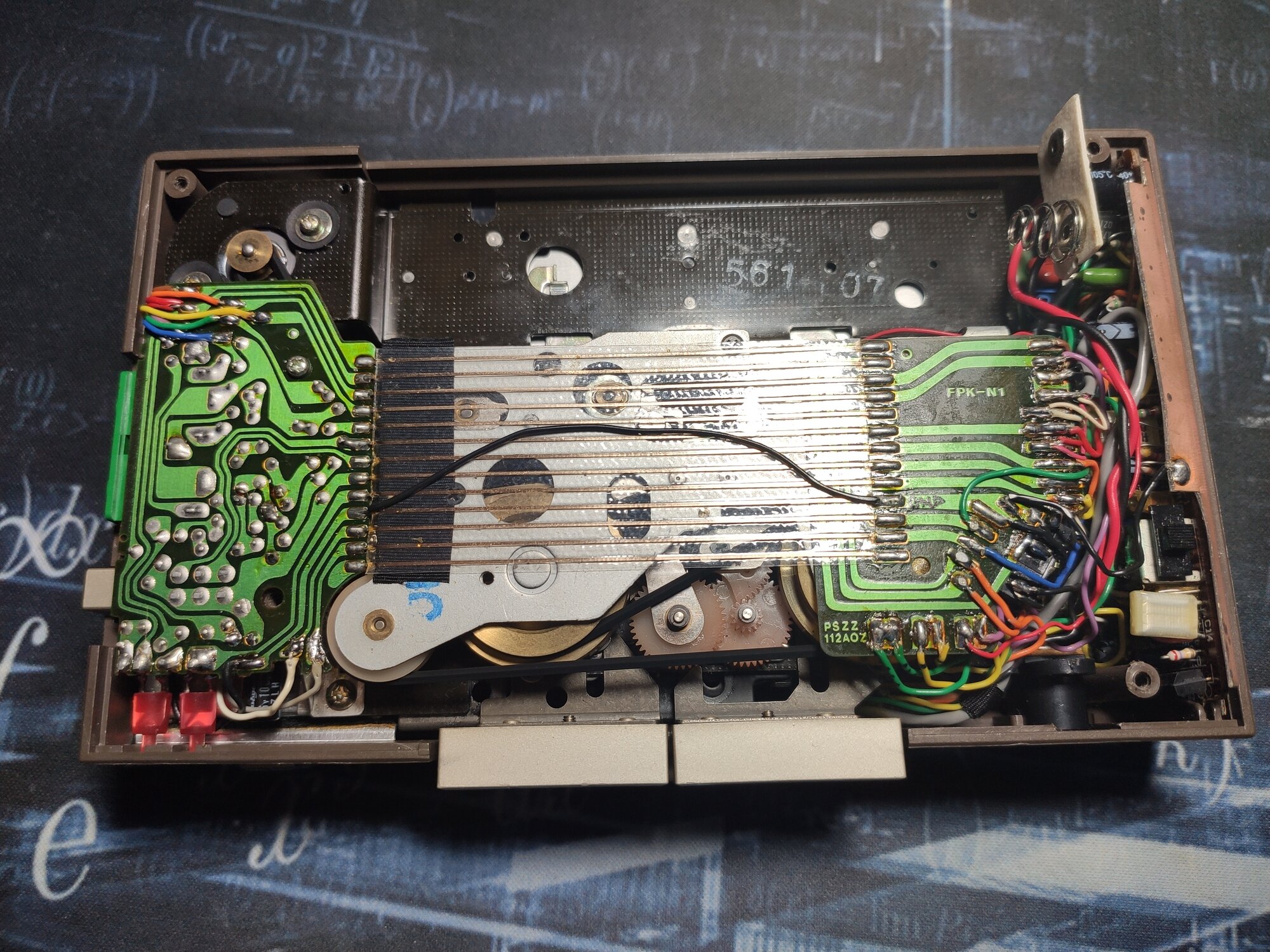

    @Mister X I did the restoration process on both, actually. I think I forgot to mention that. None of them worked initially, the main belt was too stretched to drive the capstan and all the capacitors leaked. Given what I found when taking the back cover off, I did not even try to power them on, but just proceeded with further disassembly.
    Initially wanted to put pictures with just one of them so it's not confusing, but decided to put both since many people probably don't know 2 variants existed.

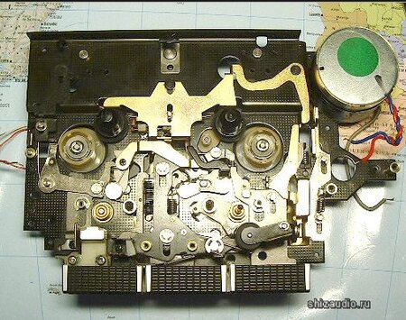

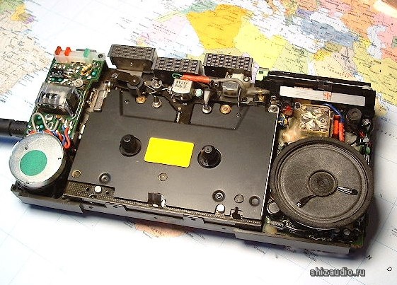

    Something else interesting I rememebered having are 2 pictures with the Panasonic RX-2700 mechanism (found last year on shizaudio.ru), which is an almost identical (except for the buttons) AKAI-type mechanism. So most likely this mechanism was used on other walkmans and mini-boombox type devices (I doubt it's made by Panasonic).
