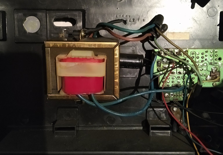

  11. carlos2000
    carlos2000 Member
    34
    Germany
    I need urgent help.
    I unscrewed the 975 today. Since I saw that these two black cables are not connected (see picture 1 and 2). Do the two cables have to be connected or do they go somewhere else? What are these cables for? Can the device be switched on without the cables being connected when I have installed the transformer?
    On picture 3 you can see a black cable going away from the transformer board. Where is the plug where it has to be inserted?
  12. carlos2000
    carlos2000 Member
    34
    Germany
    The some for the red cable. I don#t know where are the plugs for the 2 cables.
  13. NorthBayEd
    NorthBayEd New Member
    4
    1
    North Bay
