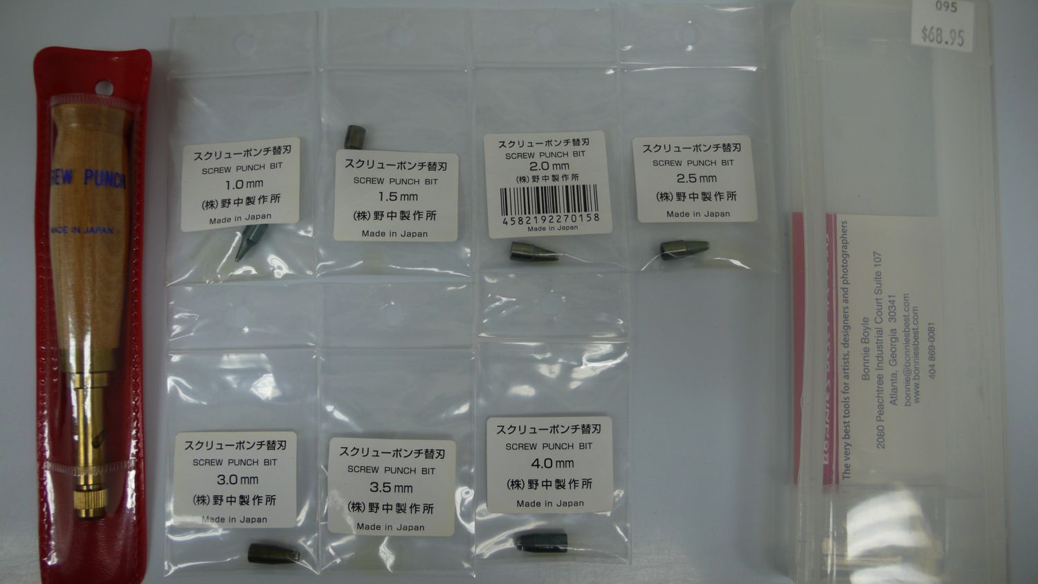

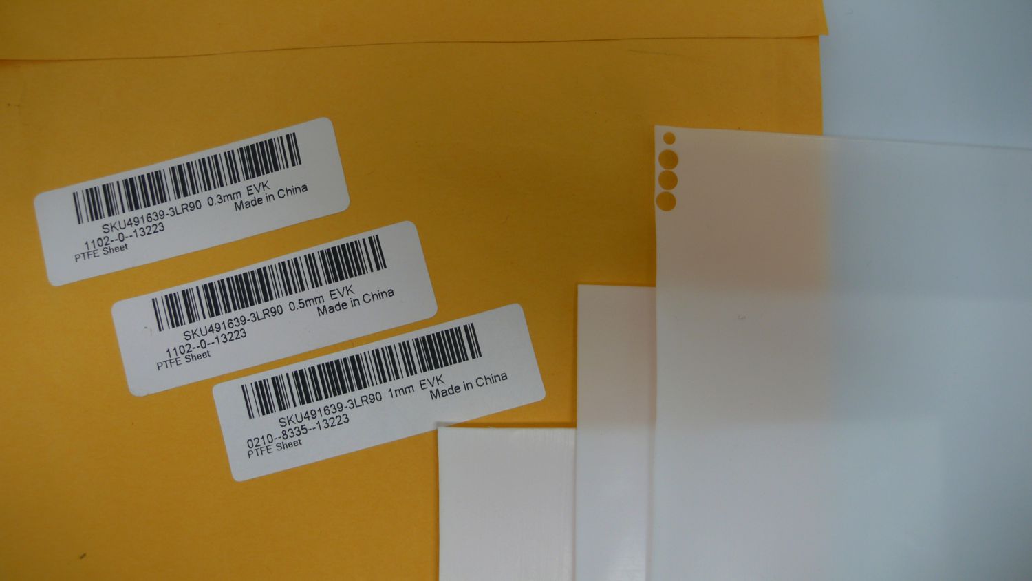

    DIY is the easiest, I use 0.3mm teflon sheet and Japanese hole punch set to make these tiny buggers.
    You can use (celluloid?) backings left from iPhone/i-whatever screen protectors, and Chinese copy of my $68.95 punch is now available for under $5 here: Hole Punch
