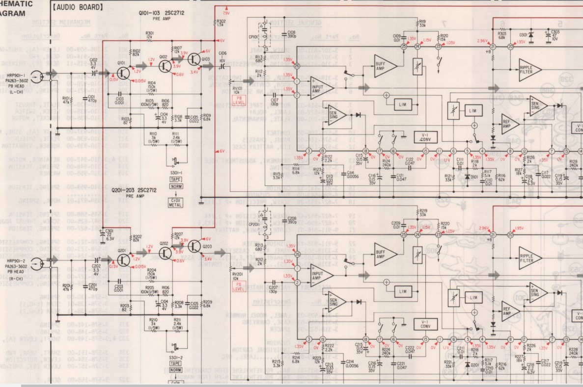

  12. Silver965
    Silver965 Well-Known Member
    721
    Torino
    As a preamp I would use the DC2 schematic ... three transistors
    Valentin and Levia Chan like this.
  13. Levia Chan
    Levia Chan New Member
    19
    Brighton, UK
    Yes, this would be ideal as it could save some board space for larger/more decoupling capacitors, which would be needed if implementing Dolby C like DC2 have done
