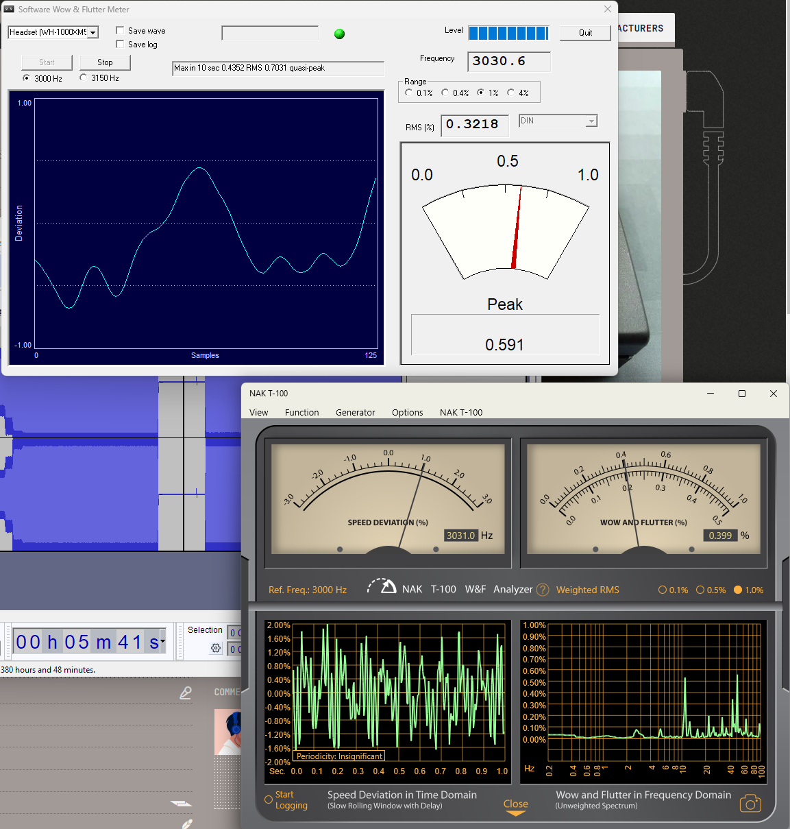

    Seems like I have another one to repair somewhat.
    This was sold for a pretty penny but it got lost in the post for 3.5 weeks so I ended up getting it for free, as I got my money back from Paypal and the seller got to keep my money. So a win-win.
    The downside? It's not in great working condition that was described.

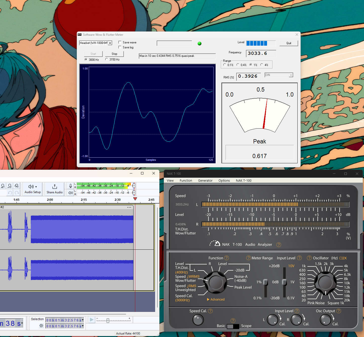

    Speed is 1% too fast and W&F is as bad as 0.45% in some cases, making it worse than all my other belt driven models. So this tops even my HS-PC202 Mk3 with bad motor hum in W&F.
    The seller said that he put a brand new "Decktech" belt on it and that it "looks and sounds perfect".
    He also said he calibrated it with a multi-meter.
    Unfortunately not...
    The left channel is also quieter than the right on Volume below 7. So 1-7 it's quieter, after which it gets louder. So I suppose increased resistance somewhere. Right seems fine but the left is not. Unless I turn the volume up to 7 or higher.
    Here's a 30 second, 3000Hz audio sample (turn down your headphones): https://vocaroo.com/15R7IrXSN5sa
    You can clearly hear that the left channel "lags" behind the right when turning up the volume. It also tends to clip at max volume. Though this might just be audacity.

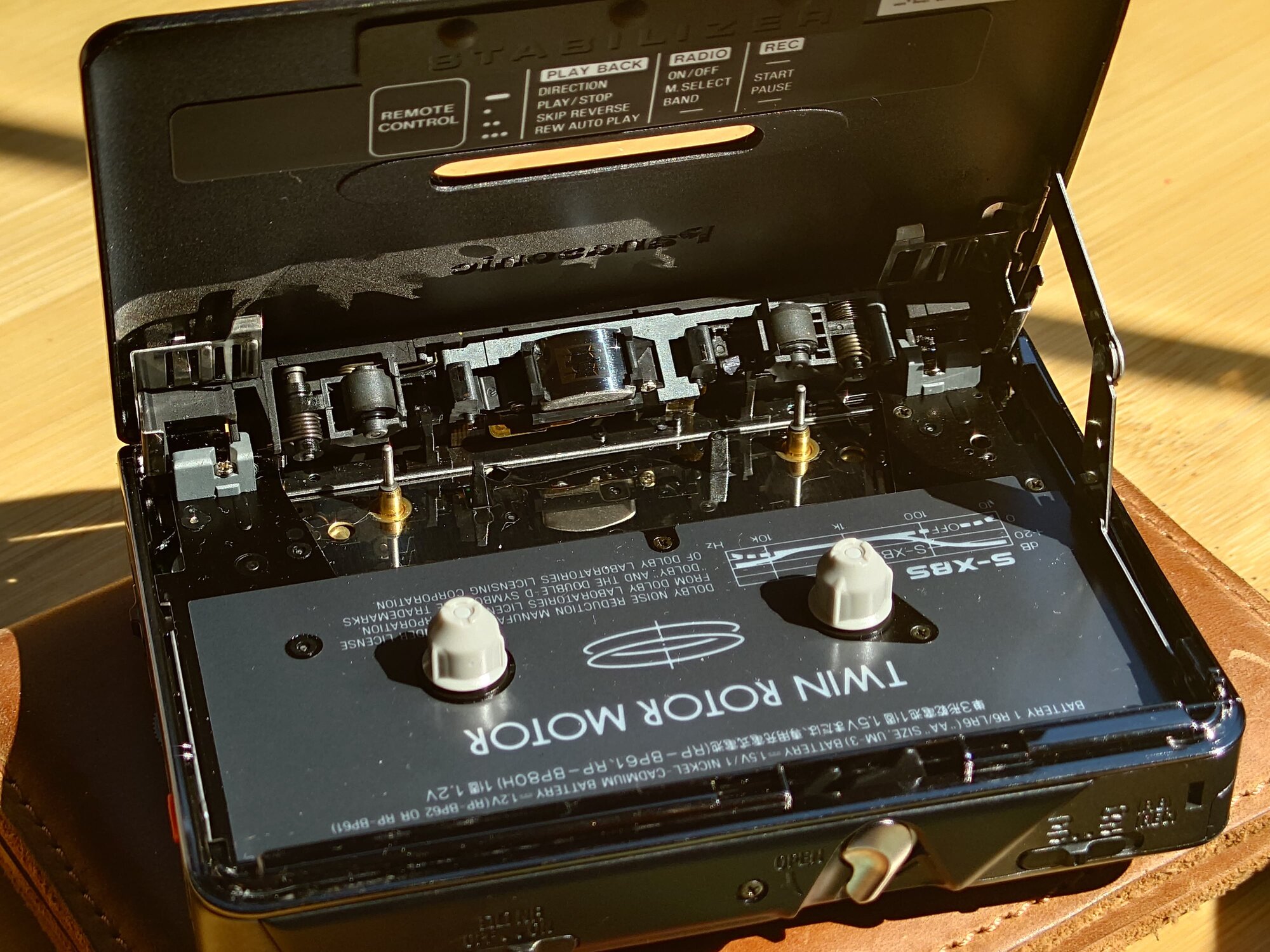

  2. givemeyourwalkmans
    188
    Some quick photos of the device condition. Maybe only the right pinch roller looked a little 'dirty' but it otherwise looks immaculate.

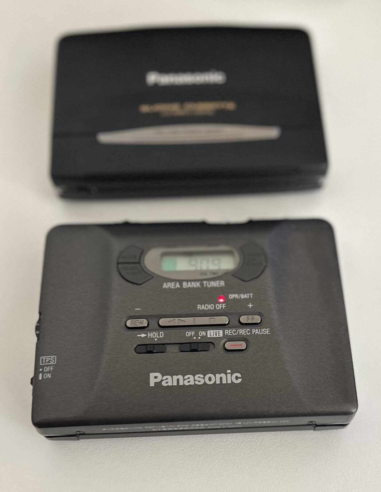

    No idea about the pressure on the rollers or brackets. I managed to find a guy who has been repairing these for years who is confident in his work. I'll get him to do a full report and take some photos of the interior.
    It seems you have the "Z2" version. Specifically the "RQ-S90F Z2" this model was specific to Japan. You can distinguish it from mine on the front via the fact that it has both a dark green square on the right side of the LED display and the words "AREA BANK TUNER" on the front and not "RECORDING" like it does on mine. Otherwise the units as I understand are identical.

    I had no idea that there was a JDM version, thanks for sharing.
    The S70 remote does not work by the way.

    I'm not familiar with this particular walkman, but mechanism is AR90 used in all Panasonic RQ-S, some RQ-SX and even DCC portables. Generally speaking a good mechanism.
    However motor, capstan bearings and the main pulley is recommended to be cleaned and re-lubricated as a basic service.
    The main pulley which drives the geartrain can be a problem on some units, being hard to turn due to old grease.
    To be noted the retainers on the capstans are not split washers on this models, so more care is needed to remove them. However the washers can be reused without a problem.
    This model is the newer generation without pad lifter, so the bent pinch roller holding pin isn't a problem here.
    Pinch rollers also look good, I would just clean and leave the original ones in place.
    W&F is indeed very high for this mechanism which can typically achieve very low w&f.
    In regard to the imbalance, a cleaning of the volume potentiometer is the first thing to do.
