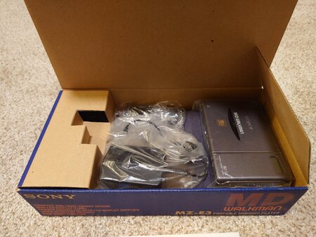

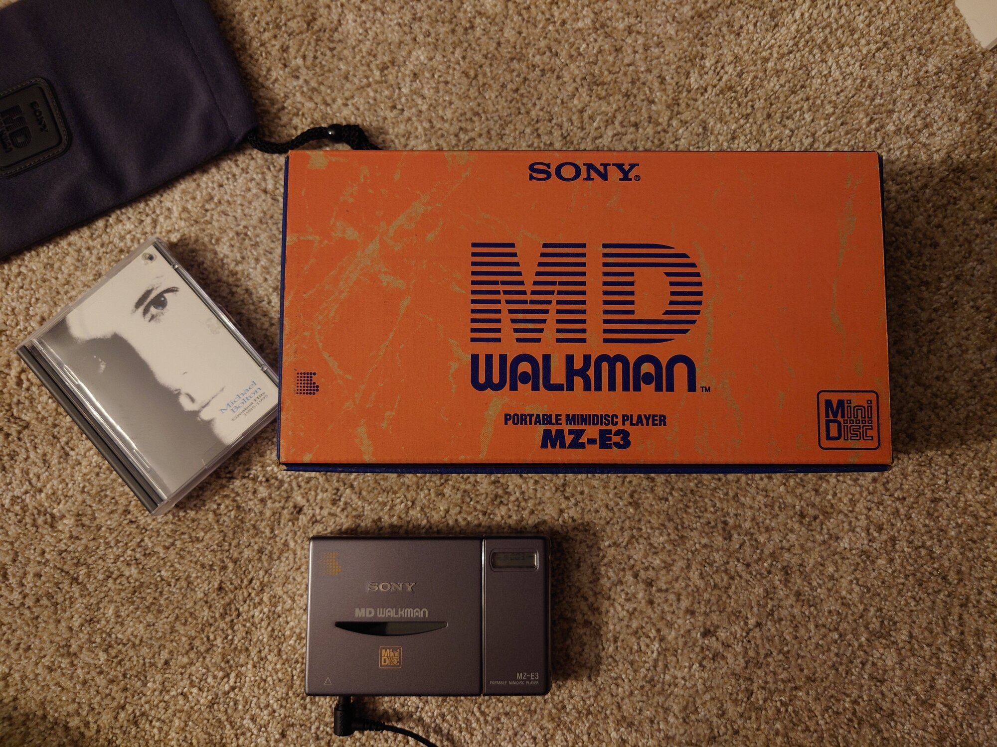

    I was able to spend some quality time with my MZ-E3 over the soothing sounds of Michael Bolton. I love the JP box art of this player, so cool...I know I always snap carpet photos, and I'm sorry haha, but I don't live in an environment where I have space to set up a proper photo rig.
    Anywho, this guy has never been used far from the box, and the headphones/LCD remote are still unused. For the best too, they are usually not as good as proper headphones IMO.
    I like the loud volume output of the MZ-E3. I am used to the MZ-N1 and similar, to where the headphones only begin to sound loud at max volume, maybe I am alone in that observation, but this player is plenty loud at max, and actually I feel perfectly fine using it below Max volume.
    20230311_230102~2.JPG 20230311_233708.JPG 20230311_233734.JPG 20230311_233748.JPG

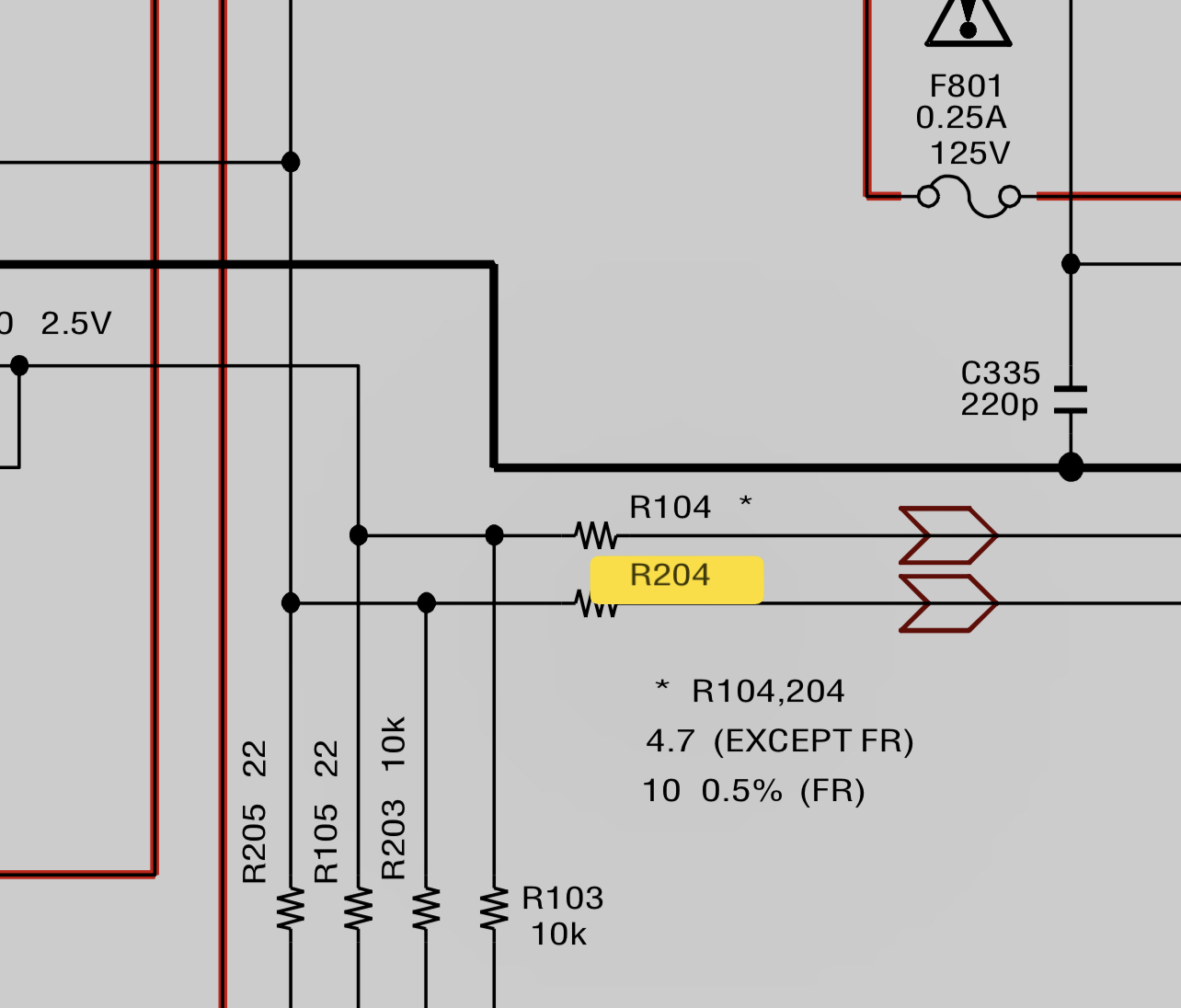

    Interestingly enough the MZ-N1 and MZ-E3 have the same power output specification (2 x 5mW into 16Ω).
    I wonder if one has a regulatory power limitation built into the firmware...
    Otherwise I can't explain myself how one would sound much louder than the other.

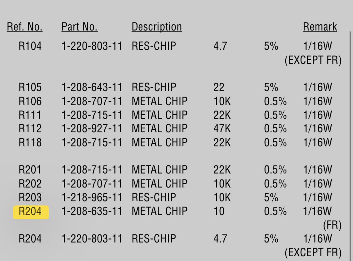

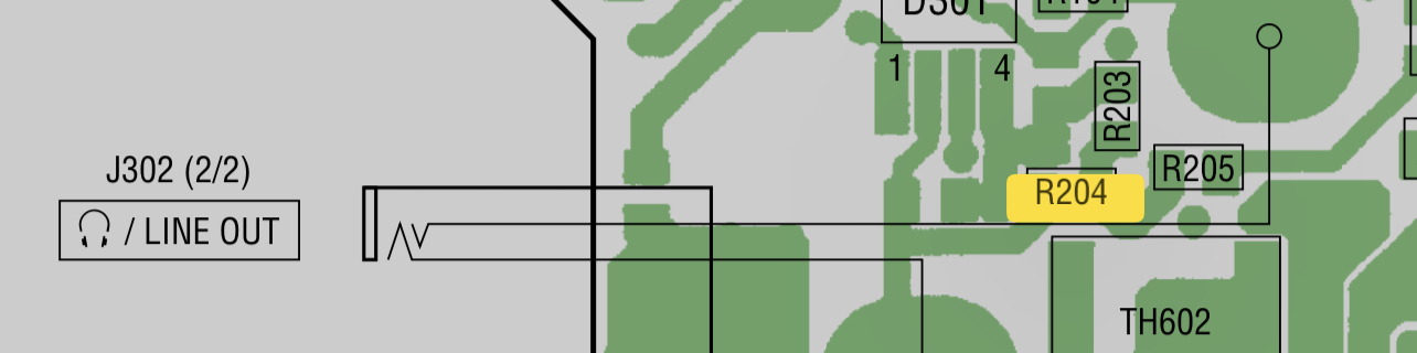

    There are only 2 versions of the N1, marked in the service manual as FR and EXCEPT FR. R104 and R204 are identical for L+R channels:

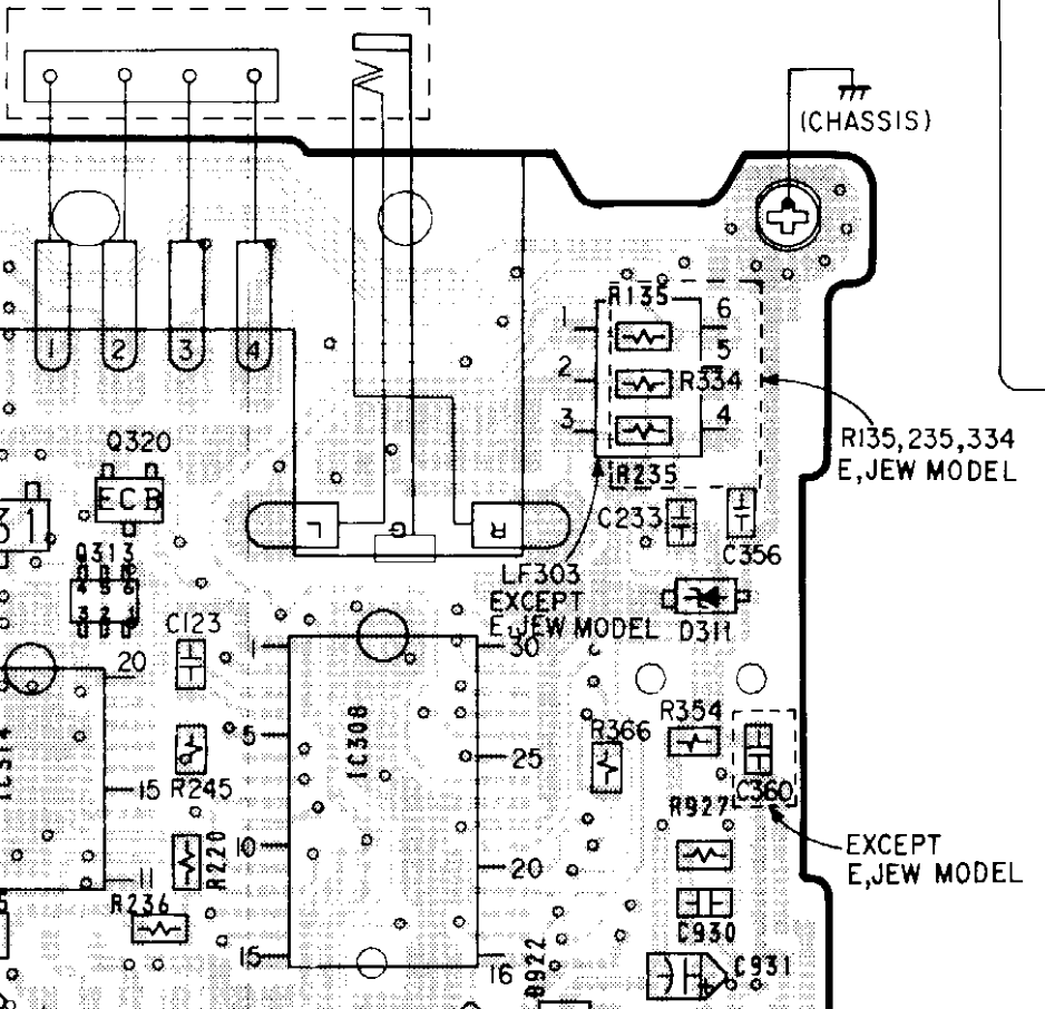

    And here are the optional components per the MZ-E3 service manual. IC308 is the headphone amplifier.

    ... or maybe my model was dodgy... but I did have two (one blue and one silver), both were much lower than anything I'd heard previously. You are definitely right though, on paper they shouldn't be any different.
    Incidentally, I found that turning off 'bass boost' in the little OSD did make things slightly louder... *shrugs*
