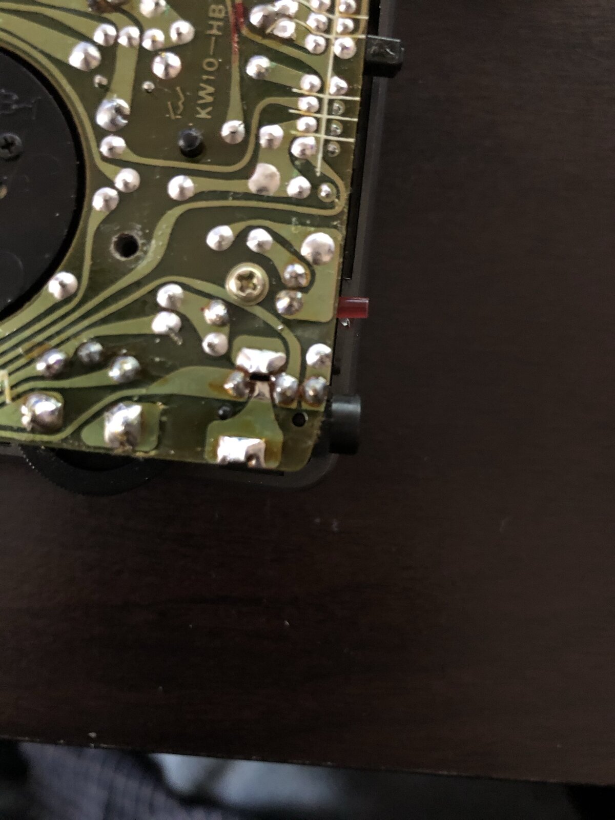

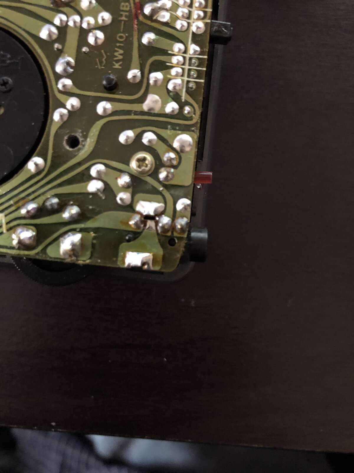

    I opened the case back up and I tried taking the main chip part out but one of the screws was stripped, so I'm not able to take it apart all the way. I've never soldered before, so I don't really know what I'm looking for but maybe this helps? I dunno how I'm going to get the screw out but I'll look it up.

    If you have never soldered before I would have a practice on something unimportant first. You can get small kits which would be a good thing to practice with. My other sdvice would be to use leaded solder. A stereo of that age would have used it and it is much easier to use than the lead free type which has a higher melting point and doesn't flow nicely.

    This is a great unit to learn on, it looks like the solder cracked at the headphone jack which is very common, years of pulling headphones on and off and hitting objects puts a lot of stress in this area. I'd get a TS100 soldering iron on Amazon and work on your skills.
    I call it cam'd out when you destroy the top of the screw, with these units they use Japanese Industrial Standard heads and they look like they fit our more common Philips Screwdrivers but they can apply much more torque. Using Philips will cam out once in a while and it's frustrating so I highly recommend getting a set of Vessel JIS on Amazon.
    Getting it out might be hard, first I'd try with JIS Screwdriver, there still might be enough bite to get it. A very small Vice Grip might also work or lastly a Dremel to cut a slot for a slotted screwdriver. With tiny screws this can be difficult.

    If the problem is the cracked joint, there may be no need to unscrew anything. You can just remelt the existing solder using a soldering iron, though it may be better to remove the old solder and add fresh one instead,
    Not quite clear, it looks like it may be cracked on the leftmost pin of the headphone socket. A cracked joint will look like this http://www.discovercircuits.com/dc-mag/Issue_11/pg-3.htm
