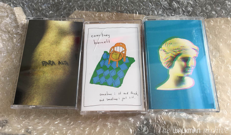

    I recently noticed that there are new labels releasing new music on cassette. Based on what I've learnt regarding the quality of prerecorded cassettes, I thought I'd give them a try.
    I also knew about a small label called Kissability, ran by Jen Long that I knew of in this video I've recently posted in my blog. So I took a quick listen of some of the cassettes they were offering and I decided I'd try the ones by Courtney Barnett and Sad Palace. I called my friend TJ Autoreverse to explain him and he also wanted one of those, so we ordered three together.
    A few days later a small package arrived:

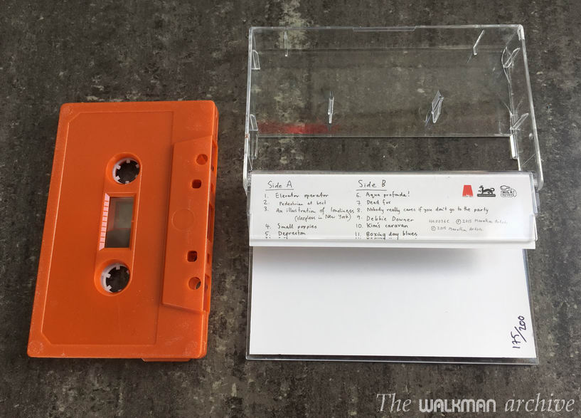

    The cassettes used were new and coloured ones:

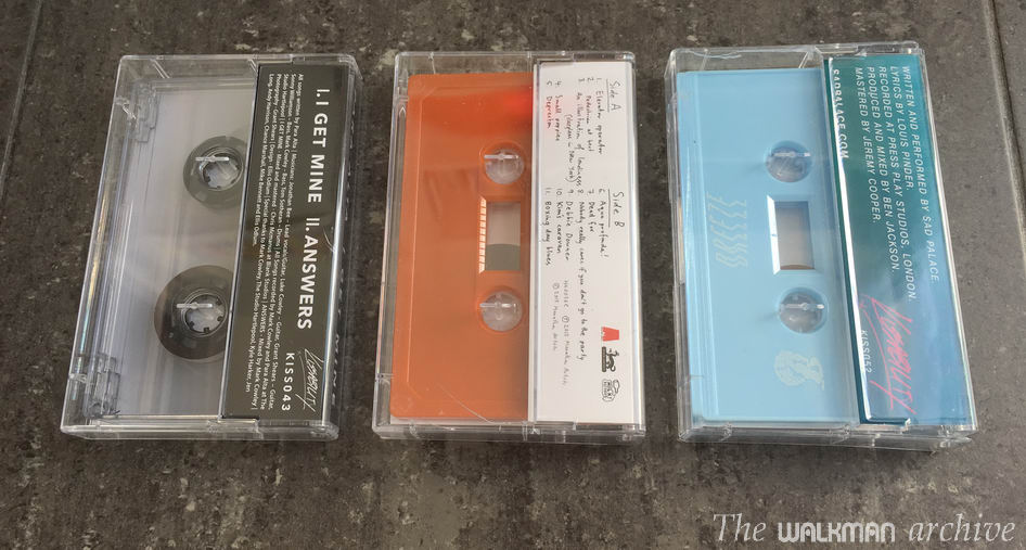

    They look like some sort of cheap ferric ones, due to the tape colour:
    After a quick listen of the orange one by Courtney Barret, I immediately noticed that the recording quality was not perfect. I played in in my SONY TC-K909ES (serviced and improved by ANT Audio). The levels in Courtney's tape were more or less ok, on the Dolby mark but they were quite hot in the blue one.
    The sound was a bit narrow and dull. But what was mostly noticeable was the lack of highs. I think that could be an azimuth issue but all my decks were perfectly aligned using professional. Anyway, I took my philips screw and tried to adjust the azimuth on the K909ES for this tape, but there was no improvement. Turned it to one direction, duller sound; turned it to the other one, duller again, so I left it untouched.

    We just know the tape is not the best, but the one in the orange shell looks very strange, it seems even a dirty tape; it even recall the term "cookin ferric" to me. Could it be the photo?
  5. walkman archive
    1,899
    Yes. I'm sad to say, but it's the truth: the actual releases on cassette are more a thing to look cool than to listen to.
    The orange one is brand new and totally clean, ha ha. It really is of that colour. But regarding colour, it could be your own monitor which if it's not colour-calibrated, it can be for sure showing a very different color.
    I'm watching it in mine (which is a professional photo and perfectly calibrated) and the colour is fine, though not totally faithful to the real color, as I took the photo with my phone and not with my SLR camera.
