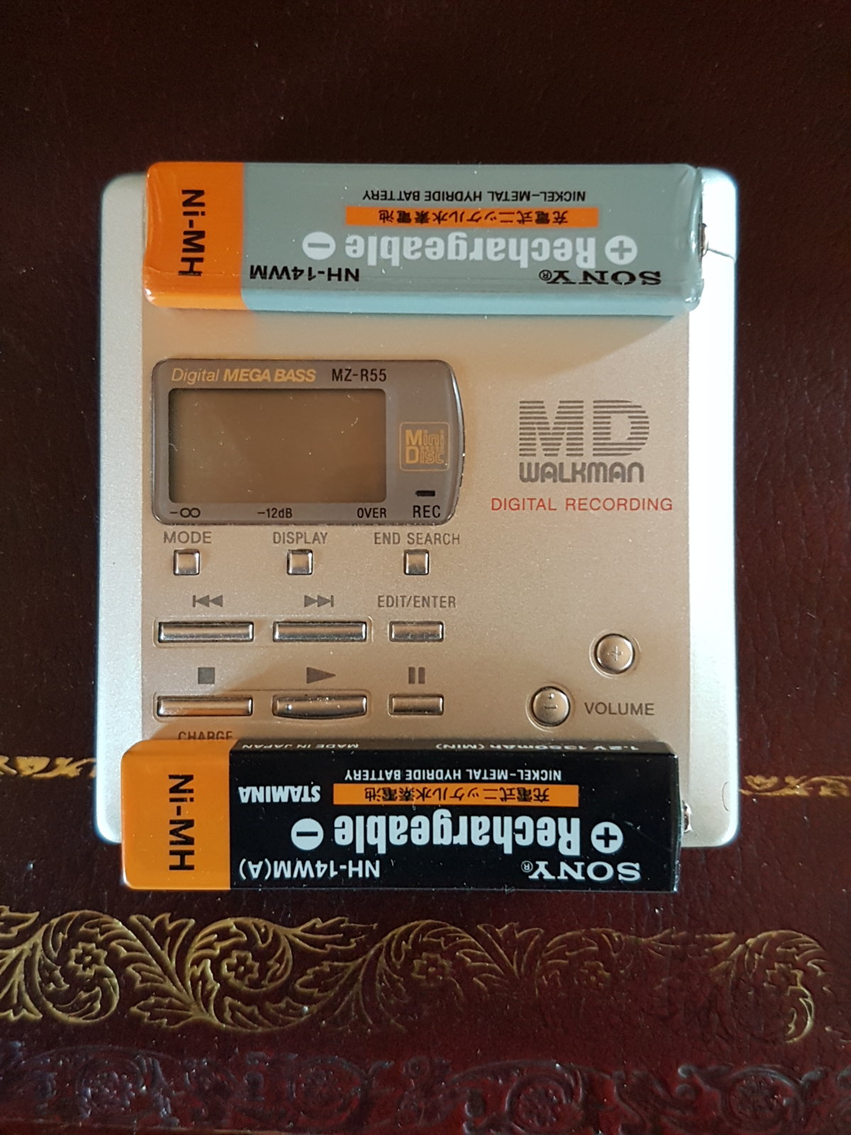

    I have a couple of MZ-R55 mini disc Walkman that I had virtually abandoned due to the failure of Sony OEM gumstick batteries to power the units for more than 10 minutes from a full recharge. The same battery will run the DD9 for around 2 hours but put it the MZ-R55 and up comes the "Low Batt" flashing display and the Walkman shuts down. Even an expensive new Sony battery in shrink wrap gives the same result.
    However, an older battery, in the black and orange design will run the same MD player for 2 hours after a full recharge.
    So can anybody explain why some of the same OEM batteries appear to better than others and how do you find a good one?. I have 5 batteries. They all work in a cassette Walkman but only one will run the MZ-R55.
    Cheers

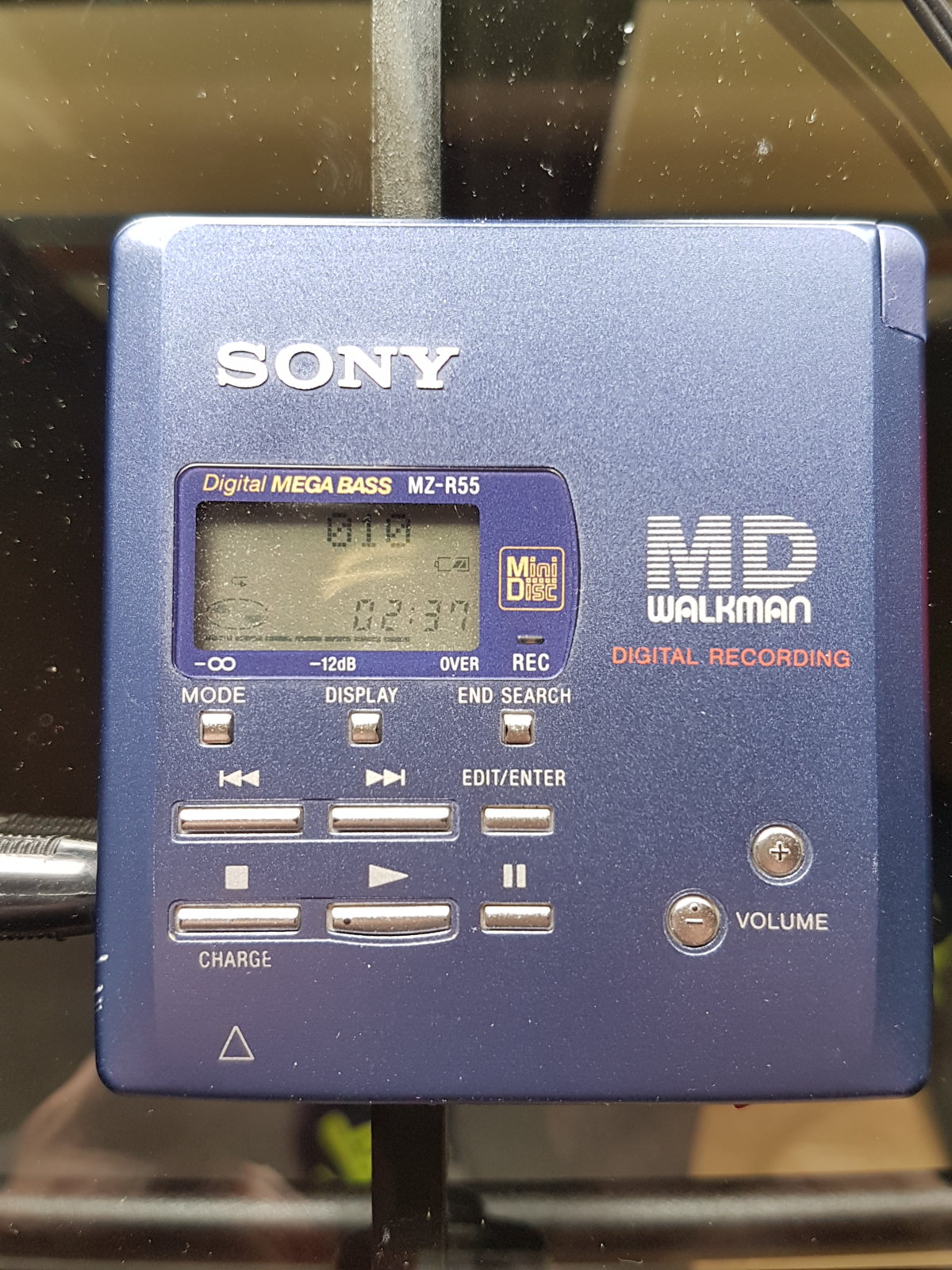

    Wow. The MZ-R55 has been on repeat play for 3 hours on the good Sony OEM NH-14WM battery. So charging it in the old 110VAC external Sony charger and not inside the MD Walkman has something to do with maintaining the charge in the battery. They're not supposed to have memory effect but something happens to reset them so they end up with less and less capacity after each discharge until it gets to a point where the MD auto detects low battery but a DD9 or any other gumstick powered cassette Walkman runs on this supposedly flat battery. I used to think it was a fault in the MD or poor contacts in the MD during charging and it still maybe even though both behave the same way. I just wish you could get a Lithium ION version of the NH-14WM like a LI-14WM.
    My MZ-R30 has a Li ION battery that is 20 years old and it's still perfect. 20190930_141207.jpg
