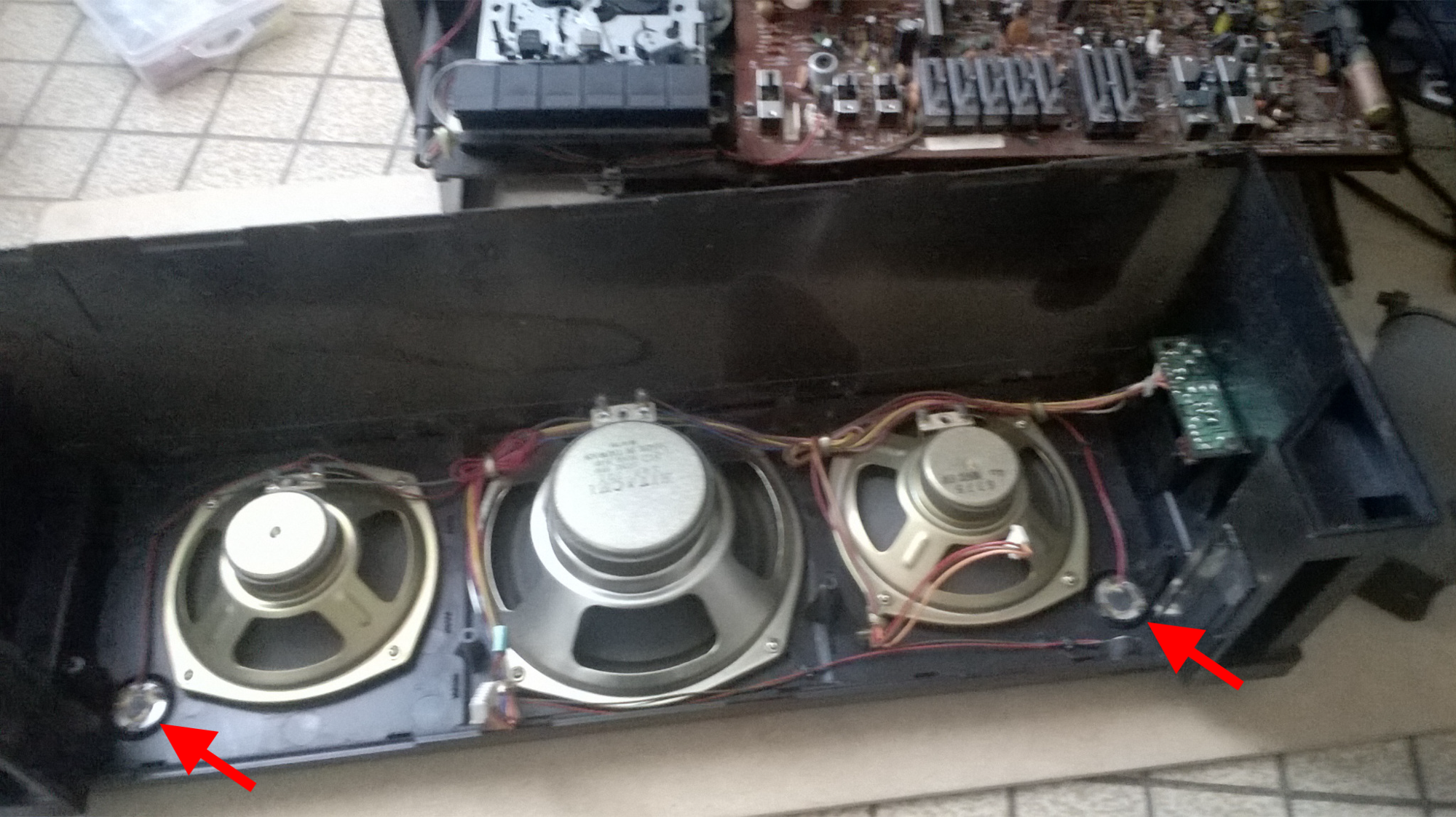

    Original RX-CT900 Ceramic Tweeters & wires
    I have replaced my original ceramic tweeters with
    high output piezo tweeters on my RX-CT900
    and after the replacement now it's up to 19 kHz /measured/ and
    trebles sound way more detailed and it makes cents!
    So if you want to discover what your boombox amp
    can do for real - i recommend that to you.
    Any suitable car tweeters are good as well.
    And don't forget about capacitors.
    The values of capacitors may vary /depends of impedance of your tweeters/
    4,7 uf 100V would be fine in most cases.

    Agree completely with it being a marketing thing - they wanted to shout about more features on the boombox or in the blurb.
    What I find interesting here is the devices indicated in the below pic of a Hitachi 3D7 are referred to AFAIK as 'Piezo tweeters'.
    Clearly, they are wired in devices (no crossover, however) but I personally have never heard a thing coming from them, & many other similarly equipped boomboxes.
    I'm guessing either these are not 'high output' piezos or they are mis-named ceramic tweeters...

  4. Reli
    Those are in fact piezos, just cheap crap ones. Like the ones inside a talking greeting card.
    Perhaps when the boombox was new, they worked, but now they don't anymore. Or their frequency range is too high to be heard. I personally can't hear anything above 13 or 14K, so I wouldn't know....

    I think those are not a piezo type, because I don't see any capacitors there,
    which means they're high impedance plus they just look like a typical ceramics.
    Check their impedance and go from there.
    The good thing is - you have plenty of space to install any type of tweeters in this cabinet !
    Measurements are the biggest problem in most cases, but you're lucky!
    I would go with automotive ones in this case..

    My guess, from their looks, is that they are very similar to the alarm sounders used in Digital watches and Musical Greetings cards. I/m sure we all know what those sound like.

    Piezo tweeters are usually flat discs. However, they can be shaped like a dome instead. Also, they can be made of metal, OR ceramic.
    The phrase "ceramic tweeter" is meaningless because without further information or visual inspection, you won't know if it's a piezo tweeter with no moving parts, or a regular tweeter with moving parts such as a surround, voice coil, etc. It could be either.
    Even the word "dome" is meaningless because it could be either a piezo or not.
    So there are:
    1) Flat metal piezos (typical in cheap boomboxes and greeting cards)
    2) Flat ceramic piezos
    3) Domed ceramic piezos
    4) Domed ceramic non-piezos, complete with a magnet, voice coil, suspension, etc.

    I understand your note, but in the Official Panasonic RX-CT900 Service Manual
    they are "
    2 cm Ceramic Speakers" under the " Tweeter Type" section
    Please, see the attachment.
    P.S. What would you call them?
  13. Reli
    They're piezo because they're flat with no magnet or voice coil.
    As to whether they are metal or ceramic, I have no idea.
