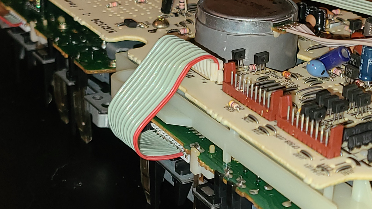

    Hello! After some time, back here again.......I need to replace the belts of a second unit I bought (also a RX-DT505). I already have the cassettes mechanism out. Now I need to remove a circuit board which is on the bottom part of the whole mechanism. For this, one of the steps (following the service manual instructions) is releasing some connectors, from which I have already released two. But the others two, which I show in the following pictures, are being a little pain in the neck. I try doing it by the edge that I think is the one they suggest in the picture of the manual. But after trying several times and even with the use of some strength, I'm afraid of being doing something wrong and damage the connectors. Besides, I have also tried on the other edge of the cable, but also with no success. Does anybody know the correct edge I should pull out? The one connected to the geen board, or the one connected to the white board? Thanks in advance.
  17. Longman
    Have a fiddle around on the marked connector to see which bits move. To me it looks as if the bare wires at the end of the cable might be gripped into the connector with a latch. A have seen that on quite a few bits of consumer electronics.
    kanamaster likes this.

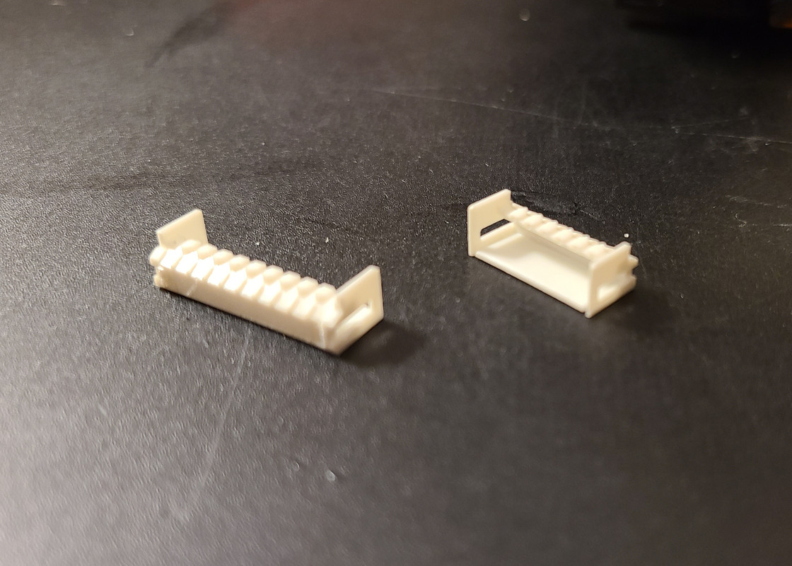

    Maybe you are refereing to something like the ones I show in the picture below? If it is the case, I removed them before trying to release the cables, but as I said before, with no success. And I'm affraid of damaging the solders of the connectors on the board. Thanks for your idea.
  19. Radio Raheem
    Try pushing down on the clip facing the motor, at the same time gently pull the wires.....I have done these before but dementia is setting in, so be careful
    Mister X and kanamaster like this.
