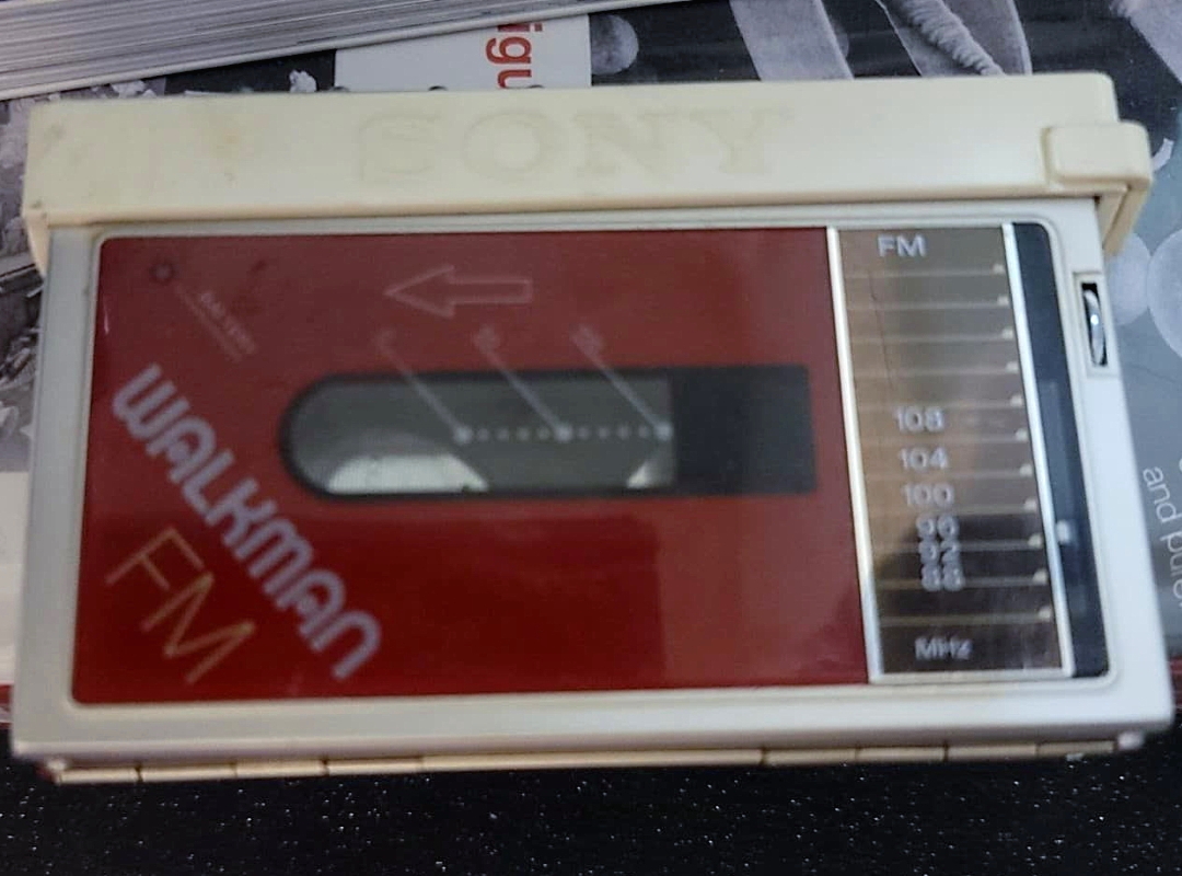

    The Sony, I received from a close friend who purchased it new in the early '80's. He mentioned that he noticed a co-worker listening to music on one and asked the person about it. It interested him enough that he went out and bought one. He said that he used it for 2-3 years and it has been stored ever since.

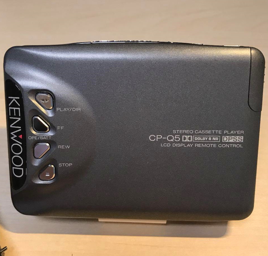

    The Kenwood, I bought from Japan through Neokyo (I strongly suggest NOT shopping through them, but that's a story for another day). It only included the AA battery adapter and was more than I wanted to spend, but the condition appealed to me and it was advertised as, "Overhaul, speed adjustment by tuning meter, cleaning around the head, demagnetization, application of contact
    restorer" with a picture included. I'm hoping to get a definitive cost of service, before the return window closes.

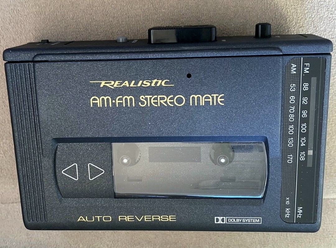

    The Realistic, is new old stock and was purchased through eBay. I wanted a "brick" style cassette player and this one has Dolby and auto-reverse (great features back then).

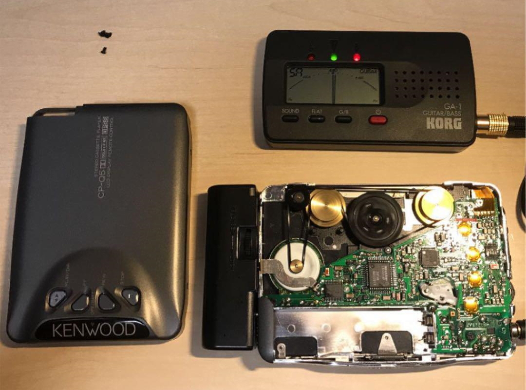

    You can see the belt easily in that one, check for blobs of old belt. Sometimes the old belts turn to a tar like goo and even tiny specs will get on the turning parts and slow them down. I've taken apart freshly belted units several times and using a magnifying glass have found small specs.
    I can't tell if that's corrosion in the upper left, the white stuff, if it is the unit might not be getting a good connection to the battery, causing the speed changes.
    Are you using a guitar tuner with a Mhz tape? I've never seen that done, cool stuff.

    The white on the op left is simply reflected light on the polished piece. The picture wasn't taken by me; it was part of the seller's listing to apparently demonstrate that it had been overhauled and was properly working, which it certainly is not.
  9. Rudy Rodriguez
    Rudy Rodriguez Member
    57
    Tucson, AZ
    On the Kenwood, I would tell the Seller that the cassette player does not work as perceived, that there is too much "Wow & Flutter" when playing, and that it was probably damaged during transit. And ask if he will accept a return. Most likely the unit is insured, and you would get a full refund. The Seller must decide if he still wants the unit back and pay for the high shipping costs. Another option is to negotiate a lower price since the unit was damaged during transit. Also note that the unit is missing the remote control, original headphones that connect to the remote, gumstick battery and charger, so it should not be priced as a complete unit.
    On the other hand, the Sony is a great find, and more than likely has never been opened, so a simple belt replacement might be all that is needed. Buy the correct belt size on eBay (search for Sony WM-F10 belts) or go here: https://fixyouraudio.com/product/belt-sony-wm-f10/. You might be able find a local electronic, computer or watch shop that would be willing to do this. You can see several belt changes for this unit on YouTube. The only real problem with this model (and WM-10, WM-20) is that the mother board is so thin, a simple fall can break the unit.

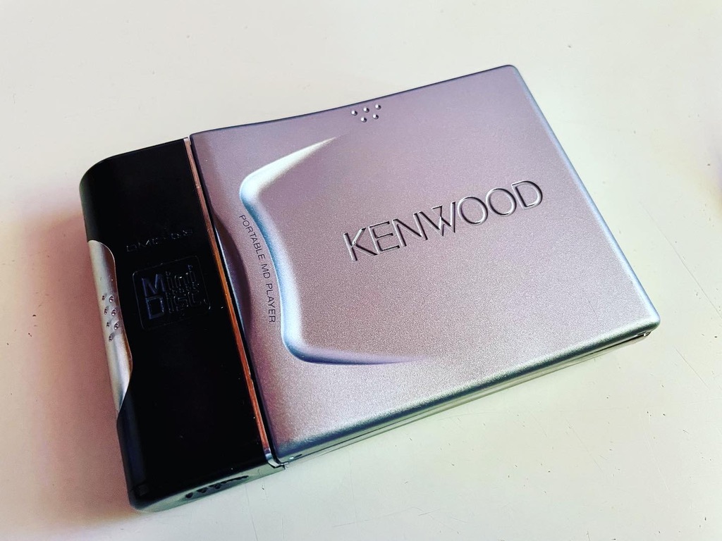

    Your Kenwood player reminds me of the DMC-G3 MiniDisc player I bought a while back.
    Sadly, it does not work. Something might be wrong with the carriage movement.
    Mister X and Rudy Rodriguez like this.

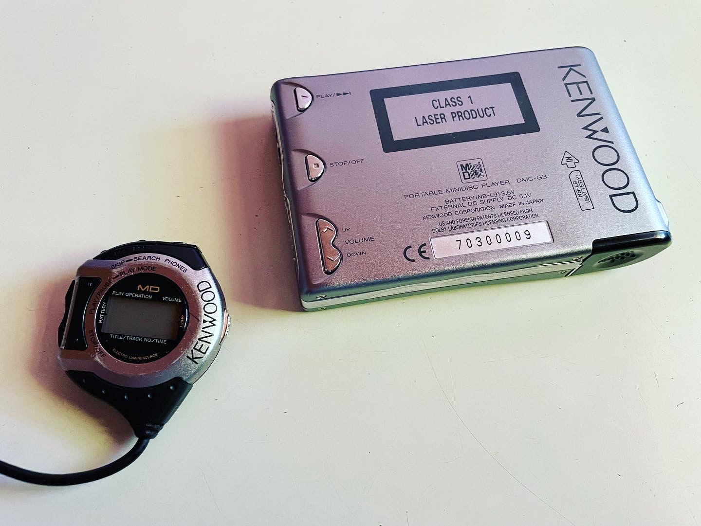

  11. Emiel
    1,071
    Or the “giant laser”.
