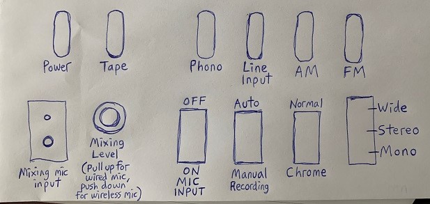

    This is a generic picture from a sharp GF 305 I think and then let me get you the other one
    Again, another generic picture from the sharp gf305 copied from the Wikipedia boomboxes page for that model.
    Reason why I'm posting these here is because it explains what the buttons do.
    Your sharp gf9696 should have the buttons laid out in this manner.
    You need to select the radio FM or am and then the power switch and that will turn on the radio without having to press the buttons on the cassette deck.
    Otherwise, if the power button is not on then the tape deck will operate without the power switch being depressed. Hope you can understand that.
    10th July 2024 so it's been 2 months where you been? Thanks. Hope this helps you.
    Ps decentman4you2007@gmail.com or you can send me an email and I'll answer any questions. I'm in Dallas, Texas. So good day.
