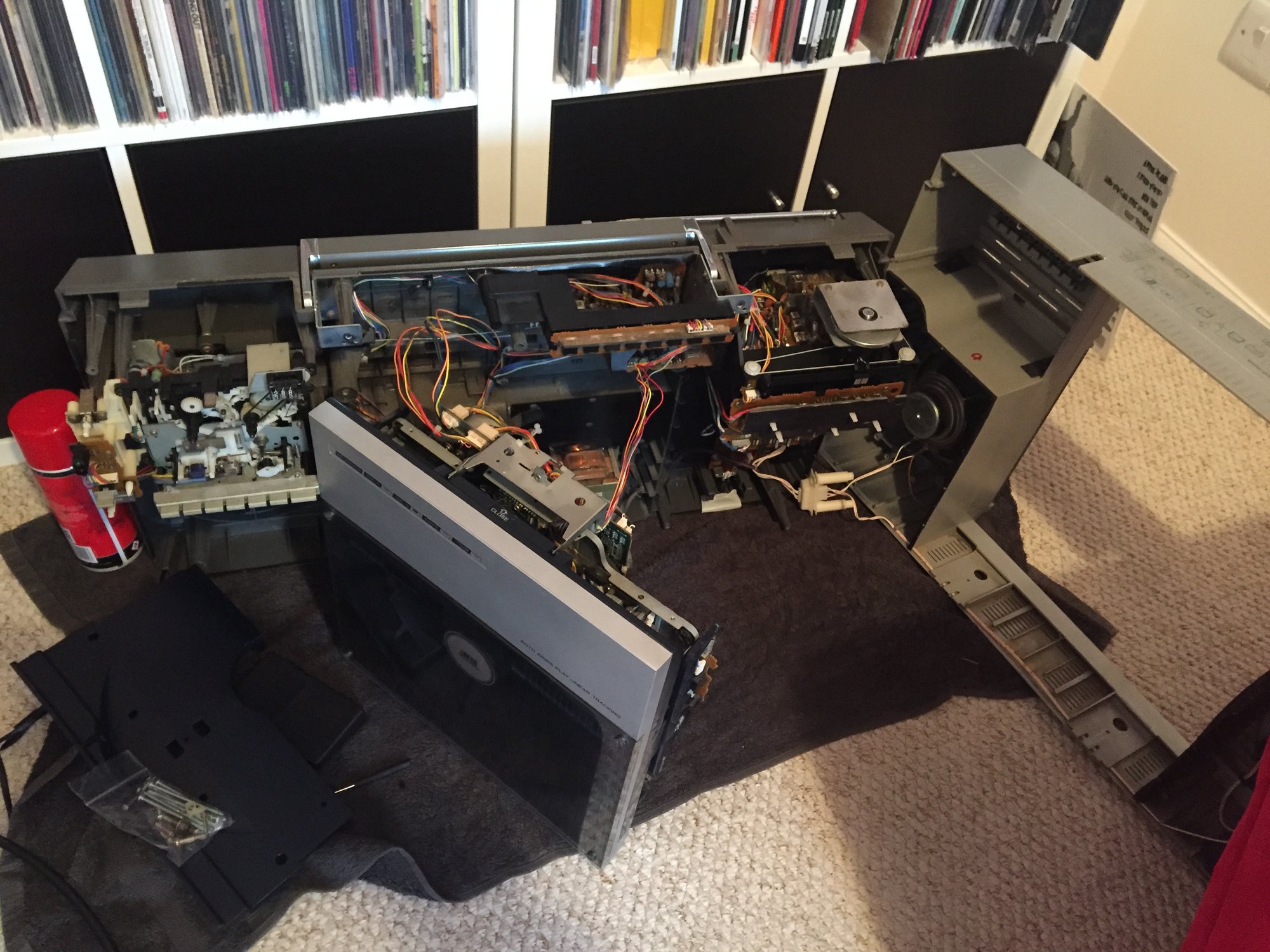

    Hello all, I'm looking for some advice from you good people for a problem I have.
    I have recently acquired a Sharp VZ-2500 , but I'm having issues with it. I've replaced all the belts and cleaned it up but the record player is playing slow on the side b at 33 and at 45rpm, the a side plays fine at both speeds tho.
    When I first re-belted it I had to adjust the speed pots to get the as both sides were playing slow. Now I'm happy with the A side it's now its just the b side that plays slow.
    I've been running it on repeat a lot with a record in just to get the motor used to running again, but thats about as far as I got? It's just sitting in bits as I don't want to reassemble it until I can fix it.
    Im happy to take things apart and replace things, but my electrical fault finding is fairly limited.
    Any advice would be greatly appreciated.
    All the best,
    David
    (I hope this is in the right section of the forum.)

    I will try and give the motor a clean/lube. The same motor drives the A and B sides in opposite directions. The two speed pots just adjust the spend at 33 and 45rpm speed.
