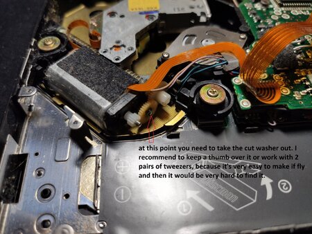

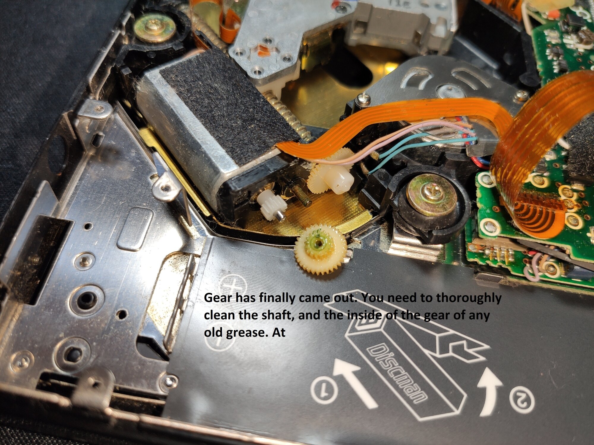

    I recently bought a cheap SONY D-250 Discman on an auction site, which was described as faulty laser.
    Given @Jorge told me about the common problem with frozen middle gear, I hoped this was the only problem and not the laser itself. Seems I was lucky in that regard and everything is in perfect working order apart from that frozen gear. Have to say the unit sounds very good, clearly one of the best Discmans ever made.
    There's nothing else I have done, except for a general cleaning. Given how good it now plays CDs, I didn't even bother to check the PLL free fun frequency, tracking balance and focus bias.
    I will probably do that at some point in the future, but now I'm more concerned with building a custom 3D printed battery case for it, as it seems that there are no plug-and-play replacements available at this point. Will make a separate thread regarding the battery when it's finished.

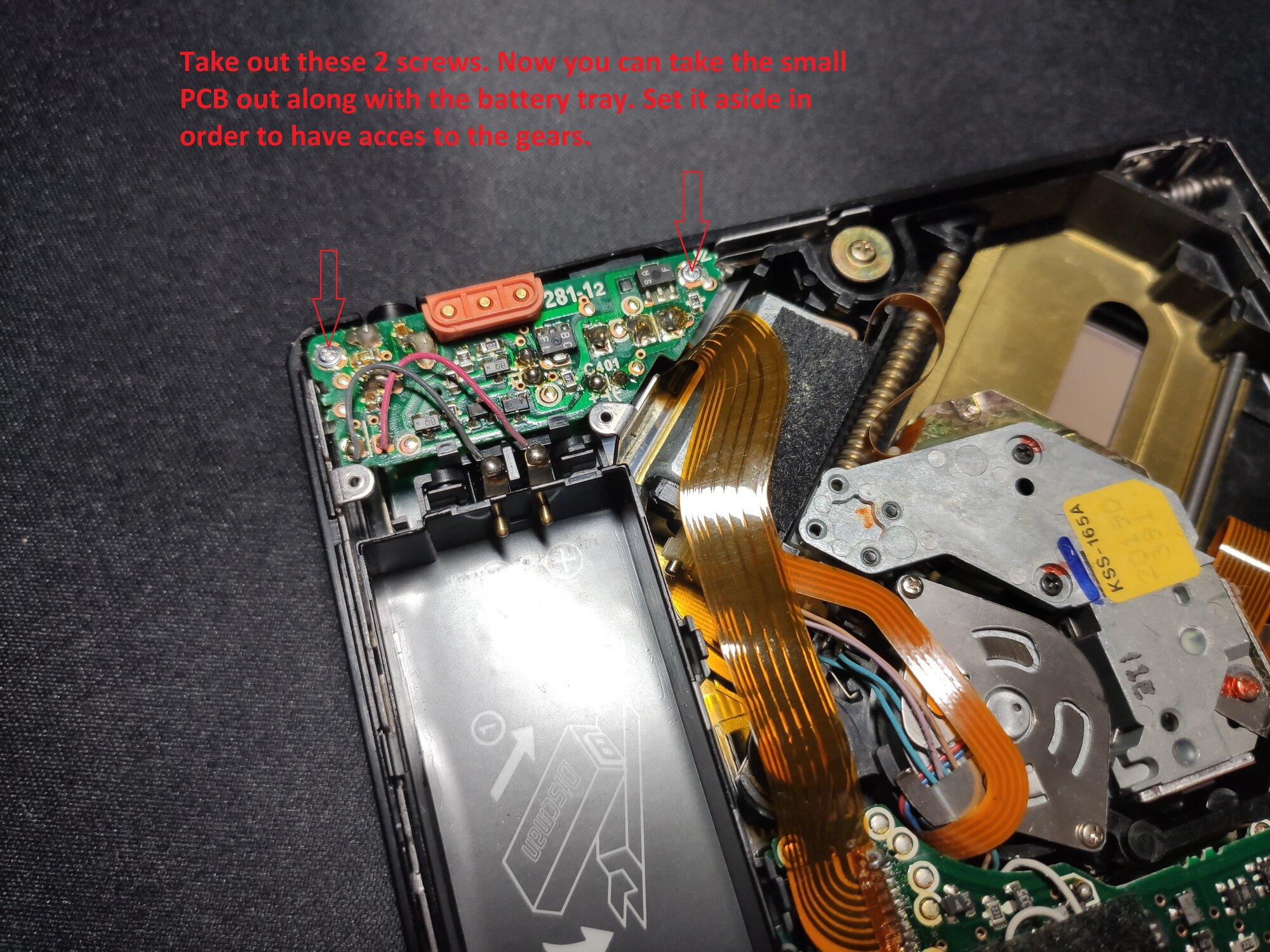

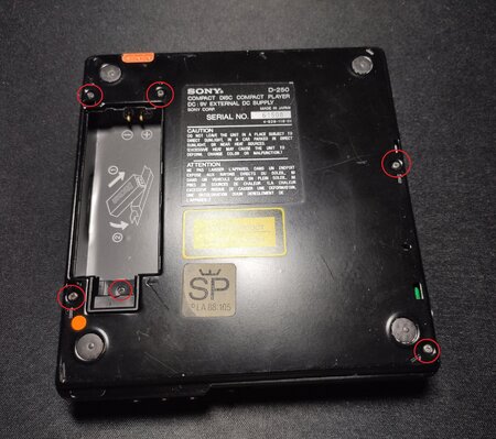

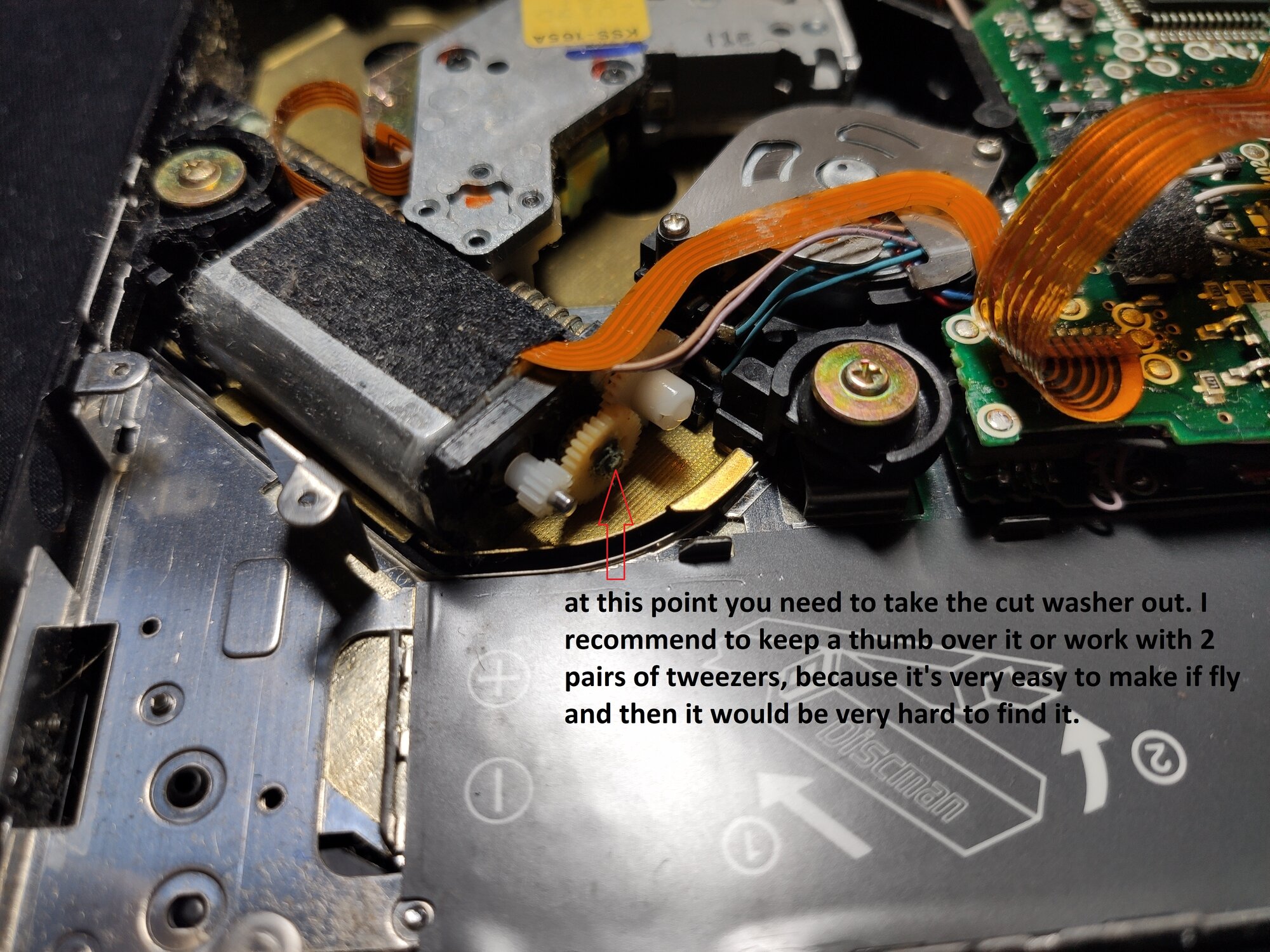

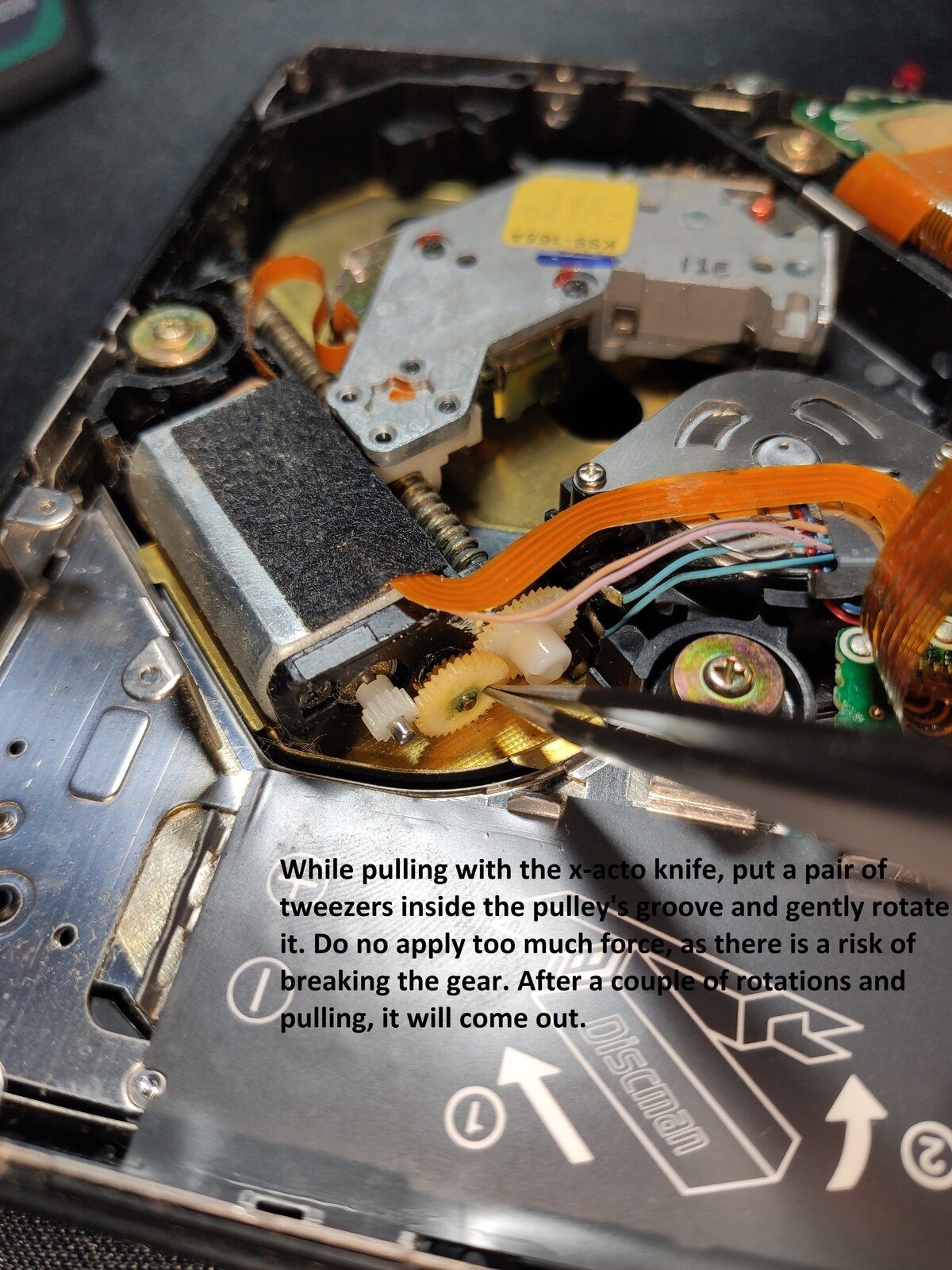

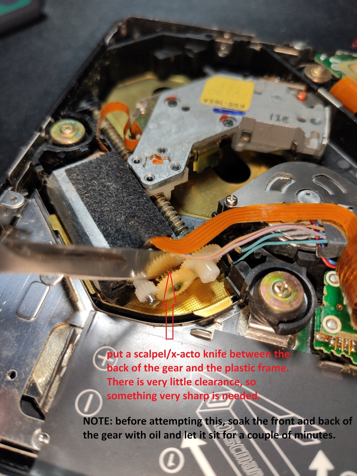

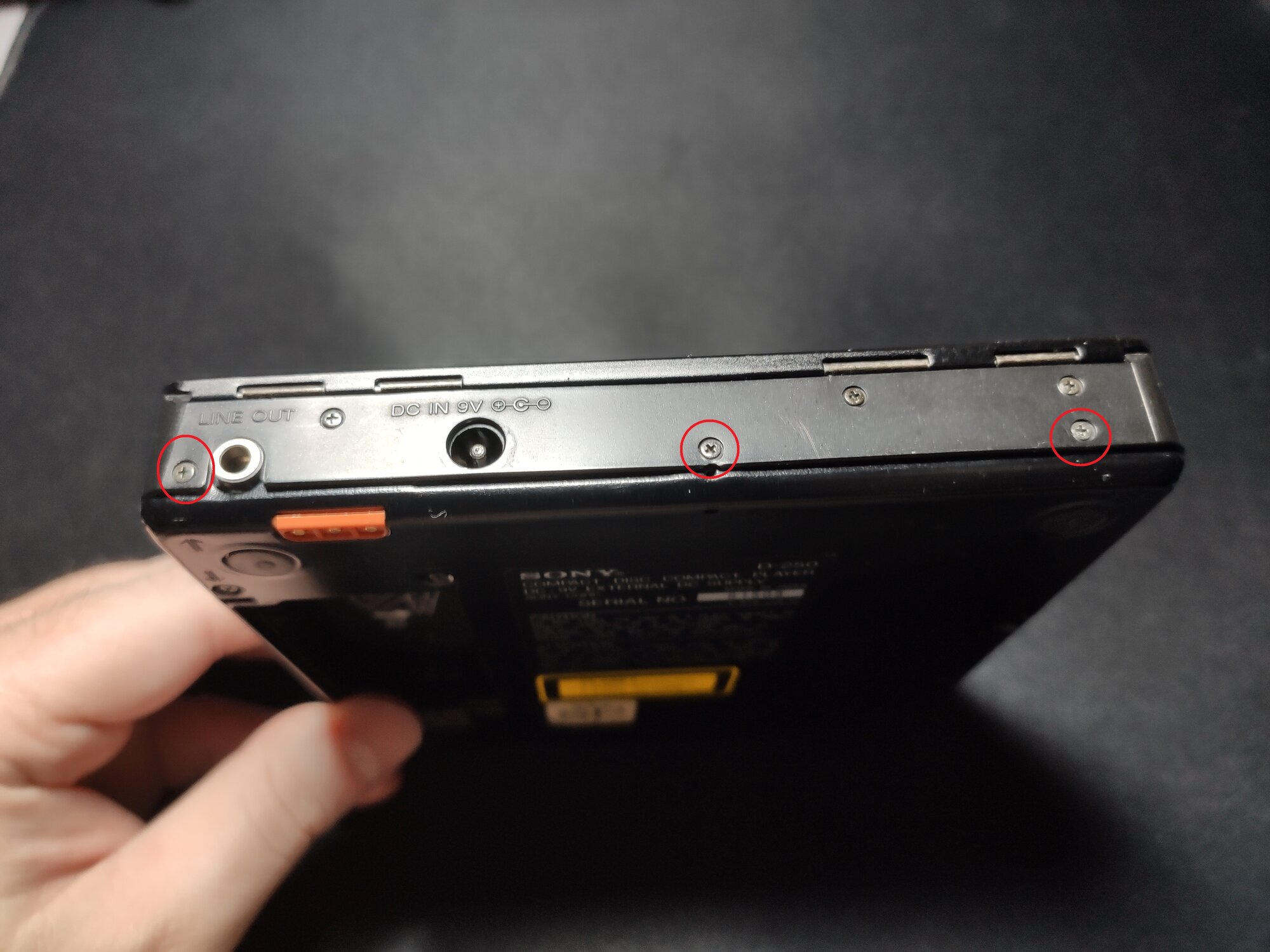

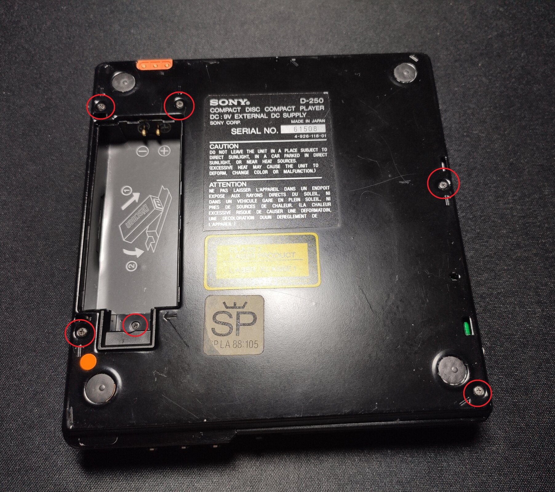

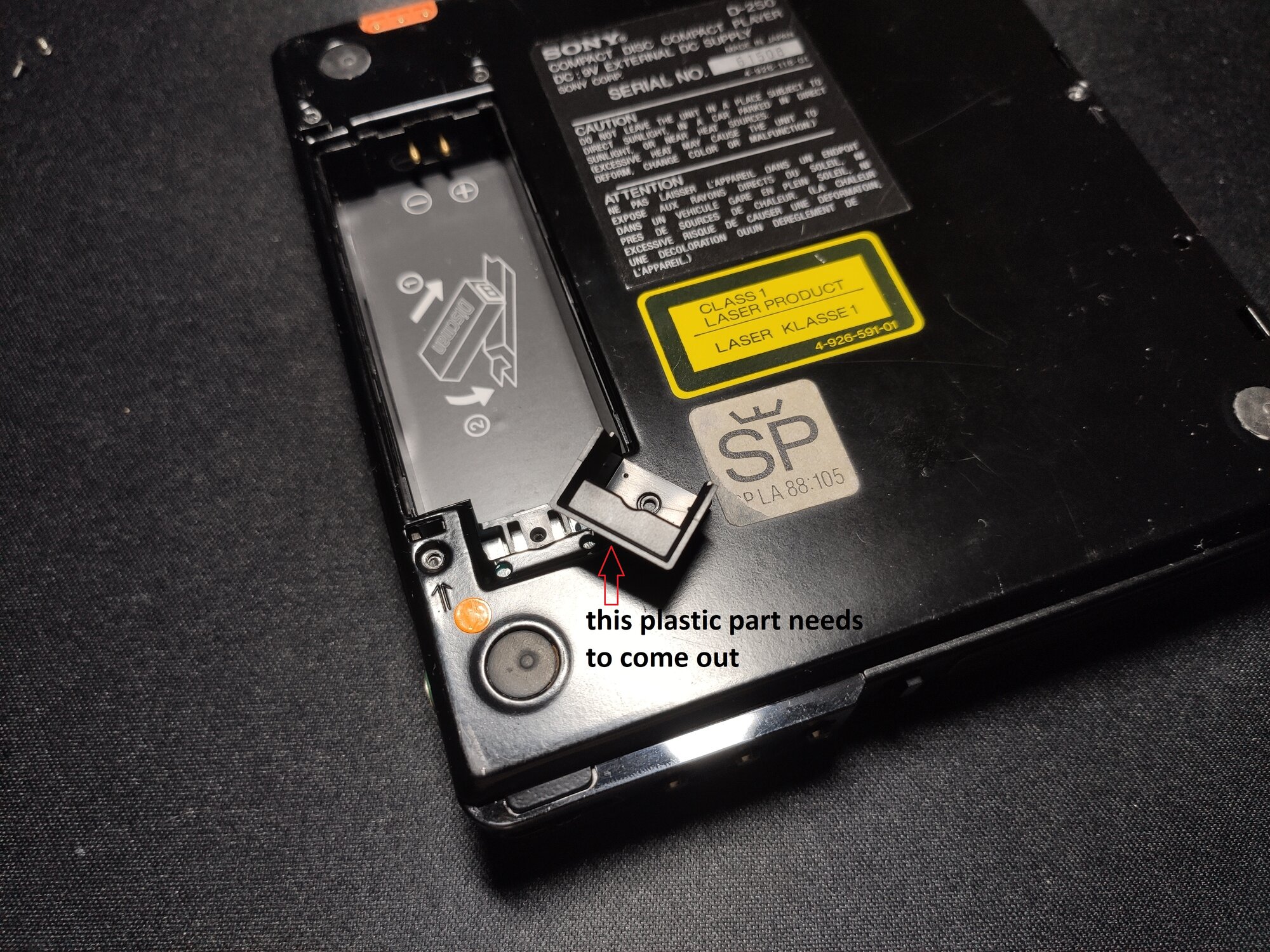

    Now, getting to the point. Disassembling the unit is pretty straight-forward: You need to remove all the marked screws (3 on the side). All of them are the same length, so no problem with mixing them.
    Then the small board with the DC input and LINE OUT jack must come out together with the battery tray.
    NOTE: There is a metal spring that keeps the sled in place, which does not appear in my pictures. That also has to come out, it's latched onto a plastic catch and it can be easily taken out.
    disassembly 1.jpg disassembly 2.jpg disassembly 3.jpg disassembly 4.jpg gears 1.jpg gears 2.jpg gears 3.jpg gears 4.jpg

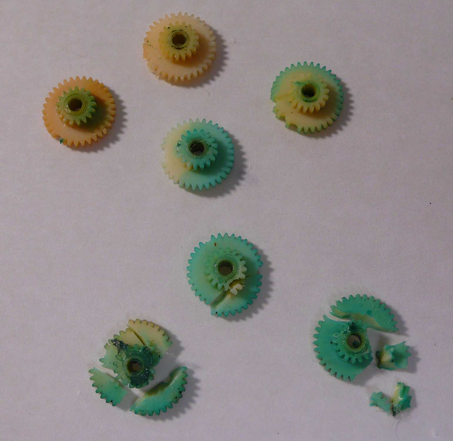

    A few extra points on the OP of this infamous "middle gear":
    About 5-7 years ago when I fell in love with Discmans all I had to do to fix the 'middle gear' problem was as described by @Valentin! Nowadays middle gears in D-90, D-99, D-88, D-555 have 50:50 chances of being totally ruined by bad lubricant used by Sony. Brass pin-lubricant-plastics chemistry at work, see for yourself:
    Plastic gets orange, then green, then crumbles, the one on top was ruined by a previous repair attempt when the Dude scraped it when trying to break it loose...
    So... when you see 'middle gear' going green, buy a new one off eBay! I have a few gears 3D printed (my son designed AutoCad model for ShapeWays, $7 each) but I also made a cast from the Real Thing and the ones I have from the mold I like a bit better - unlike 3D prints they are smooth and a bit softer.

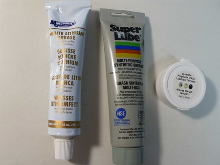

    Lubrication: @Valentin you forgot to mention which lubricant you did use for this infamous brass-plastics! We do know that it was the original Sony lubricant which got stiff and then destroyed the middle gear.
    The one I used for a few years is in the middle:
    but now we know that it gets us into the same troubles as the original Sony oil, so for a few years I did not use any lubricants for brass-plastics at all. The one at right from Nalgene (highly respectable Co in my professional field) is what I am using nowadays, have no idea if it is any good, only time can tell
