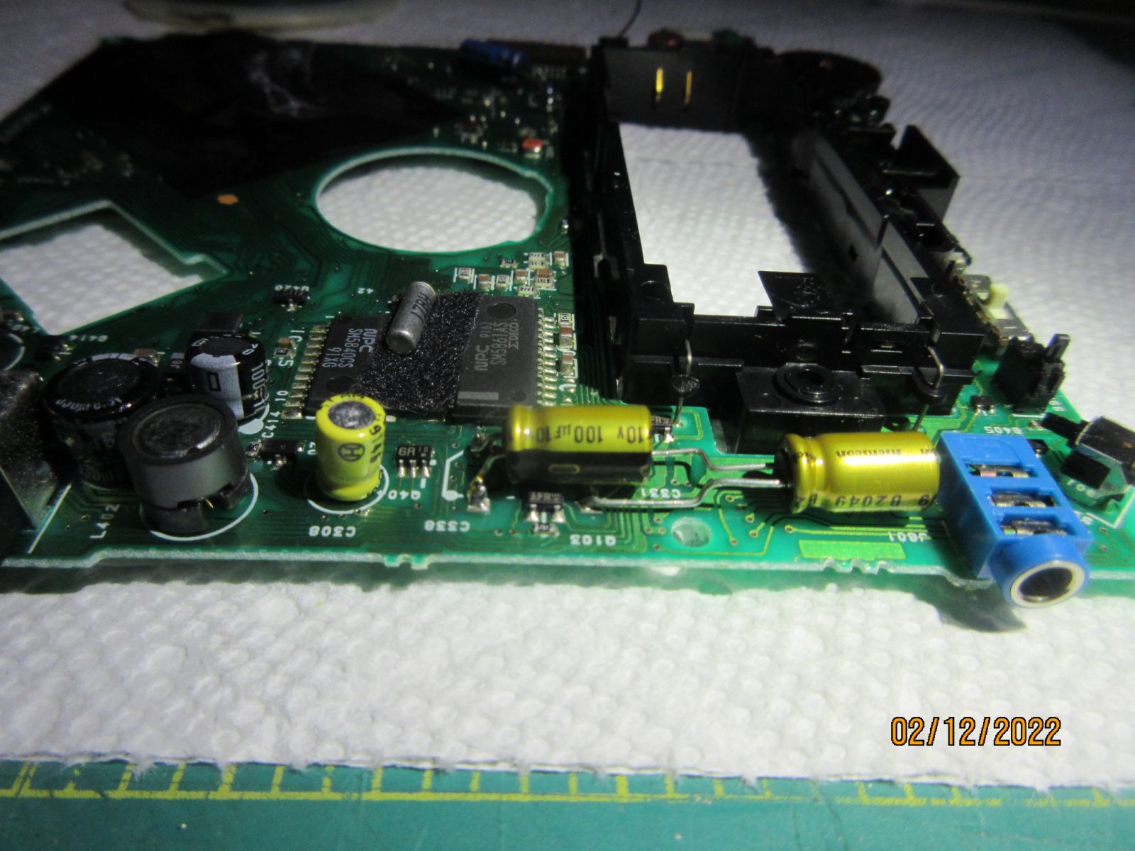

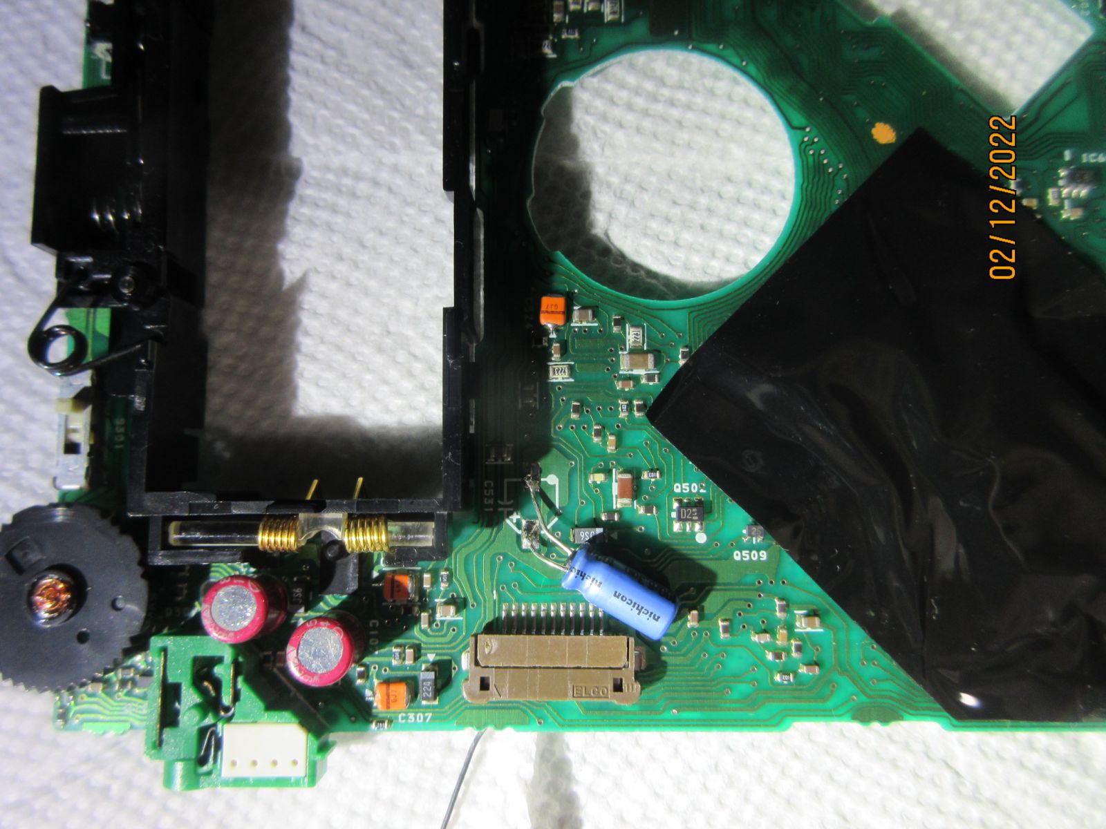

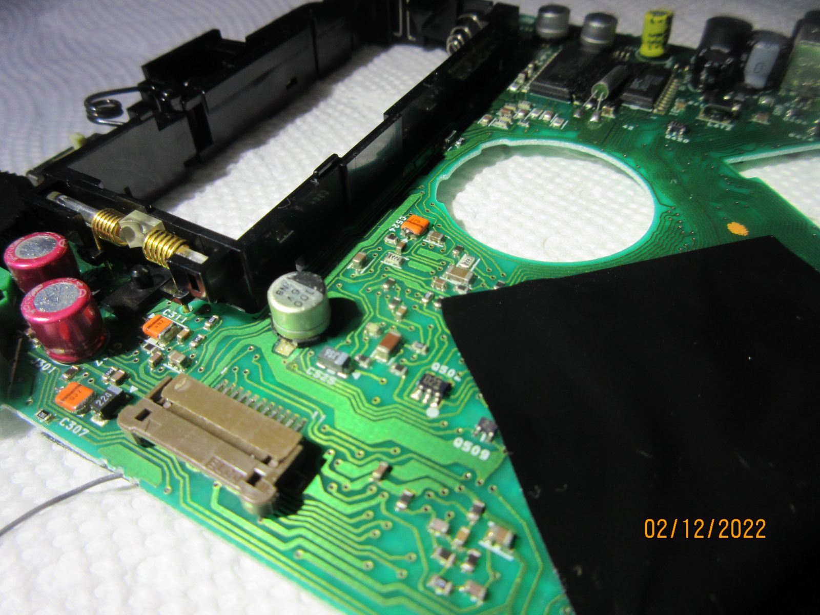

    D303 suffers from the same deadly 100uf SMD aluminum capacitors as the D555 does. And the garbage spindle motor Mabuchi RF-410CH from th D-35 / D-350. The worst of both "classics". That motor needs to be replaced with the $1.50 ebay one Mabuchi RF-410CA. Once the sled and gears are cleaned and re-greased with Teflon PTFE Labelle 106 life can go on. Until those other pesky electrolytic capacitors go bad in the future. The board is packed in tight and some of those values are near impossible to find in such small sizes. It won't be fun replacing all of those one day. I left them alone since they are working.
    Additional motor info: The Mabuchi RF-410CA from e-bay is usually described by some sellers as NOS from a warehouse. They are probably old and definitely have dry bearings. They run scratchy and loud from an AA battery. As soon as they are oiled it goes quiet. They also have a small pinhole oil port leading to the bronze on the back / base bearing. Yes really. Not even the old original motors have that. I fed oil into the pinhole and let soak a few days. It was actually absorbed.

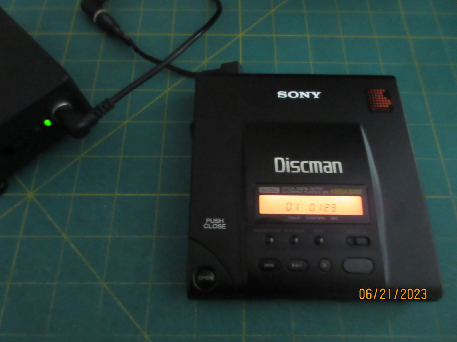

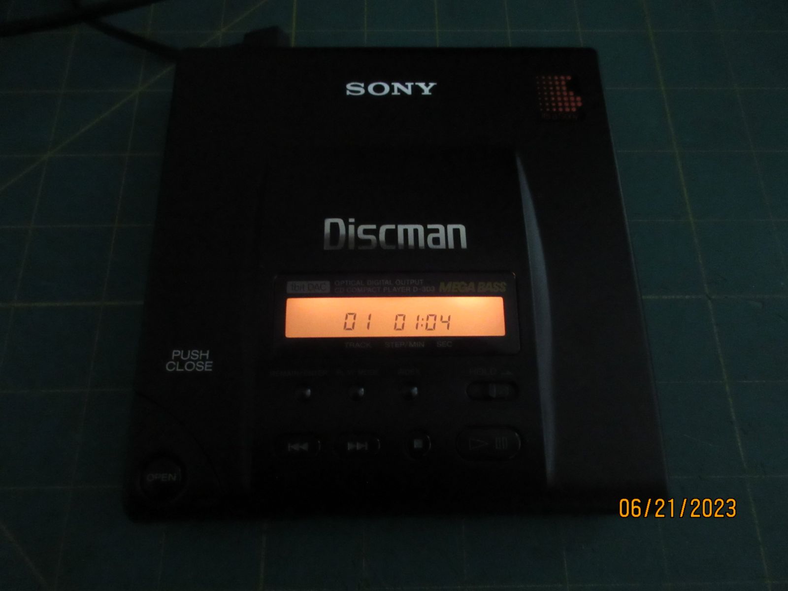

    The D-303 has a good look and style in my opinion. It tuns on 2AA cells as well as the lead acid BP-2EX using the famous little fold and battery holder spring arm. Same as the D-515 would later use. The orange backlight display is fantastic and just plain cool.
    (The later model D-211 would allow the user to momentarily turn on a same style orange back light with a button - even from batteries. Really? With battery only? Not too sure of that one. I got a D-211 later as well... literally just to see if the display worked like that... plus there was a buzz on the forums about 18 years ago about it "sounding incredibly great"... but something went terribly wrong during the re-capping of myriad small scale leaking SMD capacitors... but that's another story!)
    Running from 6AA battery box into the DC9v input jack.

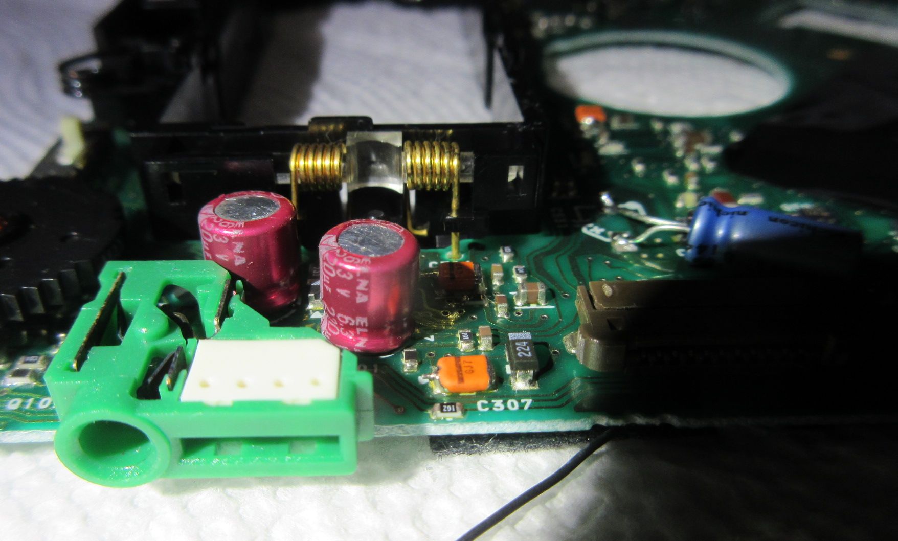

    Look at those funky red Elna 220uf 6.3v capacitors used on the headphone
    coupling! Interesting. They were actually putting some effort into making
    it sound as best as they could... without spending too many extra cents per unit.
    That's just a trace of sarcasm there folks :biggrin:
