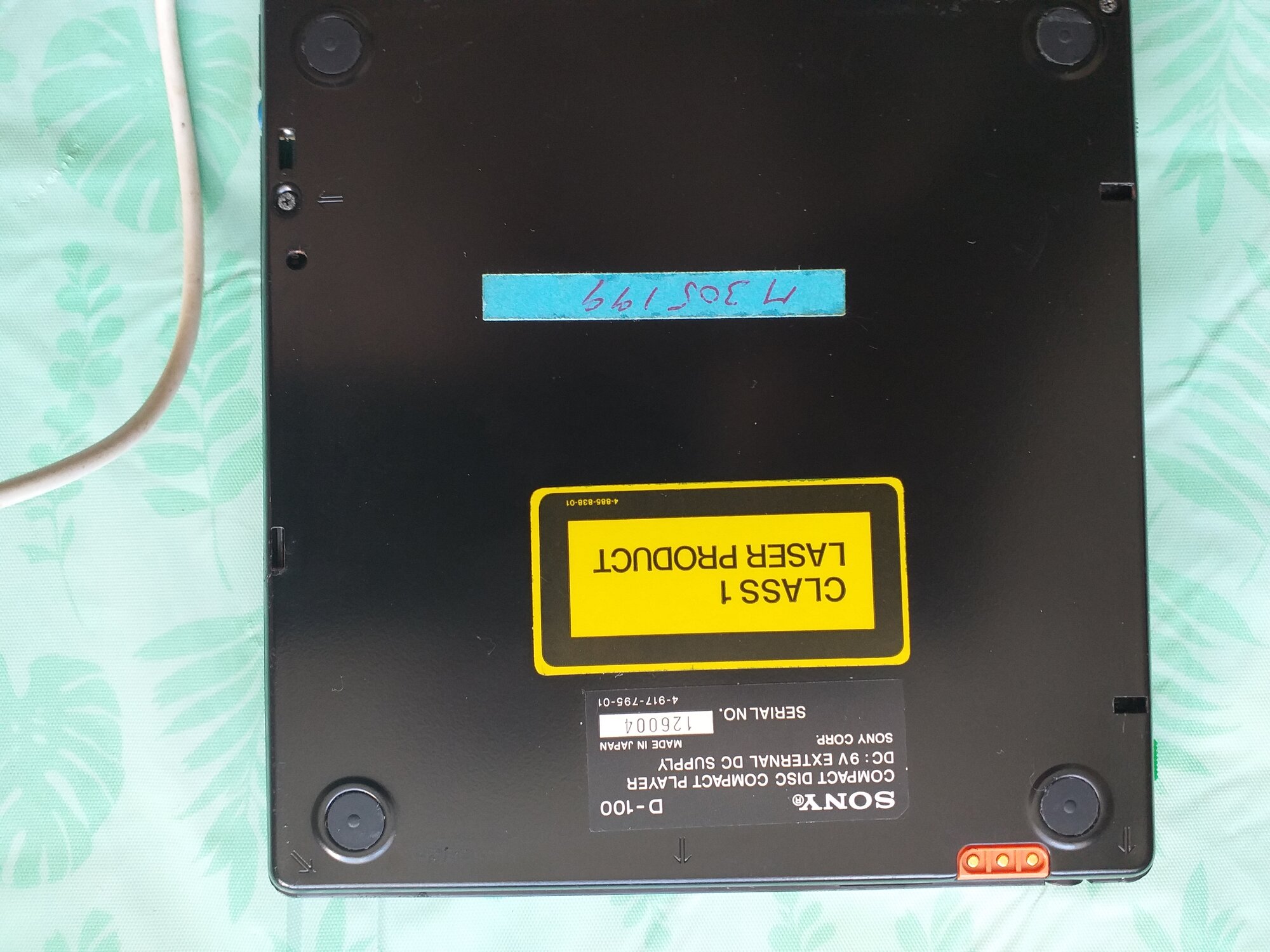

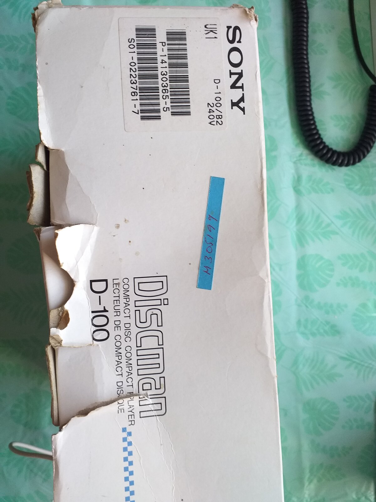

    Just going through my units this morning and noticed this. Several numbers not matching. This D-100 was bought by me from a Sony dealer back in 85/86 when the unit was released. Demonstrating units- then put back in the wrong boxes? Any ideas anyone.

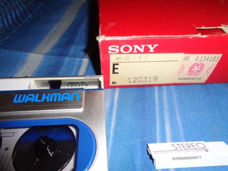

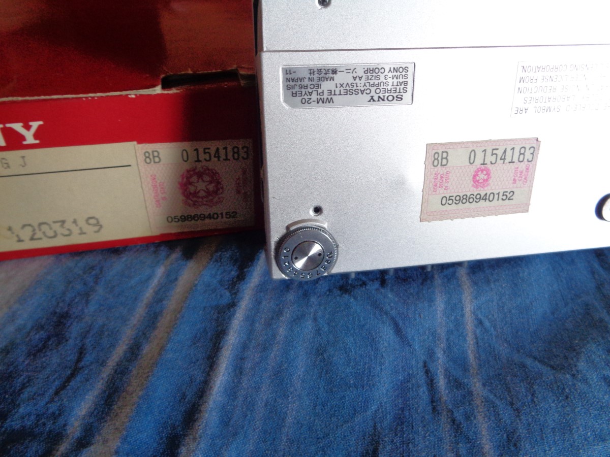

    Hi Derek I have a D100 .. but I don't have the box but I think it's similar to the Walkman ... the dealer probably messed around a bit

    Hi Silver965. I think you're right. Cannot believe I hadn't noticed it before. Unfortunately my unit doesn't work and the two top buttons have come off. Another one of my units I would love to hear again. Is yours working ok? Derek.

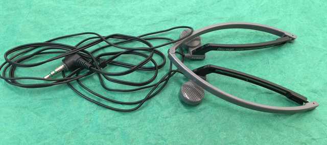

    Can I ask you the model of the headset that originally had in the box ??
  6. Derek marshall
    653
    Kent
    A good question. Just looked through the operating instructions that came with the D-100- and- no mention of headphones, only optional extras.

    Silver965. Looking through the box again I think the original headphones were in the smaller brown box. Folding type but I cannot remember model. Have not got them any more.

    Page 50 of Sony D-10/100 Service Manual mentions MDR-A10 headphones, foldable thingies available for a few bucks off eBay. SM even has Part No. for the grey box @Derek marshall has :)
    I must say that D-10 deserves something better than Sony freebies: it has the most powerful h/p amp ever used in Discmans/Walkmans. Sennheisers HD600 might be an overkill, but anything below that is a good match: HD570 and Beyerdynamics DT880 is what I use with my D-10.
