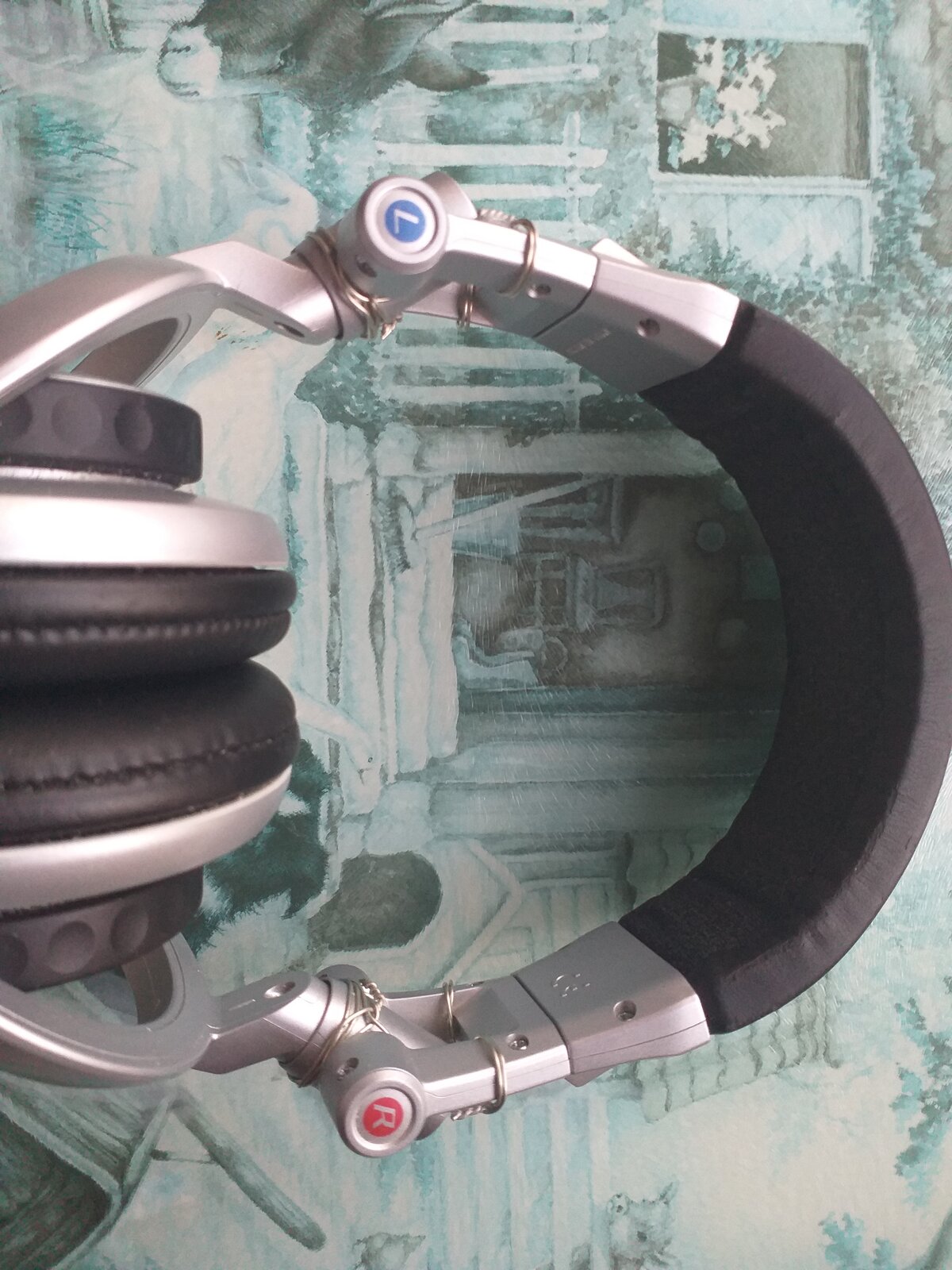

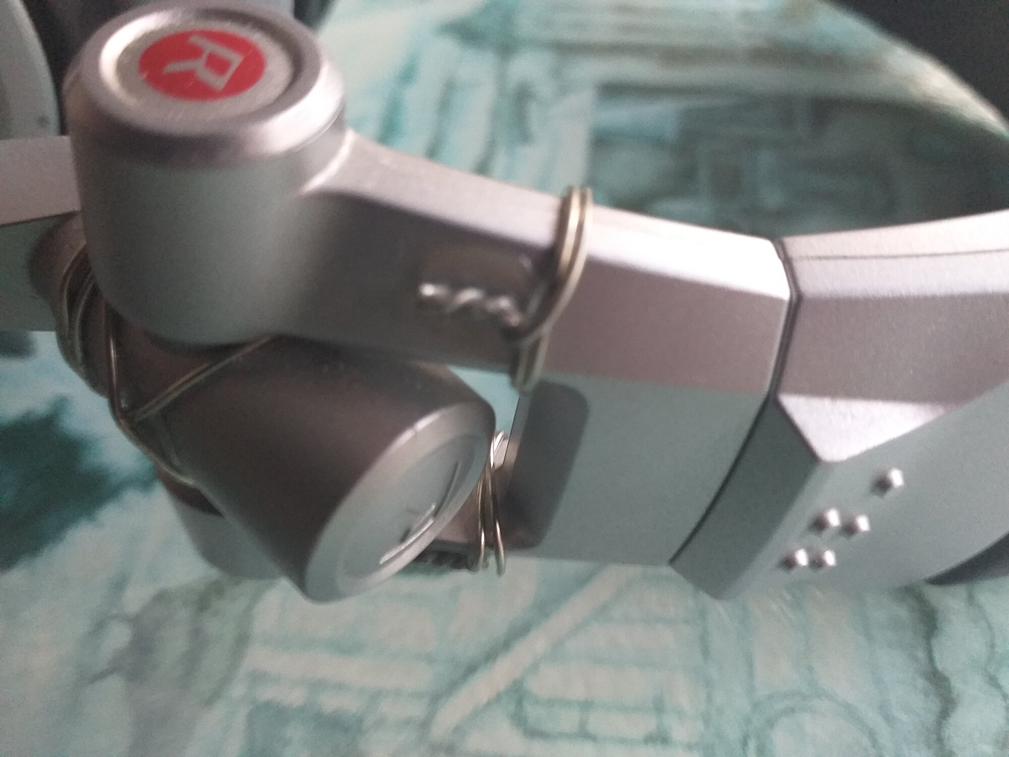

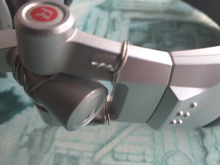

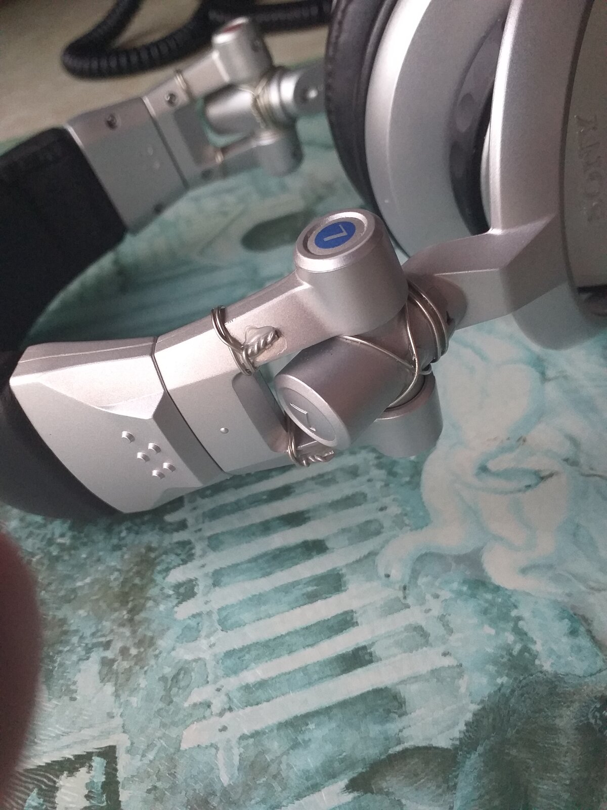

    Sony MDR-V700DJ Headphones. Back when these headphones first came out I bought a pair. Liked them so much I bought a second pair. To a yo e still usi g these phones: I have heard so many stories about these developing a crack which eventually breaks. I'm no DJ and I'm very gentle with my equipment so I did not believe all the hype. Then the other day I noticed a small crack developing near the usual swivel position. I then believed all the stories. Glue/tape is no good to fix this problem so I got my brother-in-law to thread some fine wire around all the weak spots- my second pair as well and he has done a fantastic job- so neat, I hope this has safe guarded these phones for a few more years. So my message to any anyone who still uses these phones is to do what I have done before the crack appears. I particularly like the sound of classical music recorded on a metal tape. I know many others disagree but all our ears are different. I hope this might be of help to music lovers who still use these particular phones.

    Hi Henry pal. Have done it at last thanks to my wife. What do you think? I know it does effect them cosmetically but at least I may have the headphones for a few more years. Have you tried these phones?
