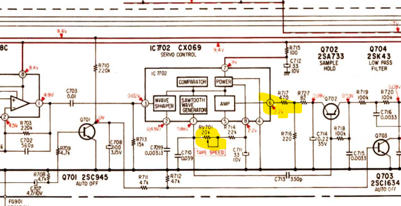

    Hi Folks, I have an interesting problem with a Sony recorder. I just bought a Sony TC-D5 PRO II on eBay and discovered it runs at double the speed for a cassette.
    The potentiometer near the CX069 Servo chip doesn't make any difference when turned. But the resistance does vary on the ohm-meter.
    Why would it be going at double the speed?
    I noticed that the voltage on pin 6 of the CX069 chip should be 2.2V but its 5v. Does that mean the chip is blown or could it be something else? Highlighted is pin 6 of the chip. Also highlighted is the tape speed potentiometer.
    The chip must be working to a certain extent if the tape is actually running (but at too fast a speed).
    Any help is appreciated.

    @MICHAEL MURRAY The symptom you are describing is typical of a servo IC failure. The other thing to be checked is the FG amplifier (on the left of the picture, partly visible).
    Check what you get on pin 3, prefferably with a scope. You should have a signal with frequency of 860Hz or so. New old stock replacement ICs can be found on ebay, so it's not a really big problem if it's burnt.
    NOTE: A sawtooth waveform should be present at pin1 if servo IC is working correctly.
    EDIT: The 860Hz frequency mentioned will be on a good working device, which plays at the correct speed. In your case, the frequency will be higher, but if FG coil and FG amp are good you should get a signal, that's the point.

    Hi Valentin. I am getting a sine wave signal of 1.8 Khz and every so often it hops to 2.2 Khz.
    Does this mean its the Servo control IC needing replacement?
  6. Valentin
    1,641
    Yes, given the voltage at pin 6 is 5V instead of 2.2V. The fact that you are getting a sinewave at pin 3 does indicate the FG coil and FG amplifier are indeed working correctly.
