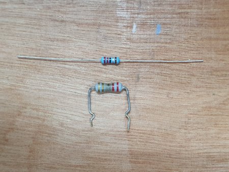

    Problem solved. Dead resistor on 14v rail. Deck is up and running again:nodding:
