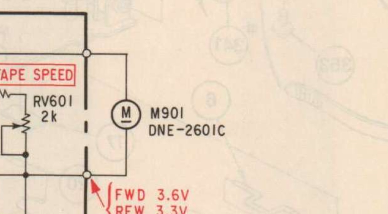

    Can anyone help me out with the model number of the motor fitted in the Sony WM-1 personal cassette player?
    Or a suitable alternative that I can use.
    Cheers, Ant.

    Thanks for that the motor shows part number 8-835-028-11 which I still cannot cross reference with anything available. It is the same motor that is fitted to Sony TCS-300 if anyone knows a replacment motor for that one instead?

    That motor looks bad, I would simply replace it with another one.
    While it might be repairable with a lot of work and patience, I don't think it's worth spending the time on this one.
    Would be useful to get a manufacturer part number for the motor, as I'm pretty sure the motor isn't actually manufactured by SONY but by a 3rd party.
    With that code, it will be easy to search for a new replacement in the same form factor and similar characteristics.

    That's exactly what I am trying to find out - compatible replacement.
