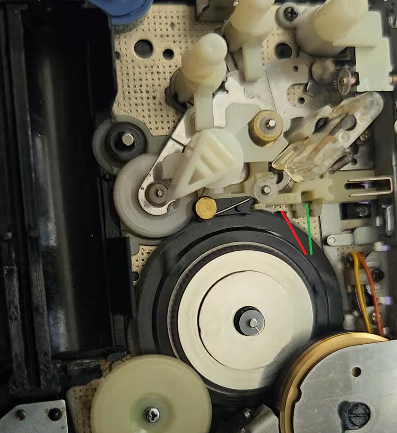

    Note there is a black lever that needs to go into the white plastic slider. You need to remove the plastic slider again and install it with that lever in the position marked green.

    Thanks! That did fix another issue I had with the play not working every once in a while! However, the rewind is still having the same problem.
