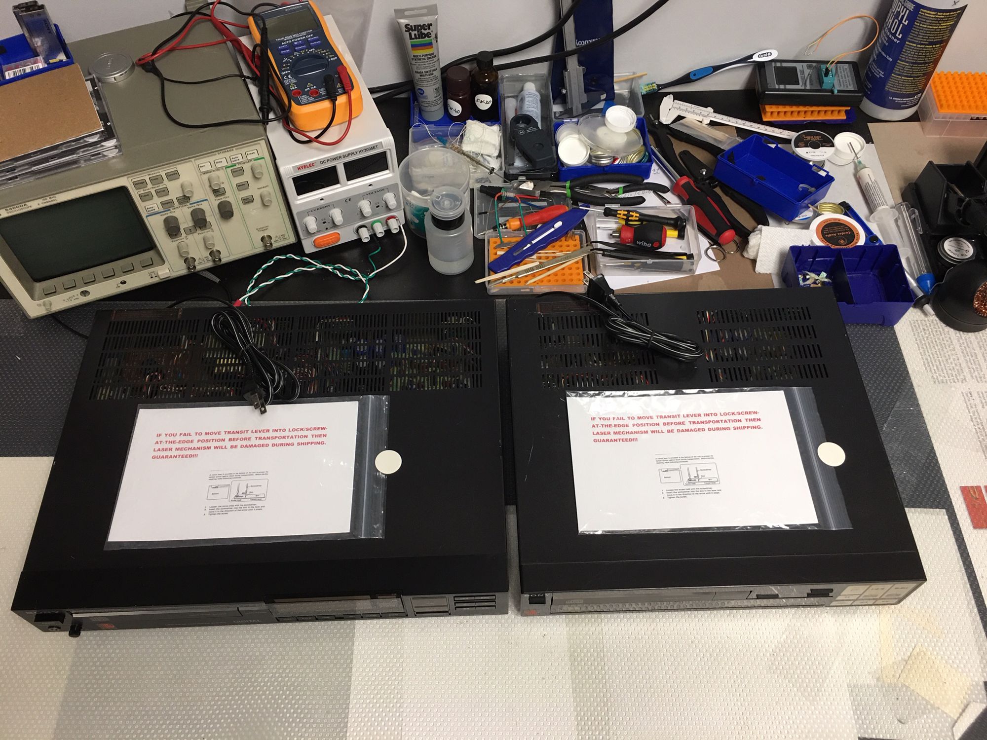

    A few days ago I finished restorations of Sony CDP-102 and CDP-302 for my neighbor, here is a photo of the oils used:
    Hamilton Gastight syringes with 25G blunt needle is pretty convenient for precise application of 5W30
