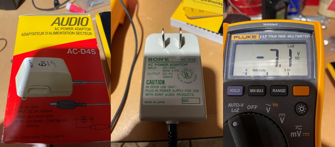

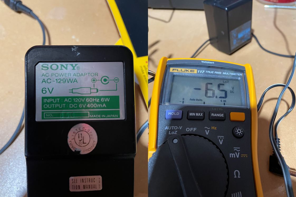

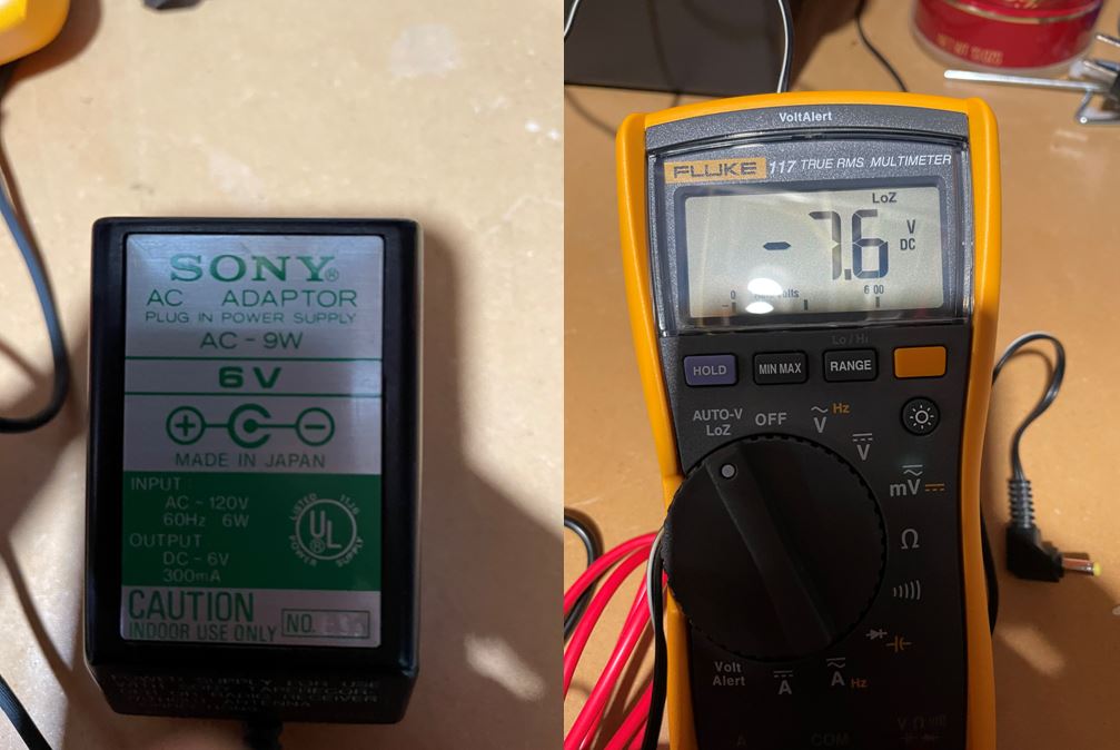

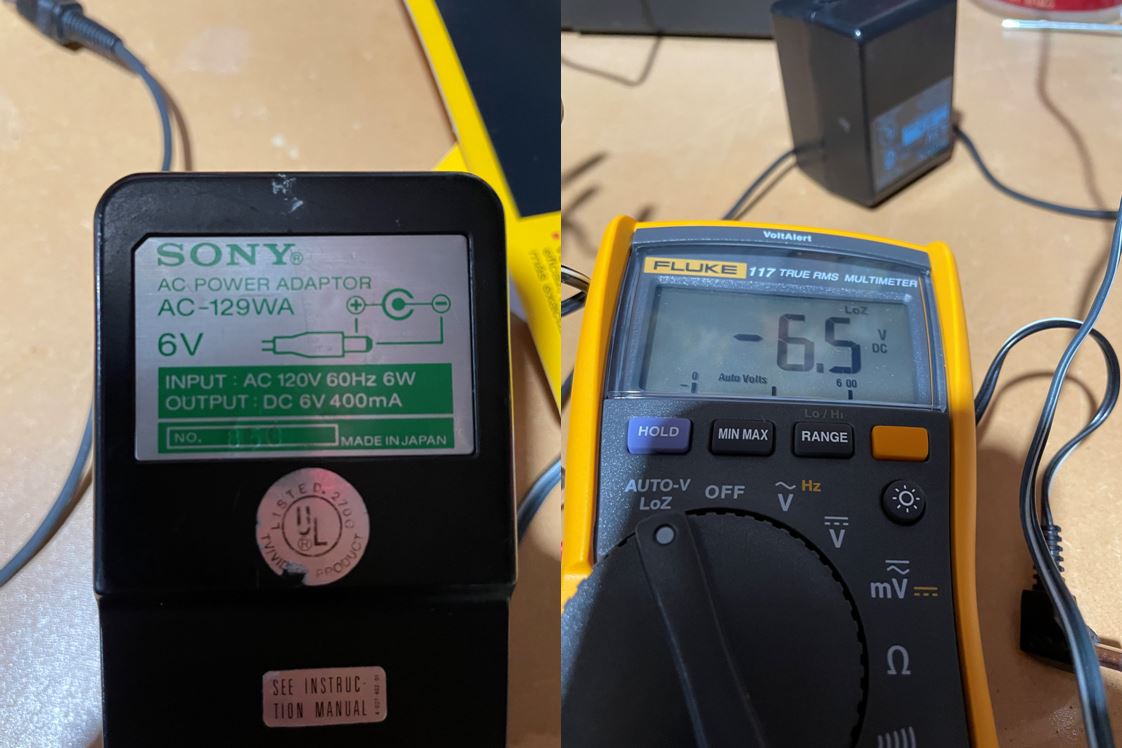

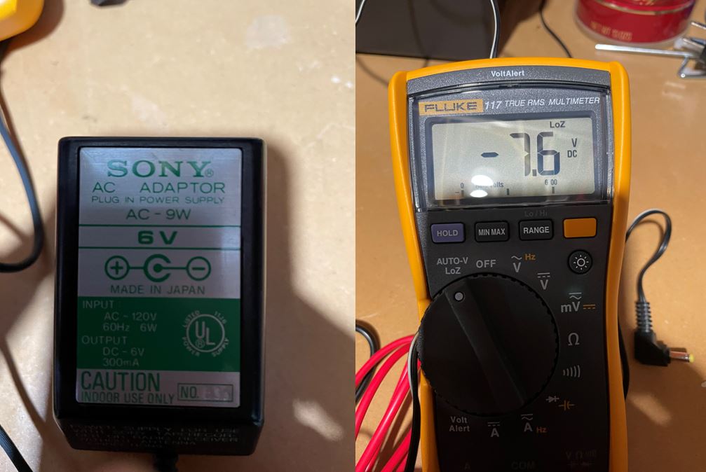

    Sony “6V” plug top supplies – may be higher than 6V.

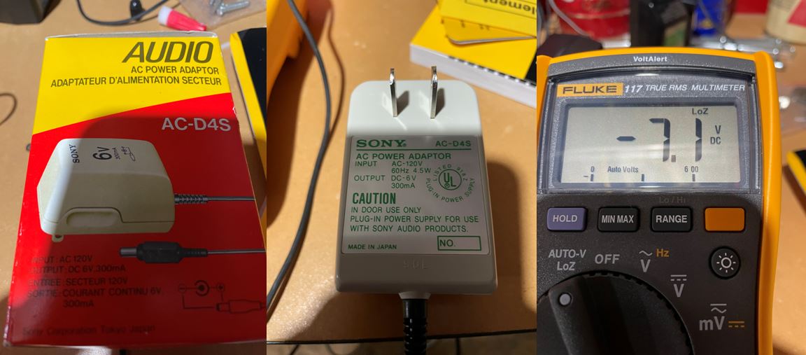

    A customer in the United States has a few of these and tested them with his Fluke meter. The results were an eye opener. The voltages you see here are the voltages which will be applied to the CX20084.

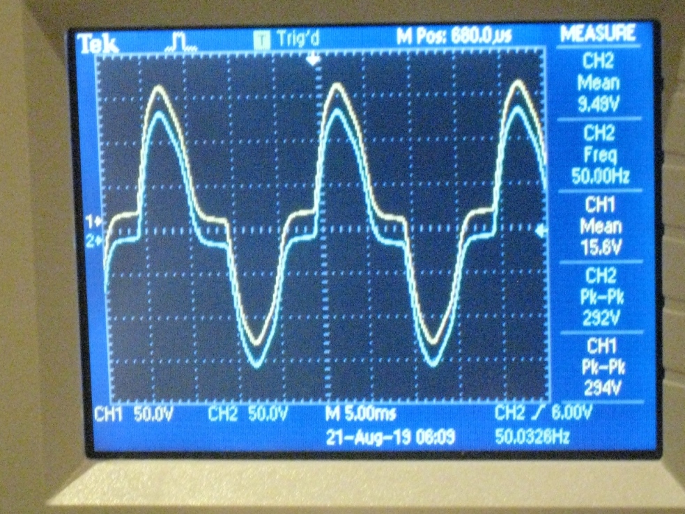

    Increased use of switch mode power supplies.
    The WM-D6C was designed in 1984 when plug top supplies were mostly of the linear type. These deliver a smooth regulated voltage. By the late 1980s, with the growth in home computing, switch mode supplies were becoming more commonplace. These are smaller, cheaper to manufacture and more efficient. Throughout the 1990s and beyond, switch mode supplies became the standard.
    The downside to switch mode supplies is that the DC output side is not totally isolated from the incoming mains. There is a class Y capacitor connecting the primary and secondary sides of the transformer, which provides AC coupling. This is to suppress RF interference. This results in a common mode high voltage (up to 290V Pk-PK in the UK) low current signal on the DC output plug. Because of the very low current it won’t produce a noticeable electric shock but it will destroy a CX20084 instantly.
