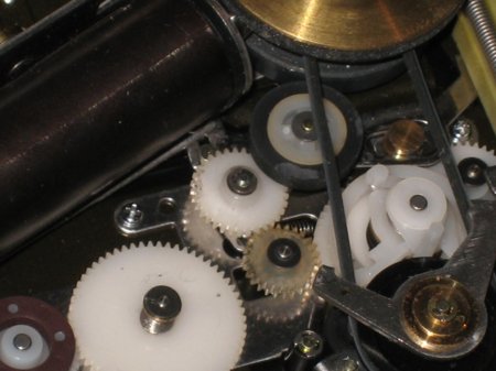

    Earlier, I took some photos of the mechanism on a D6. I'll upload them anyway for future reference.
    Stopped
    FF engaged
    REW engaged

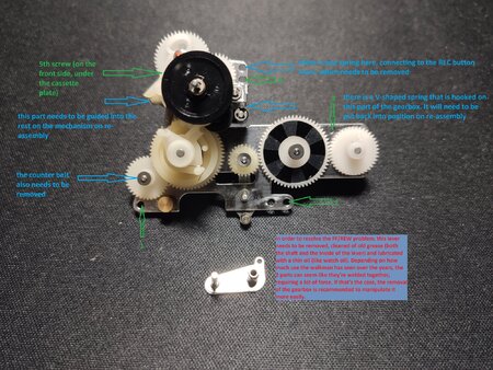

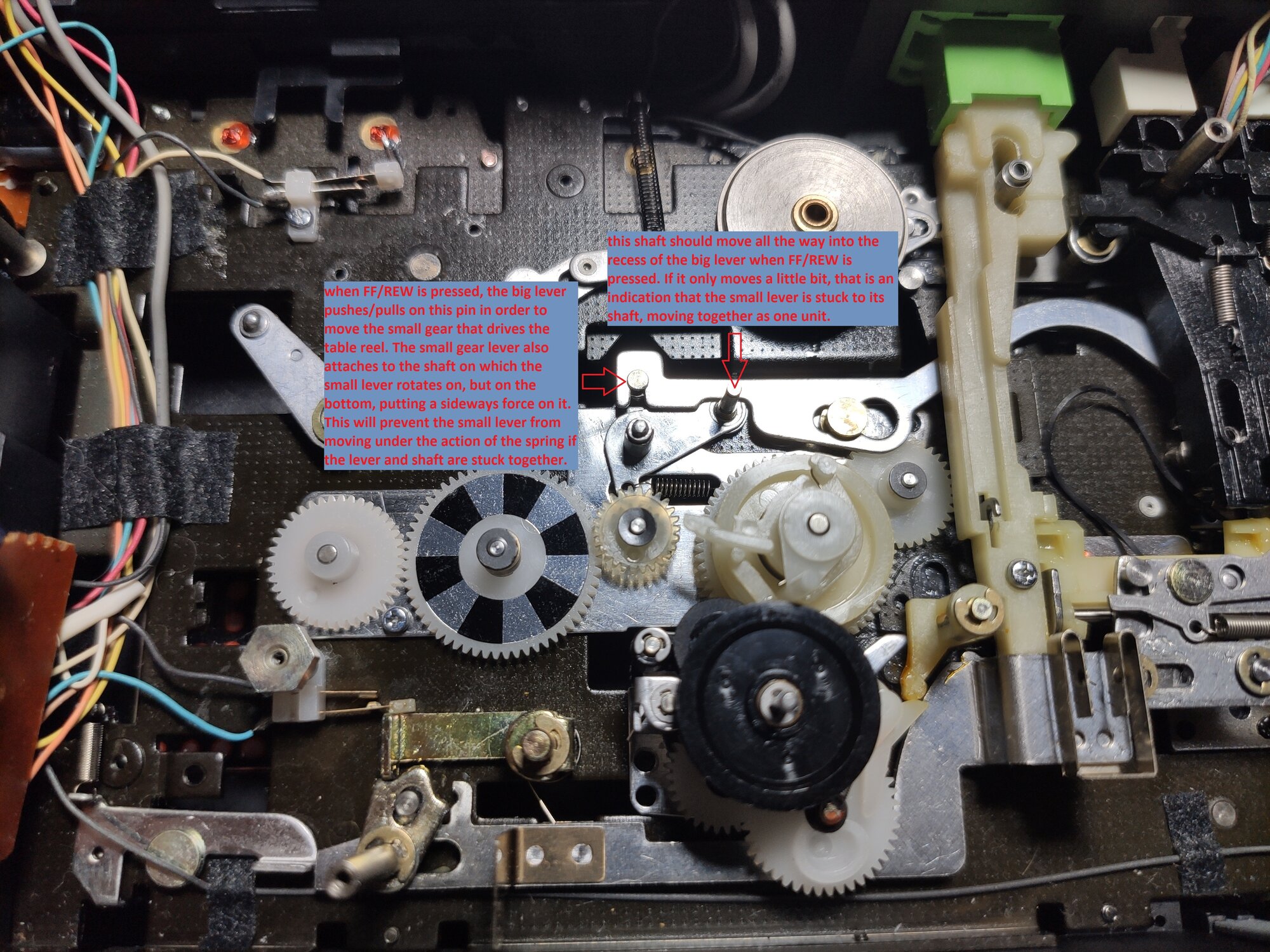

    I took some additional pictures on a unit that I have repaired with this problem, to illustrate the situation in more detail.
    What happens is the small lever (the one holding the rubber tire) gets stuck onto its shaft. The shaft also rotates from the bottom, as there's a second lever that mover the small gear that drives the table reel.
    What may happen is: you put oil under the lever, move it around and at some point think that the job is done, as it will seem it moves completely free (in STOP mode).
    However, when you put the unit into FF/REW you will notice, the lever does not move low enough (and the tire still does not come into contact with the flywheel).
    When you will try to move it by hand, you'll see that it does not move free under the action of the spring. This is because the lever and its shaft move as an assembly and that assembly will have a lateral force on it, preventing it from moving freely (details in picture).
    To solve the problem, the lever needs to be removed, cleaned of hardened grease and lubricated with a thin oil. For doing this, I use a pair of pliers on which I stick some electrical tape in order to avoid scratching the lever.
    The green and blue arrows indicated what needs to be removed in order to take the gearbox out. Depending on the severity of the problem, that may or may not be necessary.
    The big FF/REW lever coming from the buttons also needs to be slided out, but that's pretty straight-forward, so not shown in the picture.
    NOTE: This problem appears on other walkmans sharing similar mechanism: TPS-L2, WM-3, TCM-600, etc.

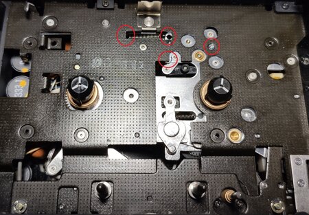

    The white gear next to the idler tire is held in place with a C clip, not a washer. I marked another 3 C clips which can be better seen for reference as how one looks like. Those need to be pried with a small flat head screwdriver: you can put the head of the screwdrive in one of the 2 gaps and rotate while holding the clip with a fingernail.
    Of course, it is to be mentioned for having decent space, the flywheel and motor should be removed at this point. And be very careful keeping a fingernail on that C clip, cause it can fly out. You can also put some tape over one side of it, so you still have room to pry it out, but it won't fly.
    Also note there are 2 anti-friction washers (black) on that white gear: one is below the C clip, one is on the back side. The one on the back side usually remains in place, but the one above can be lost if one does not pay attention to it.
    As for fixing, I do fix walkmans. However, on a unit like this it is recommended to do a complete service: replace rubber, lubricate all rotating parts in mechanism, make electronic adjustments. For more details, send me a private message.
