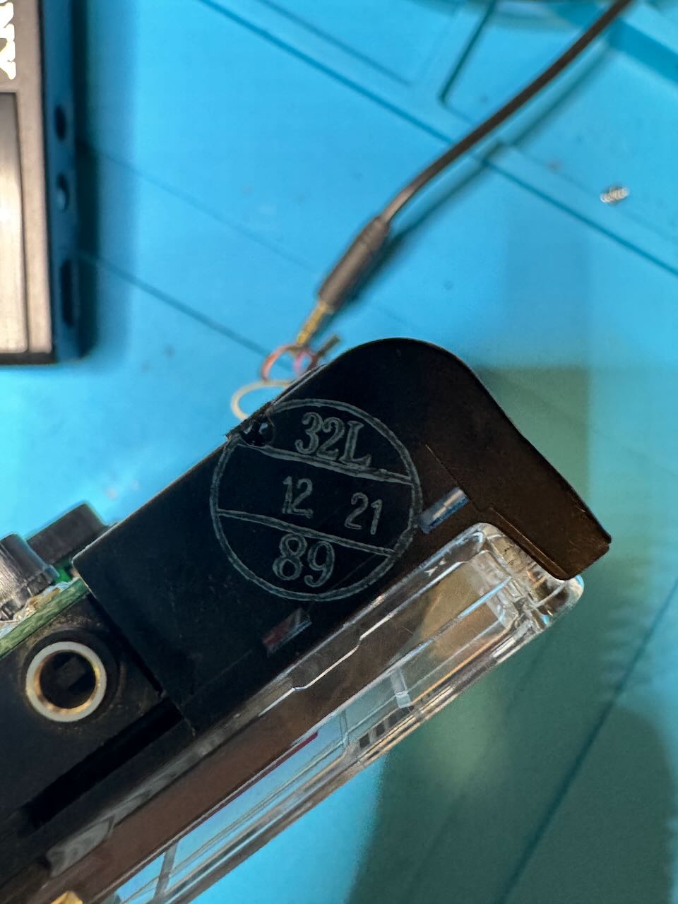

    If I recall correctly the DC2 was introduced 1984, do anyone know how long it was in production?
    The reason for asking is that I just renovated one that has something that looked like a production date inside, see picture. If that means 1989 it seems way too late for this model. I was also surprised that the Dolby levels didn't need adjustment so I'm thinking if this has been fixed before and maybe replaced parts? I couldn't see any traces of that though.

    That stamp with date I think is factory. Seen it on other DDs in a similar location, but also some have a very similar one on pulleys or flywheels.

    As for Dolby levels, usually later models are adjusted properly but the the possibility of levels being re-adjusted before can't be excluded either. However the 2 (levels and date stamp) are not necessarily connected.
