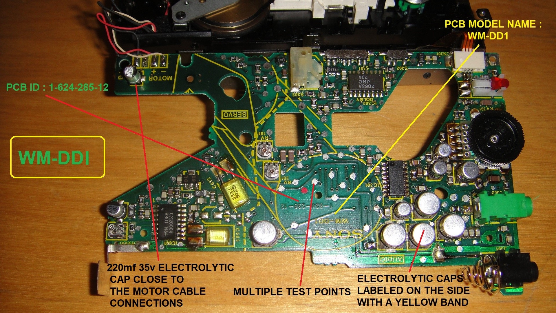

    WM-DDI
    PCB ID : 1-624-285-12 circa 1988 ,
    these caps with the yellow band seem to be prone to leakage , in my walkman above need replacement.

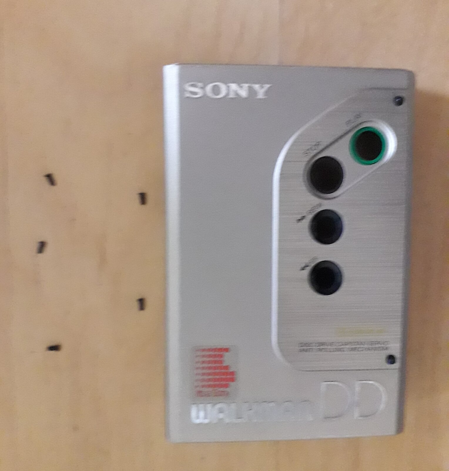

    EXTERIOR DIFFERENCES :
    SONY WM-DDI on the left SONY WM-DD10 on the right.
    Altered button frame on WM-DD10
    WM-DDI horizontal aluminum brushing lines on the button frame .
    WM-DD10 brushing lines following the angle of Play-Stop buttons .
    WM-DDI : "DOLBY NR" , WM-DD10 : "DOLBY B" , both with yellow printings and the Dolby double D symbol , from technical point of view is exactly the same Dolby system.
    In all documentations and on the walkman it's DD I and not DD 1 from the Latin number one : unus , although if you noticed in all PCB versions we read WM-DD1 !
    Most likely the cases on my walkmans are original , DD10s case has still the second indentation for the protective peg while DD10 has only one peg . ( if you know about a different dedicated DD10 case , or can confirm , please let me know )
    The tape direction arrow is smaller on DDI .
    "CASSETTE PLAYER WM - DDI" inscription on DDI cassette door.
    "WALKMAN DD" inscription on DD10 door.
    DDI cassette door has a brushed aluminum logo , on DD10 is just printed :
    DD1o : side middle screw shorter
