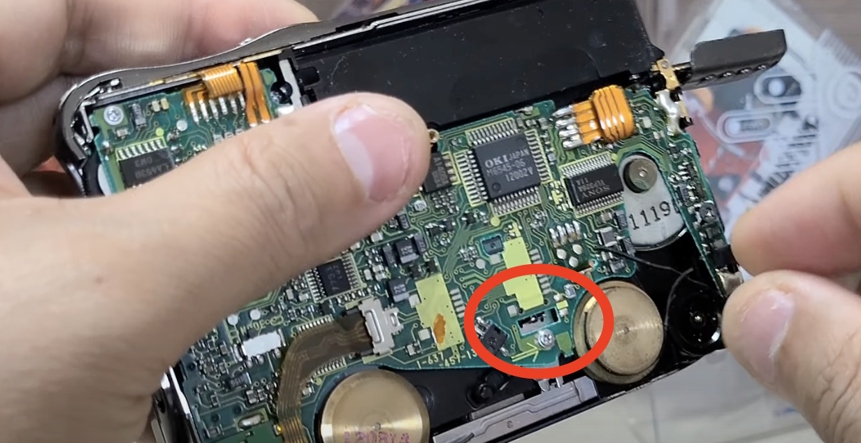

    2. Did you make sure the tape position switch was lined up with the mechanism? It's a small switch on the motherboard that gets moved by the tape mechanism as it changes. It must be lined up with the grooves in the mechanism. See the red circle in this image:

    OK, I see what you mean on the Tape Position Switch in your photo. I seen that guy on Youtube play with that switch area you have circled in Red. But didn't really know. When I have more time I will get back to this and your notes.
