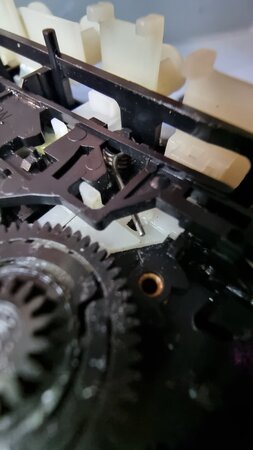

    You are a champion. What great eyes you must have! I didn’t see that end of the spring (not that I knew what to look for really). Tomorrow I will have a go at removing the bar and then I should see where that spring end goes … seems to be right under the bar and I can’t tell where. The fast forward one I can see when pressed but not the rewind.

    A few more pics showing fwd spring in place and can just see Rewind spring not located correct.

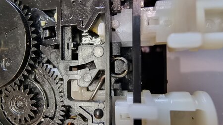

    And marked up pic.. I am guessing the spring should be where my red line is and not the red dotted line as it is at the moment . This is when the Rewind in pressed in.

    Yes the spring should be about where the red line is, I agree.

    I see that the plastic pin that holds the spring end works kind of. I think it is worn and the spring leg slips over.
    Not sure of the next step to fix it. Can you glue this type of plastic or melt a bit more plastic on top of the pin to build it up. What do you think? It's in a pretty tiny area to get to.

    What I would do is take the spring out and, with a small pair of pliers, bend the end of it down so it comes more into contact with that plastic pin.
    Would do this on both ends of the spring just so I avoid any future need to disassemble again.
    The pin itself I would leave alone given it's on the edge and it's made of plastic. No glue will hold, the force of the spring is too high.
    Melting plastic on top, though stronger, will still not hold without a metallic insert: either a melted copper wire or a screw, but given it's right on the edge there's not enough support to do that.
    There's really not much you can do to the pin itself, hence why it's best to be left as is to prevent any further damage.

    I cleaned any grease off the spring leg, in case that helped it slip off the peg, and pressed the leg down with a precision screwdriver to bend it a little lower. Doesn’t really look like I bent it much at all, but now the reverse button works, so it must have been enough.
