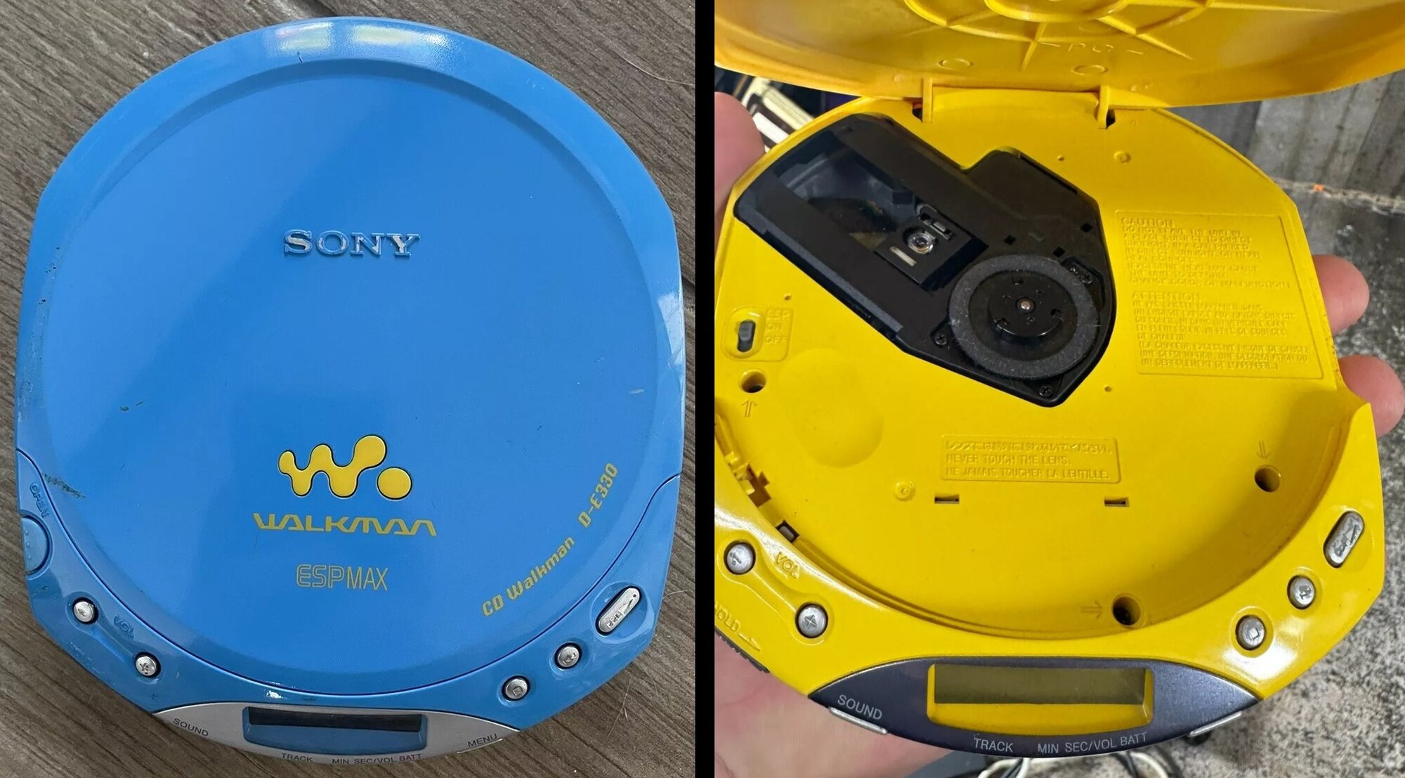

    I'm curious if anyone else has swapped any lids of Discmans before.
    My girlfriend is from Kazakhstan and their flag is a sky blue field with a yellow sun in the middle. I was thinking it might be fun to give her a D-E330 with a blue body and a yellow lid (I would, of course, keep the yellow body and the blue lid, in case I ever wanted to return them to original configuration).

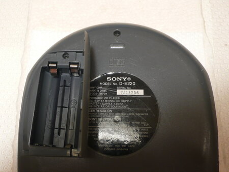

    Switching lids is very easy but if you are afraid to break anything then leave them alone, brute force is needed to separate lid from the case . Otherwise it is a 5-min job.

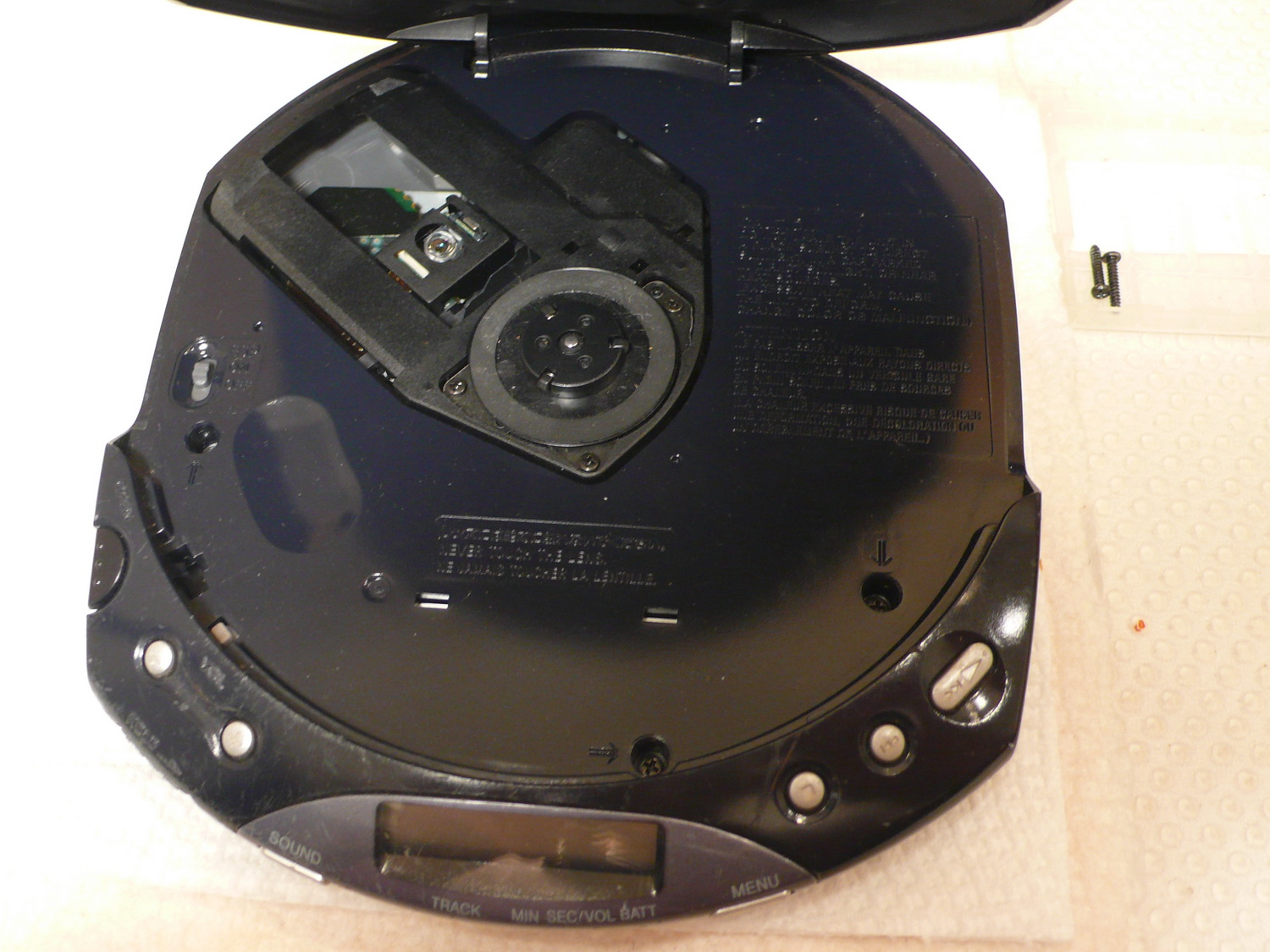

    Two screws from the bottom and three from top, marked by arrows. Ph0 screwdriver is needed:

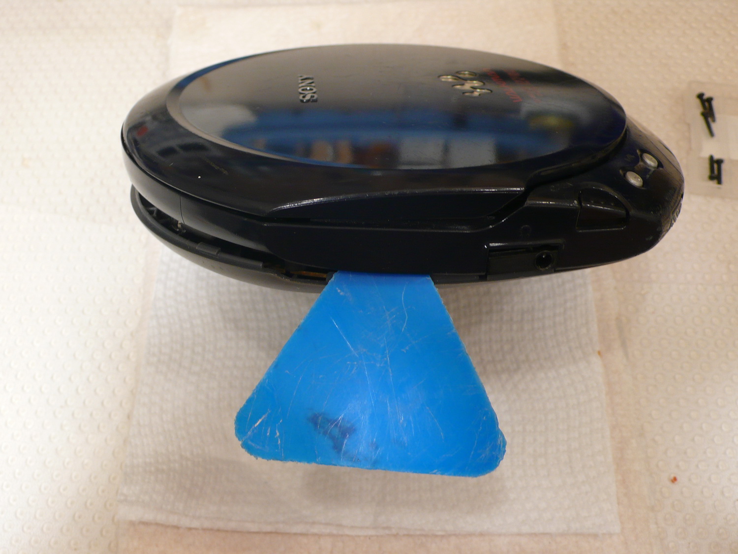

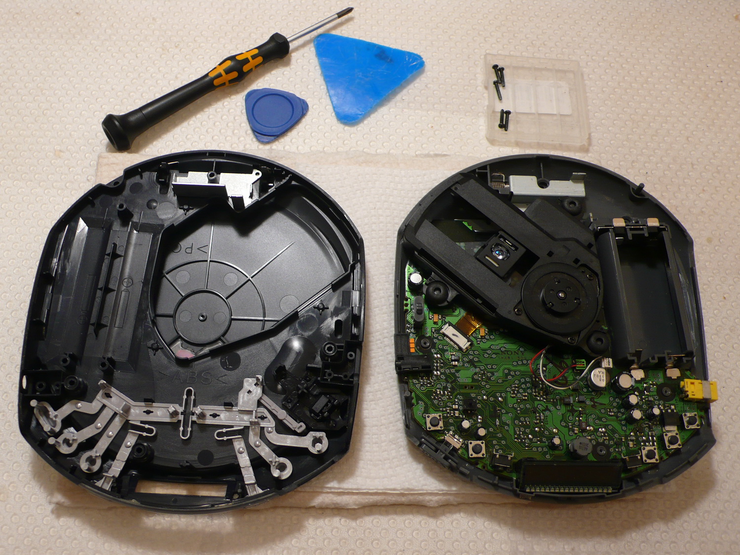

    now shell is held together by plastic clips, use old Credit Card to separate:

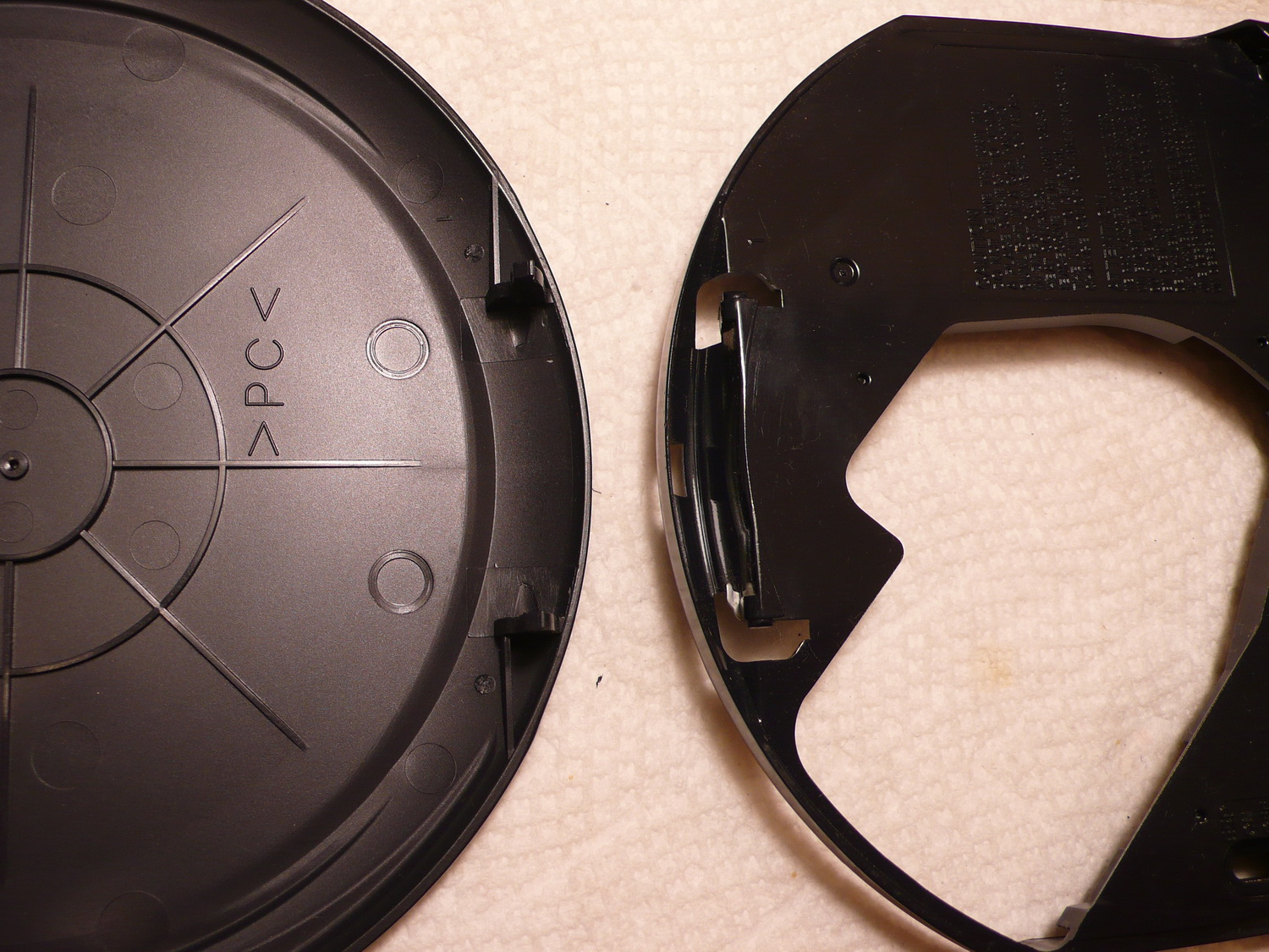

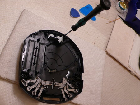

    now use small flat screwdriver to separate lid from the case. This is the step where brute but controlled force is needed:
    One last tip - when snapping everything back together, keep the lid open, otherwise pop-up spring won't get engaged
    Good Luck!
