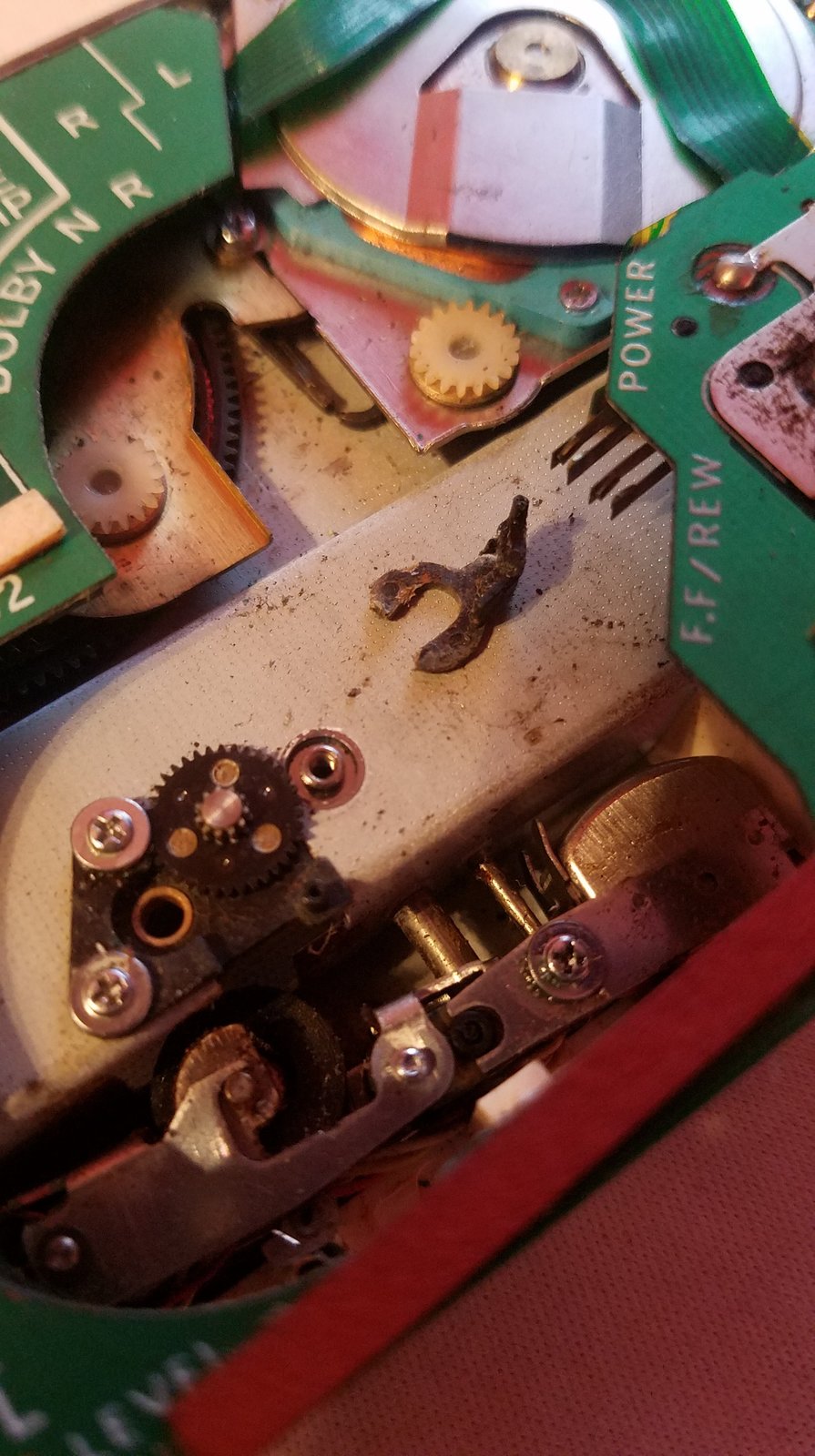

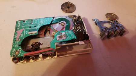

    Thank you!! This was a tremendous help! I managed to get the transport off and I think I found my culprit. A small metal price was wedged in there. Although I don't think its the end of the problems for the pinch roller. It looks like the pinch roller is not even attached. Like some kind of spacer for the inside is missing. Although that piece was stuck inside that space.

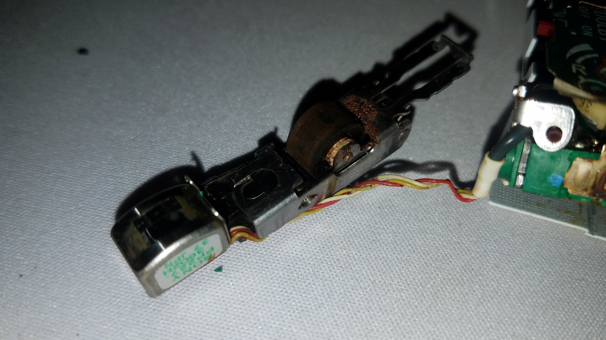

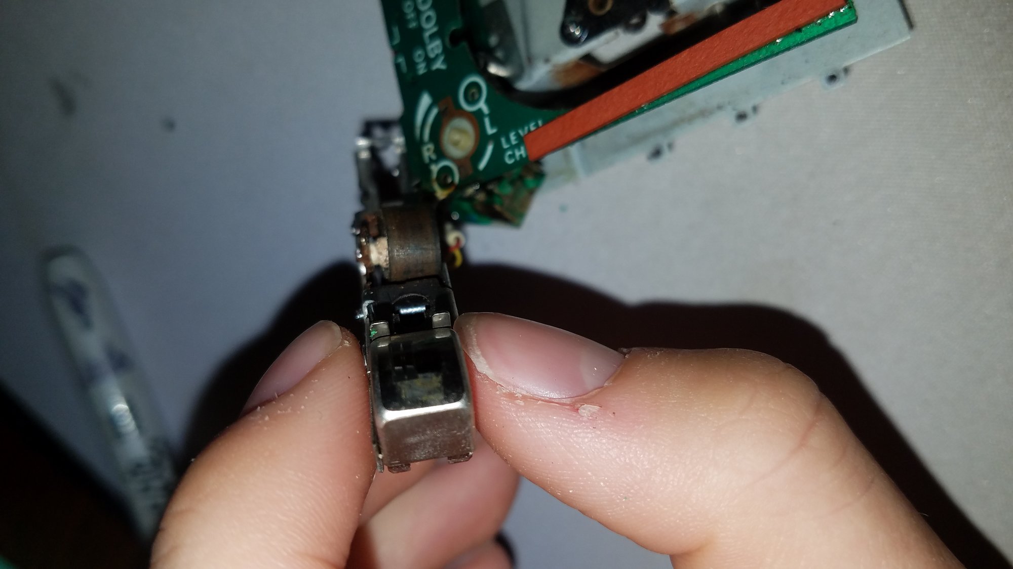

    Got the head chassis off and the pinch roller is totally dead. The rubber is moving around the plastic and doing whatever it wants.

    I encountered the same problem as well, so I just hammered out the axle to clean everything and sand them smooth. It was quite fiddly to put back together, but it works fine now with new rubber for the roller.
