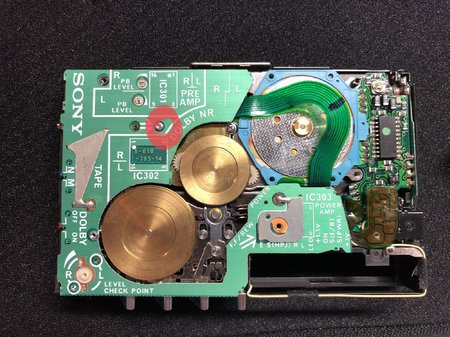

    Thanks for your input! The parts unit arrived, and I thought it’d be a good opportunity for practice in dissembly. Is there a trick to removing the screw circled in the following picture? I can’t seem to loosen it on either unit, without fear of completely stripping it. I am assuming that this has to be removed to get the main board separated.
  8. Boodokhan
    2,476
    You can unscrew it, no need for any trick :wink:

    Except it’s stuck on both units, about to strip. I’m about to give up on this one. The ex102 from my youth may not be as detailed, but at least it’s servicable.

    ive used small handheld saw and dremel in the past to turn stripped screws into phillips flatheads.

    Thank you for the recommendation. I have a set that includes those bits. I'll try again soon. In the meantime, I picked up a restored DD33...so I've kind of lost motivation for the time being.
