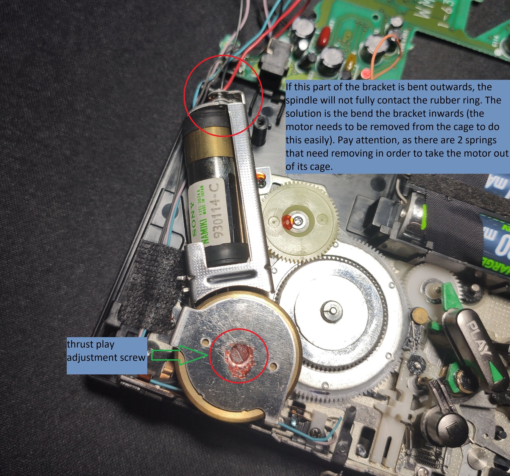

    There are 2 methods of adjusting the trust play:
    1. By measuring the current draw of the unit (the service manual method)
    You need to insert a multimeter in series with the battery terminals or DC IN jack (pay attention to the center negative and use a voltage a little lower than the rating). With the walkman put in PLAY mode, observe the current draw as you gradually tighten the screw.
    You will reach a point when the current will suddenly increase (because the play becomes zero). You need to stop at that point and rotate the screw a quarter of a turn (90 degrees) backwards and lock it with lock paint or super glue.
    2. With a feeler gauge
    Put a 0.05mm feeler gauge between the flywheel and the back of the adjustment screw. Adjust the screw so you feel just a little bit of drag when you move the feeler gauge around. Lock the screw with lock paint or a little bit of super glue.

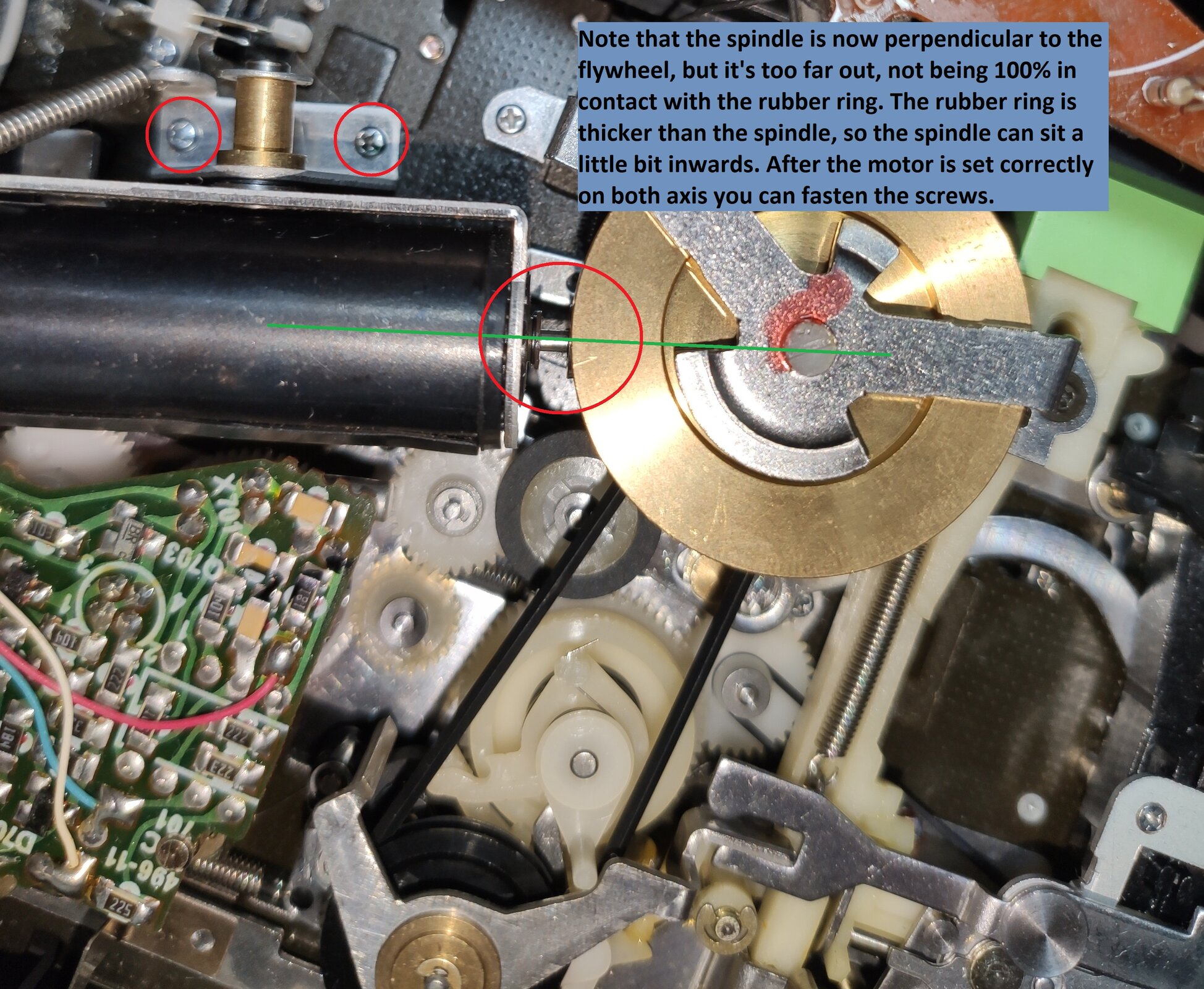

    There are 2 axis on which the motor needs to be checked/adjusted.

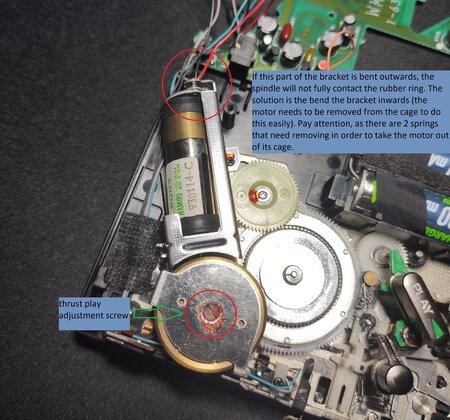

    1. Up/down movement relative to the flywheel.
    The position should be so that the spindle contacts the rubber ring fully, but it shouldn't be so inwards that it starts to have contact with the metal part of the flywheel. The rubber ring is wider than the spindle itself, so there is enough room for some error, it doesn't need to at an exact position.
    I adjust it so that the base of the spindle is in line with the edge of the flywheel.
    On units like WM-D6C and TC-D5 the adjustment is simply done by moving the motor around the screwholes, as the holes are larger than the screws themselves, allowing for adjustment.
    On smaller units like WM-DD series, the adjustment is done by bending the back of the motor bracket. You don't need to bend it much at all, usually 0.5mm to 1mm at most is all that's needed to make the spindle be in full contact with the ring. In some DD units that I have repaired, the bracket was not straight, causing this problem. Note that not all WM-DD need this adjustment done, but it's something to be checked.
    Position in this axis is important because when the spindle is not in full contact with the rubber ring, the spring that pushes the motor against the ring has less force, meaning an imperfect contact. This can lead to occasional slipping of the spindle, creating grooves in the ring. It can reach a point when the motor is freewheeling in a groove, not turning the flywheel at all.

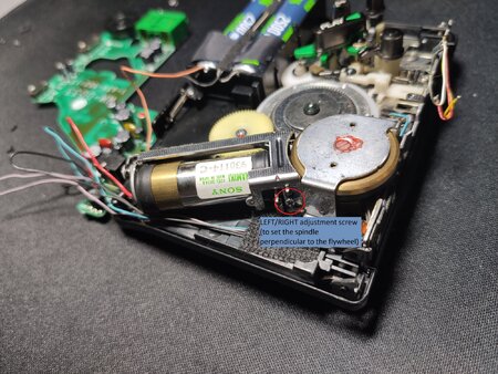

    2. Rotational movement (left/right)
    The position of the motor should be so the motor shaft is perpendicular to the flywheel. If this is not set right, there will be increased friction between the spindle and the rubber, creating wear, increasing mechanical noise, increasing wow&flutter and shortening the motor life (which is the most problematic, because there are not that many NOS motors available).
    - on units like D6C, TC-D5, the adjustment is done only by moving the motor around in its screw holes.
    You do not need any tool to do this correctly, eyeballing it is more than enough. It's not a micron precision adjustment, but it can be well off if it's ignored, which most people do because the play in the screw holes is not that high to give a second thought, but it's high enough to cause a significant mis-alignment.
    - on most DD series walkmans, there is an adjustment screw on the side of the motor bracket.
