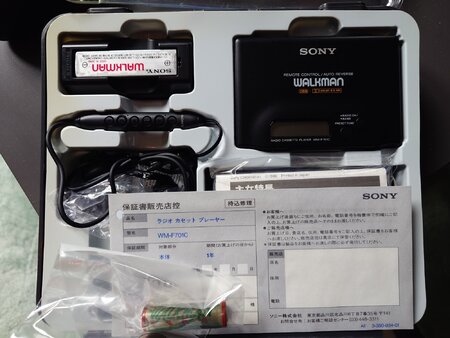

    I just picked up a completely BNIB Sony WM-F701C with all accessories which has never been used.
    WhatsApp Image 2024-04-21 at 11.07.18_e169afa0.jpg WhatsApp Image 2024-04-21 at 11.07.18_c28314e4.jpg
    After opening it up, the belt is completely gone (as expected). It otherwise seems totally flawless, no leakage, bad looking caps etc. Obviously might change when I actually get it working but for now it truly looks like it was manufactured yesterday not in 1988.

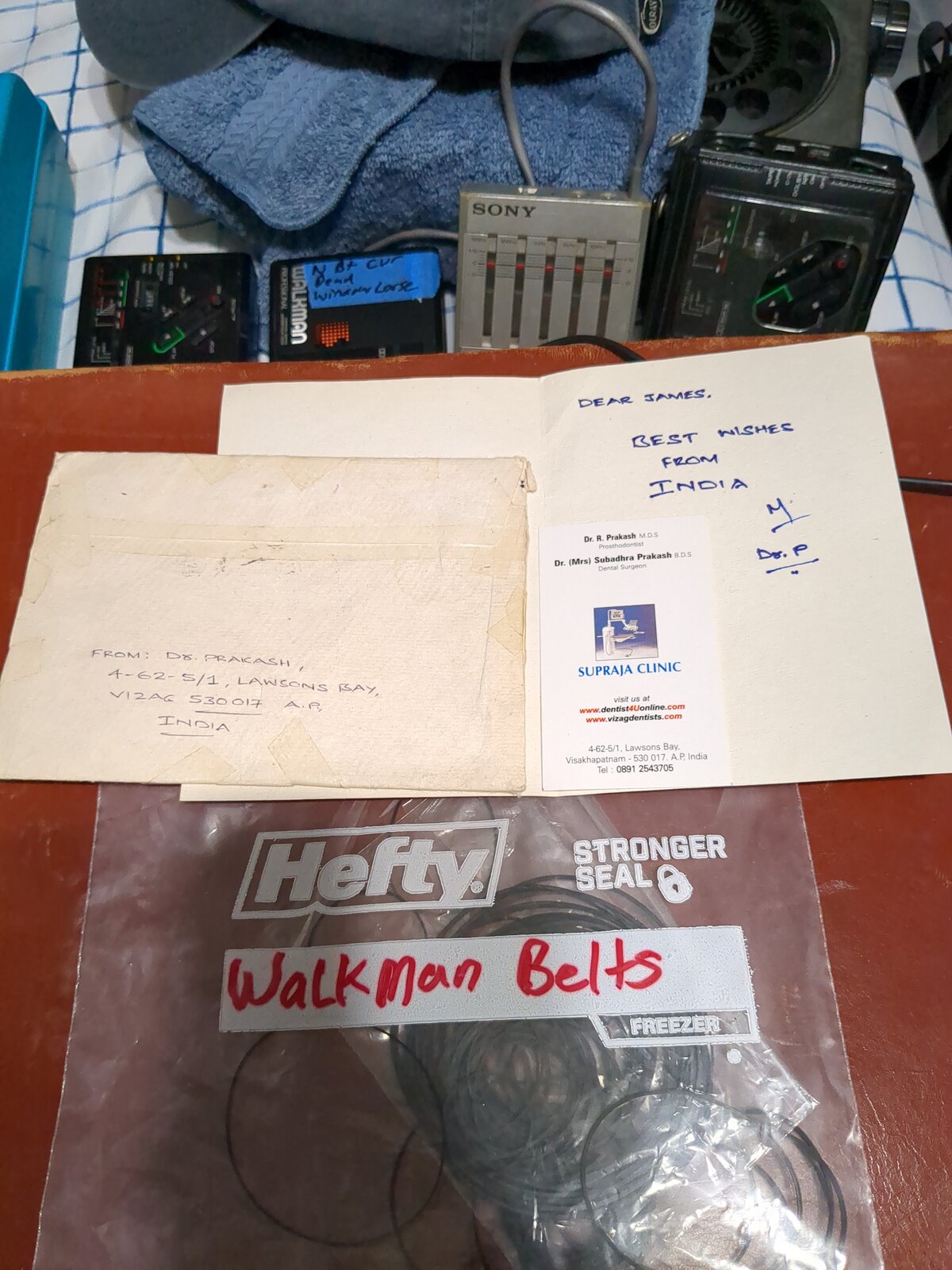

    17,108
    Everyone wants and needs belts, I think DocP is still around here also selling belts out of India.
    Matias, you have some very nice equipment on Instagram, you should post some of your equipment on here.

  13. Cassette2go
    1,574
    I cannot see the date on the postage stamp but I have had this for some time now
    Prosthodontist is what the doctor is and then his wife I guess is a dental surgeon. Just read the business card.
