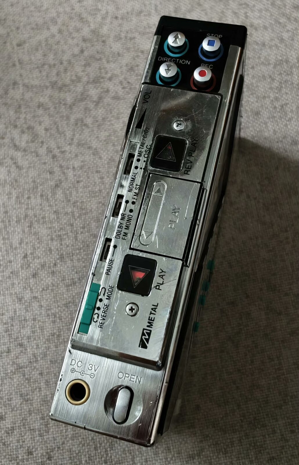

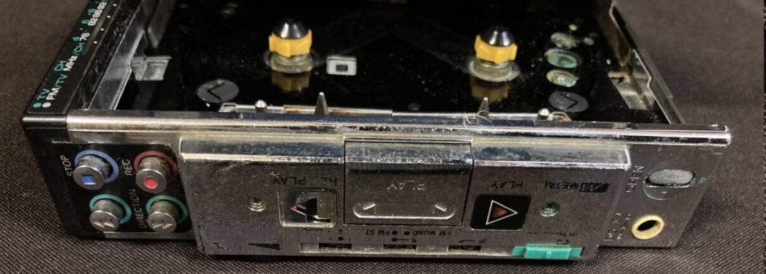

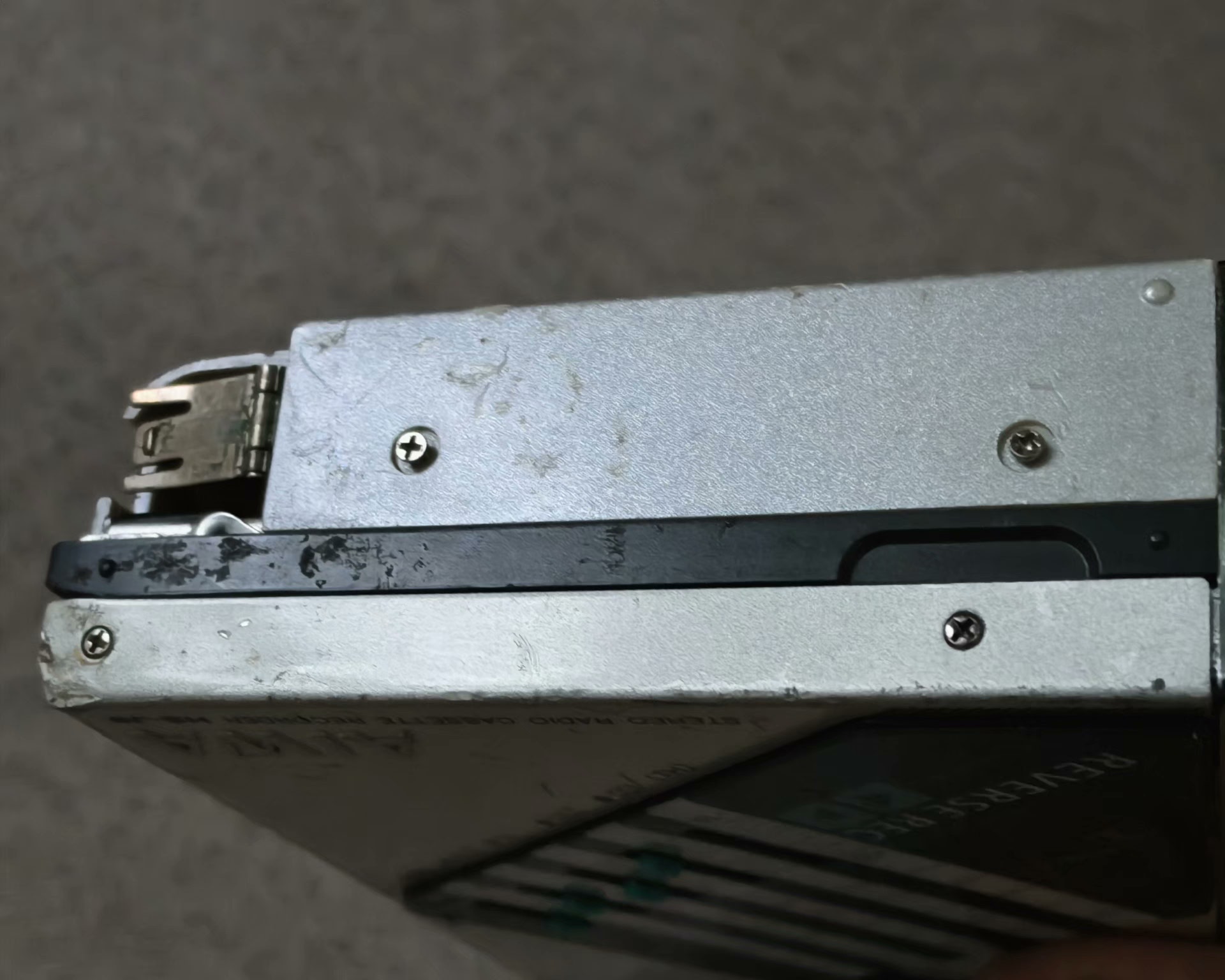

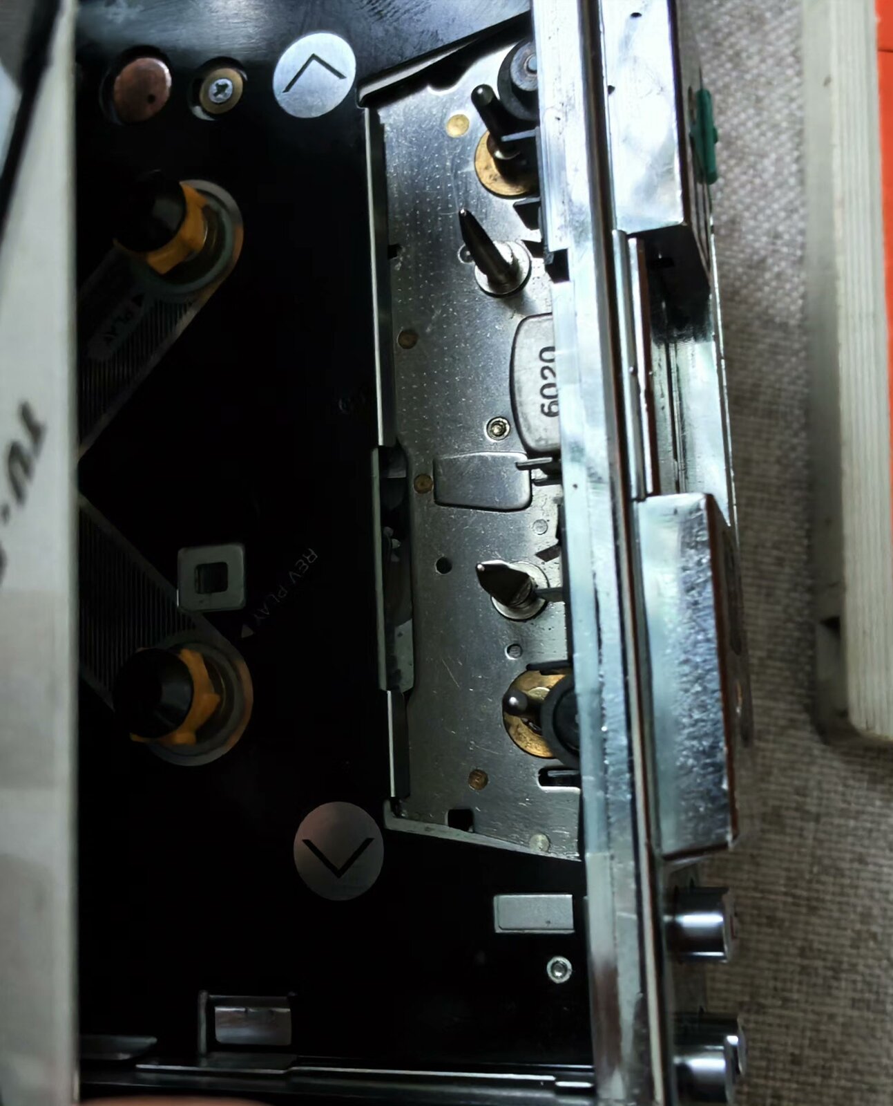

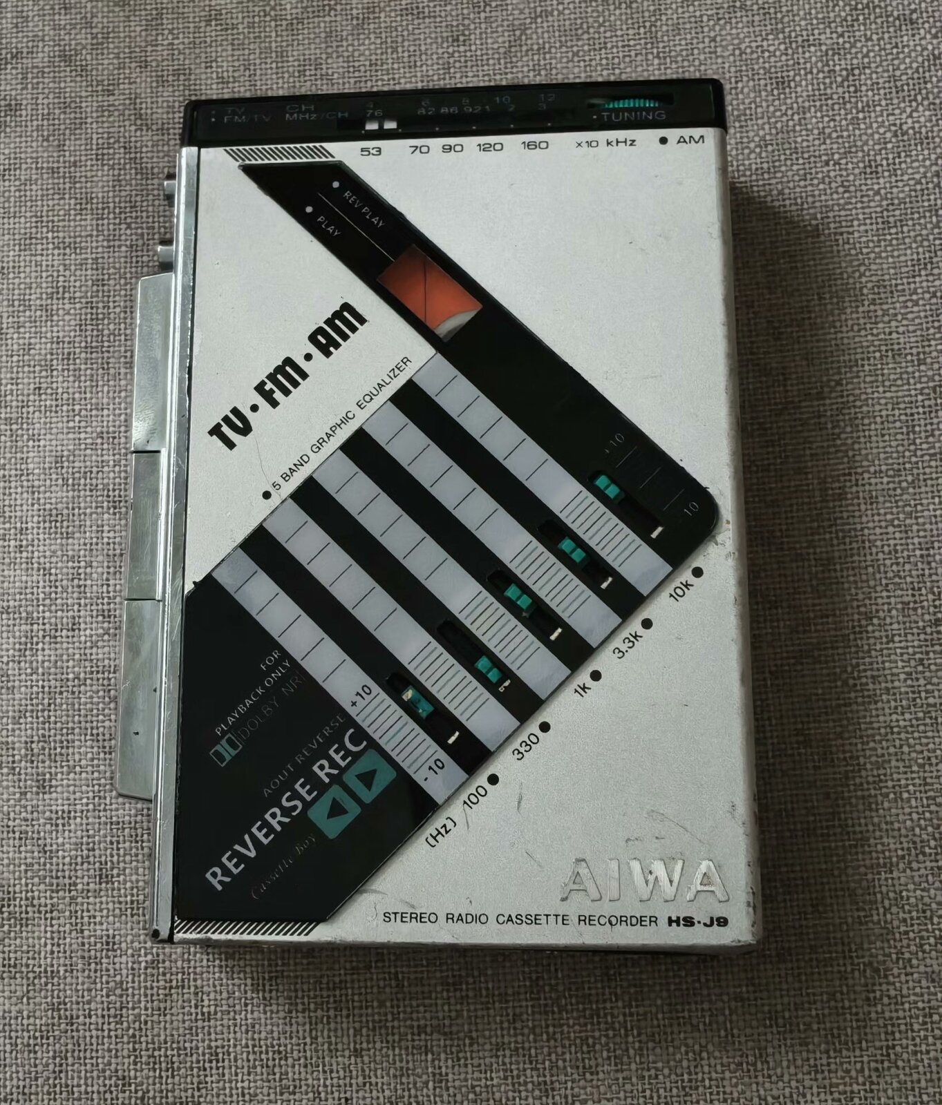

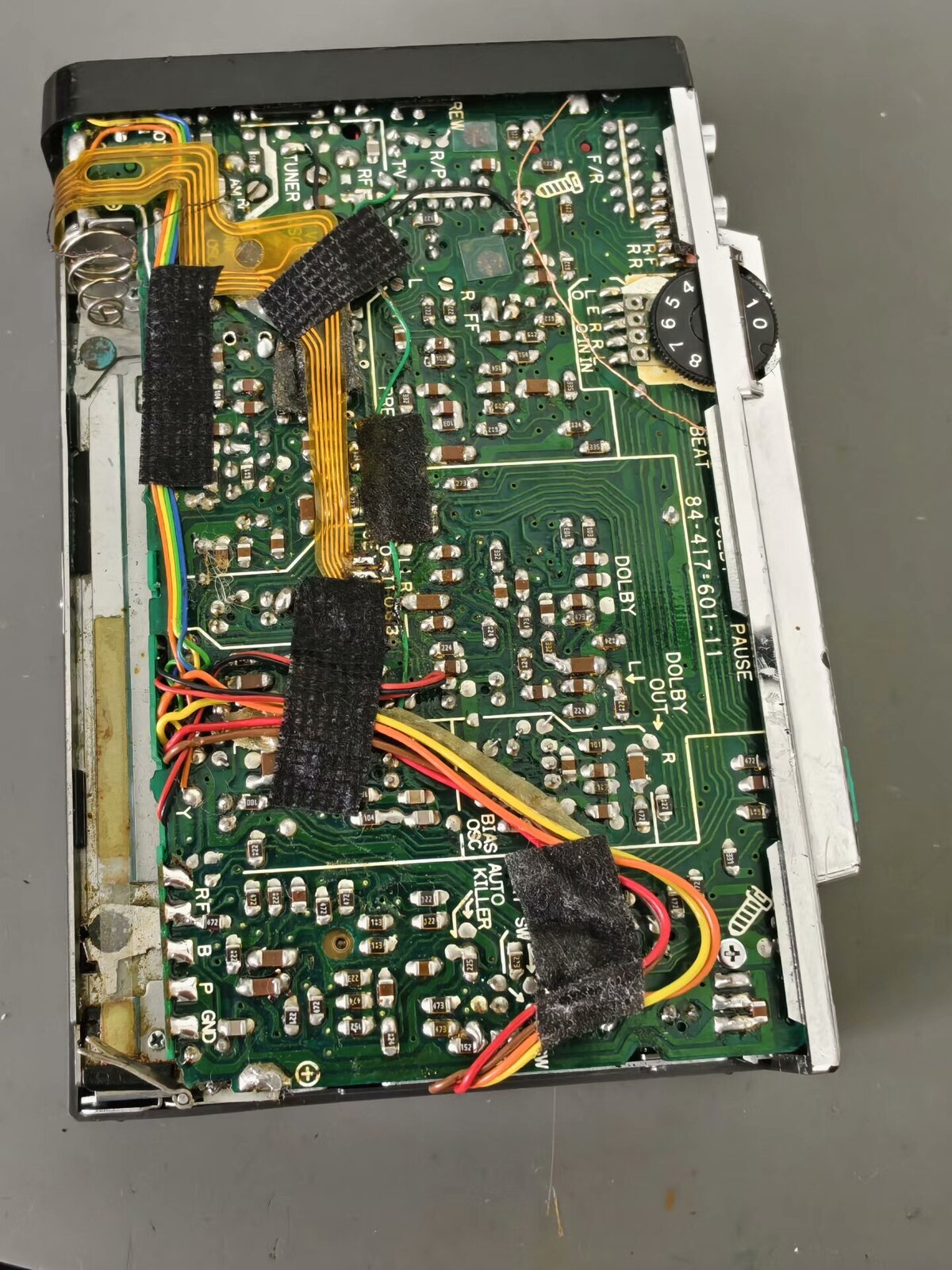

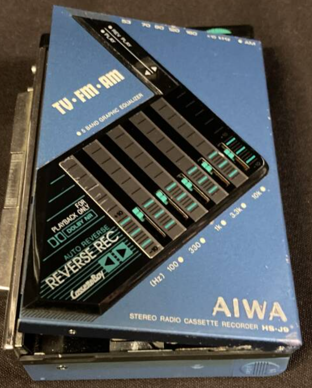

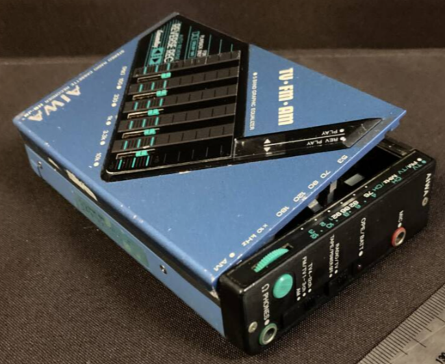

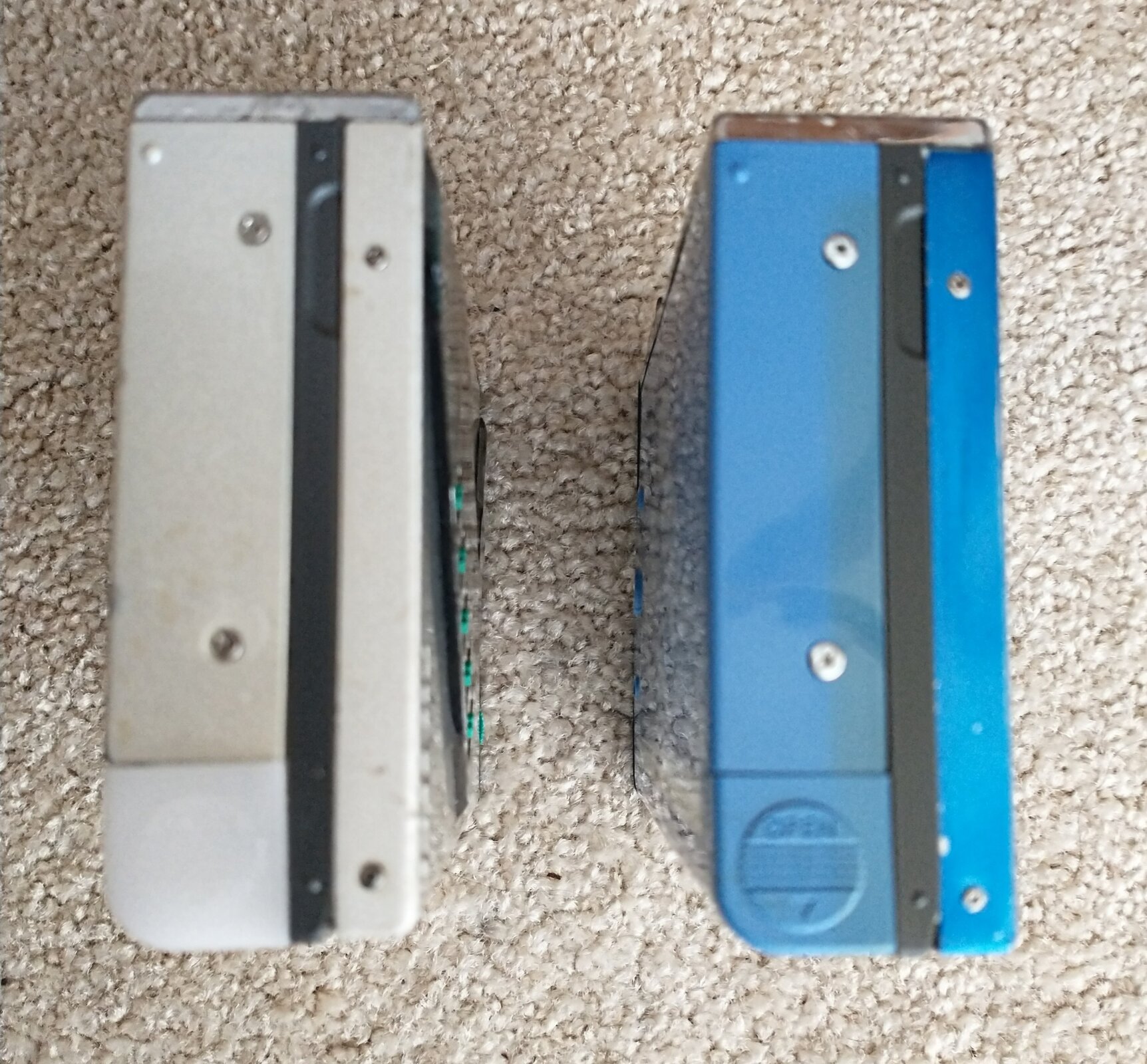

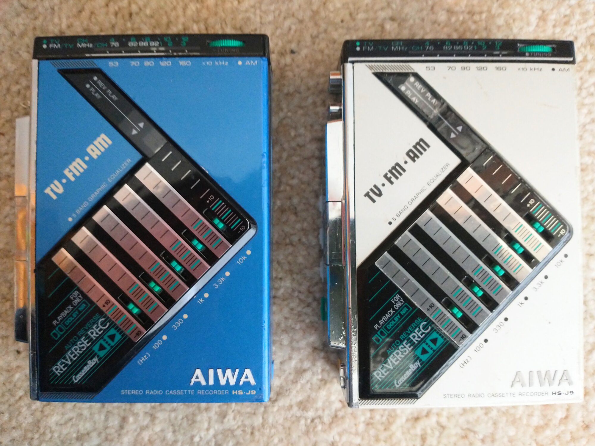

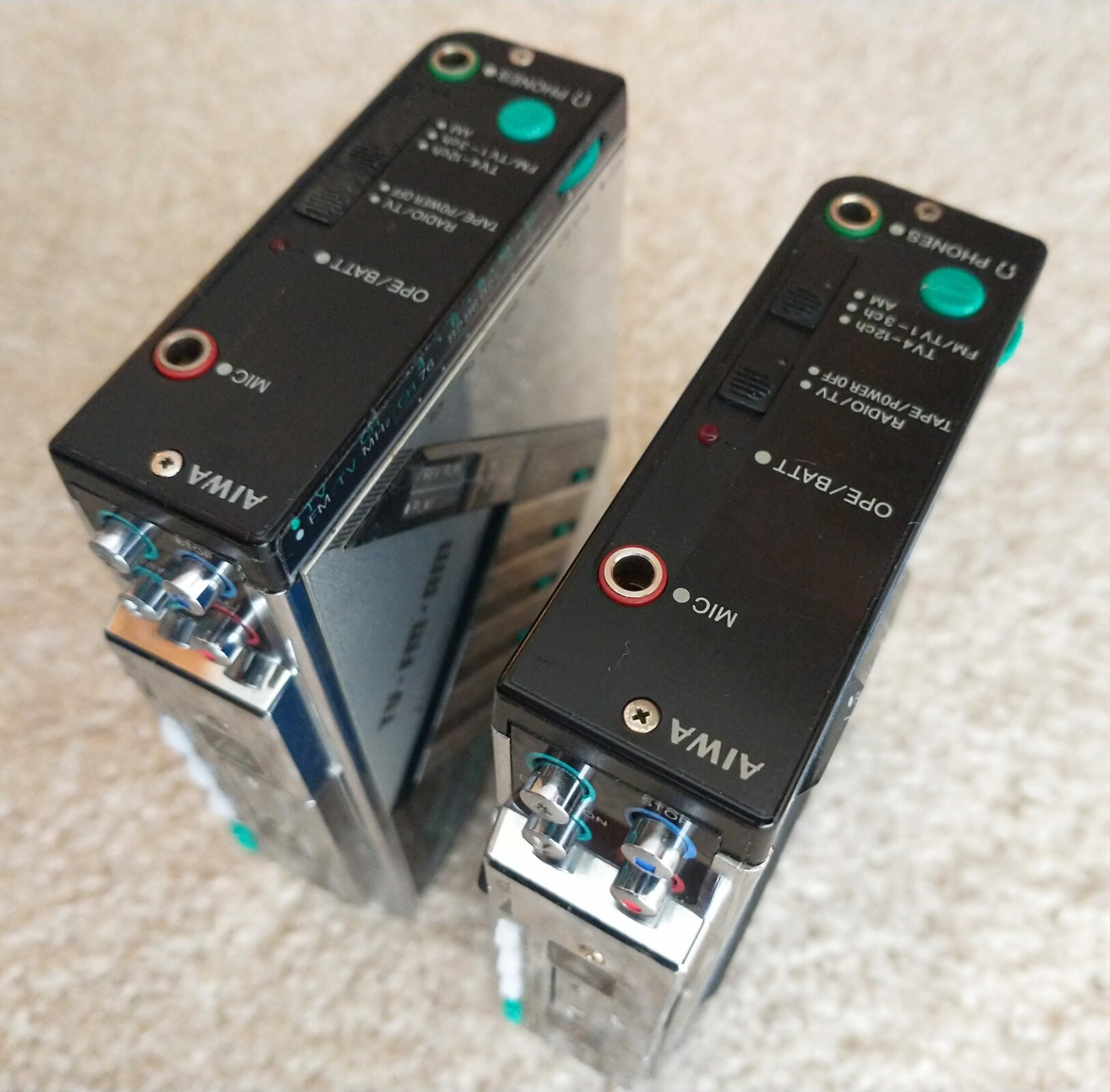

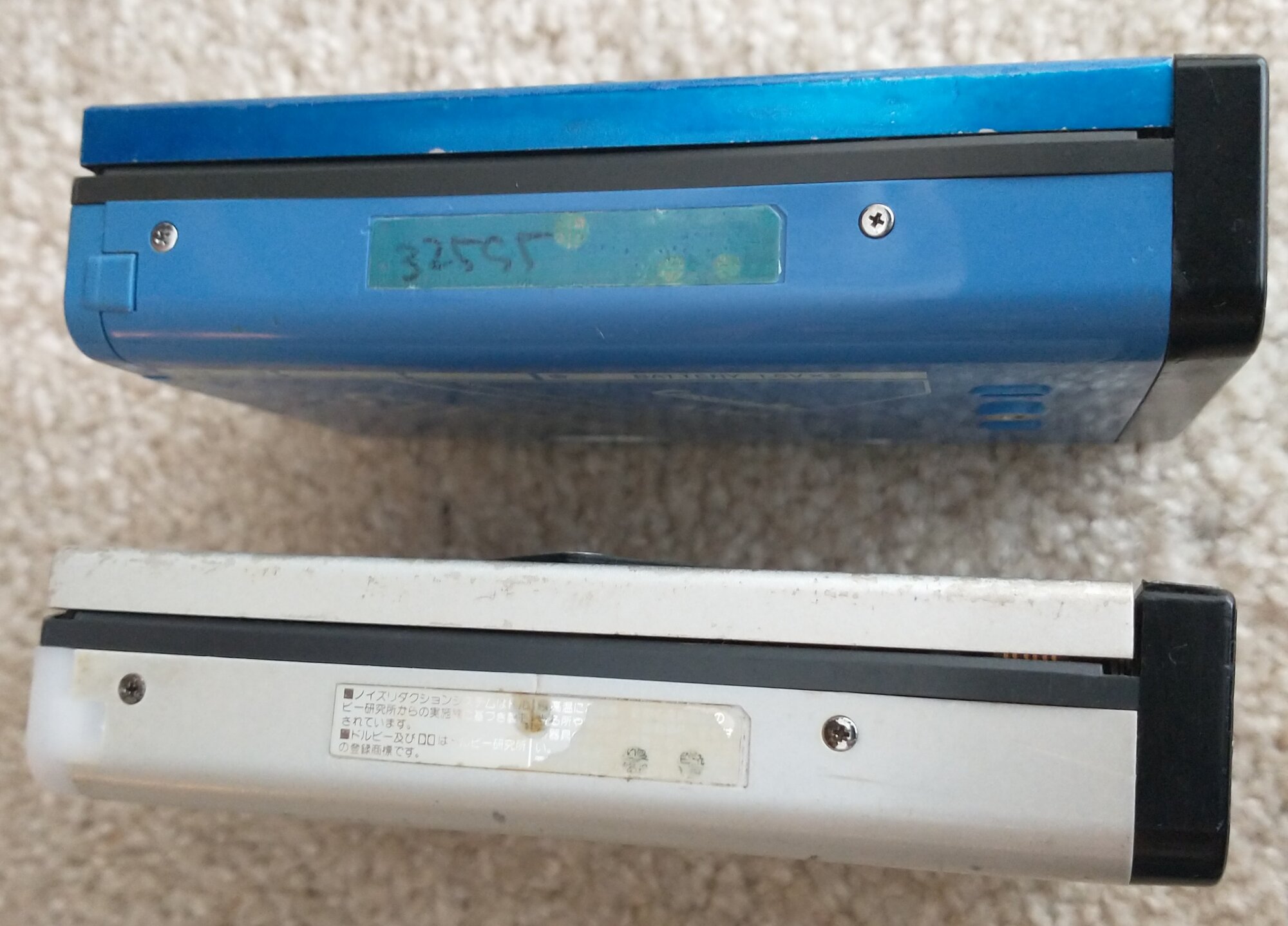

    Next project, turning two Aiwa J9's into one good one. The photos are from the sellers' ads.

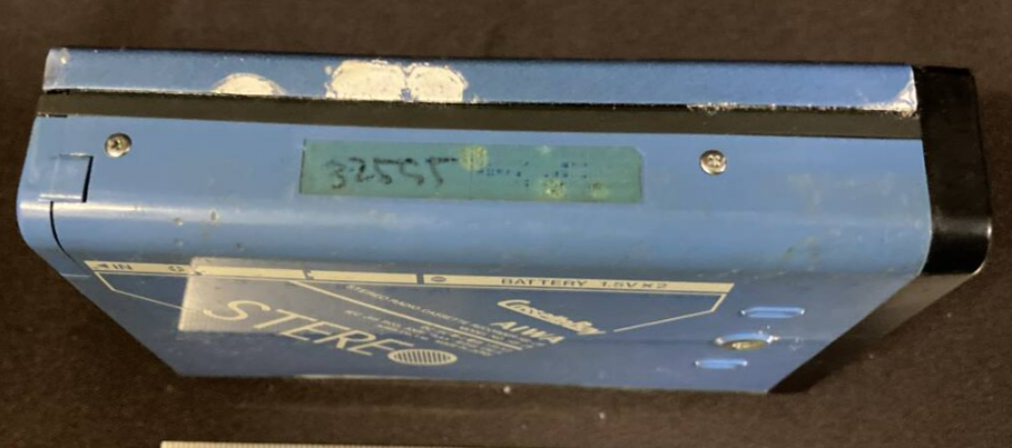

    Obviously the blue one is thoroughly corroded. I don't expect the motor, main board, or motor board to be usable. Even the mechanism would require more cleaning than it's worth. I hope the equalizer is ok because I need one for another unit.

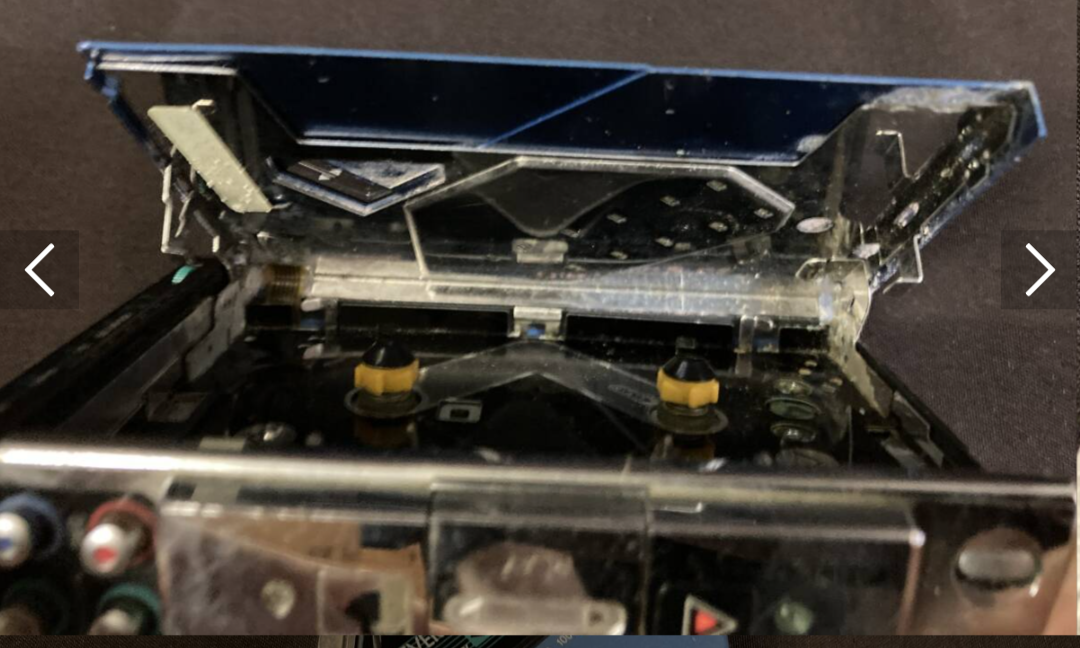

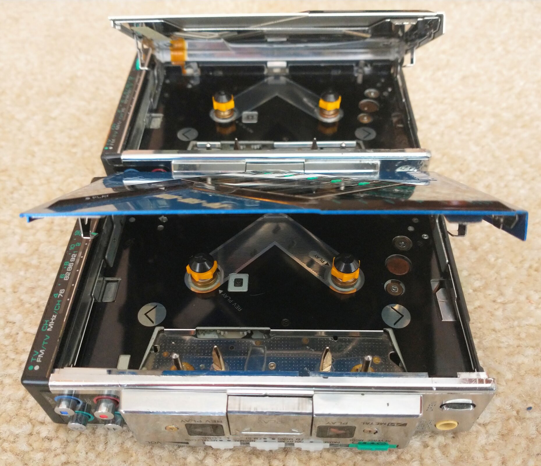

    The silver one has various bits missing. The missing radio dial knob is irreplaceable. Its insides look clean, but it will require the usual repairs.
    I hope to use the blue case parts as they are one of the rarest colors and luckily it has the blue battery lid. Fixing the metallic blue paint on the cassette lid will be the most difficult task. I may swap the blue panels with a black J9, since the silver ones are more desirable than black.

    Missing, irreplaceable dial part
    Nice clean main board.

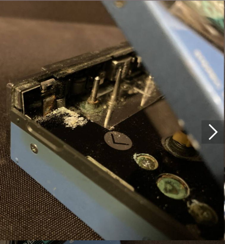

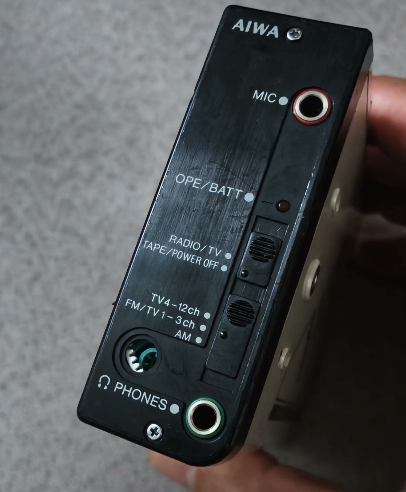

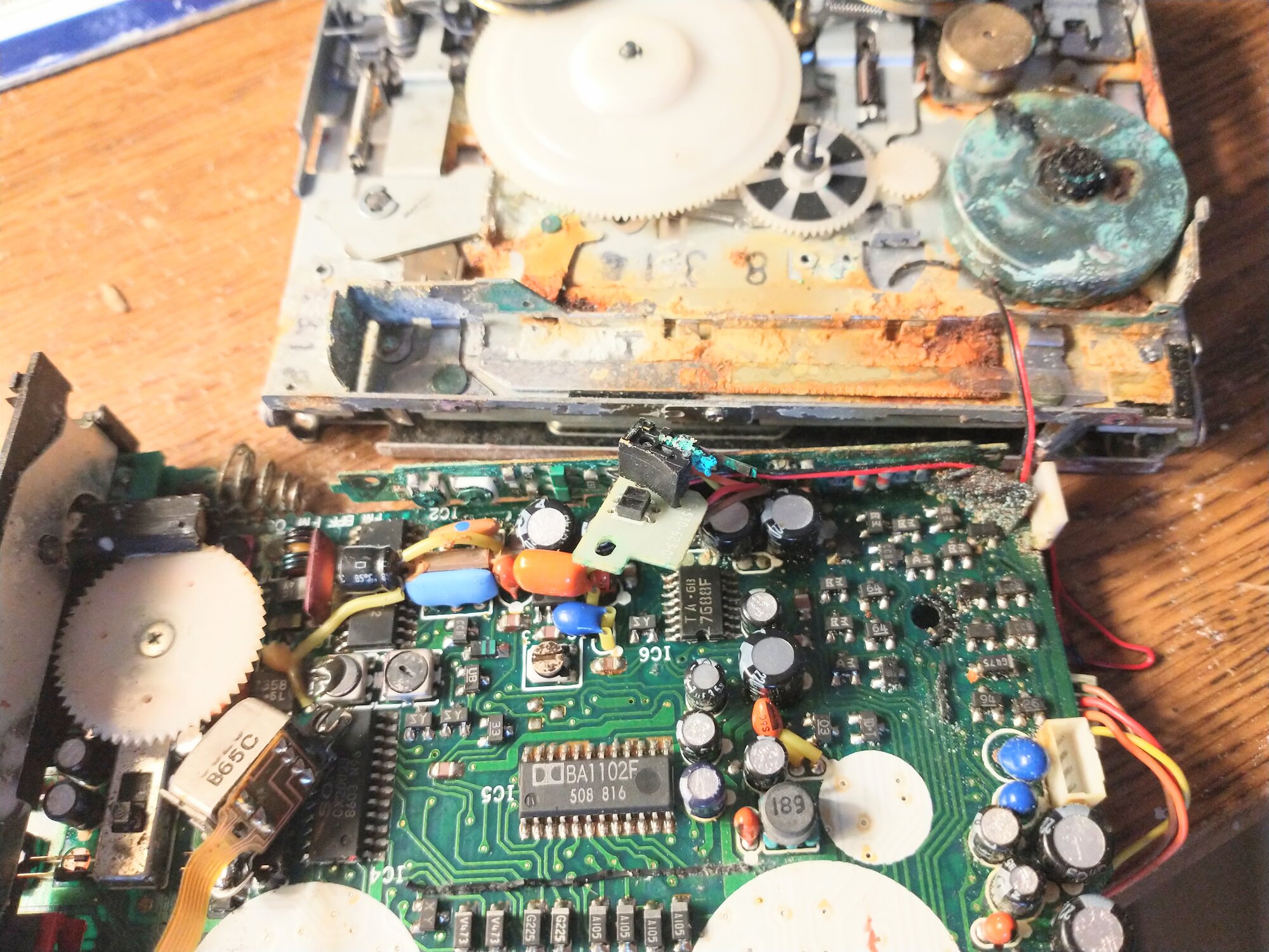

    And the blue one.

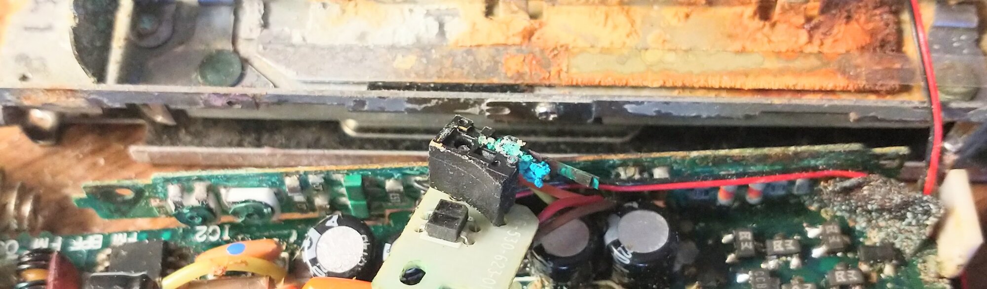

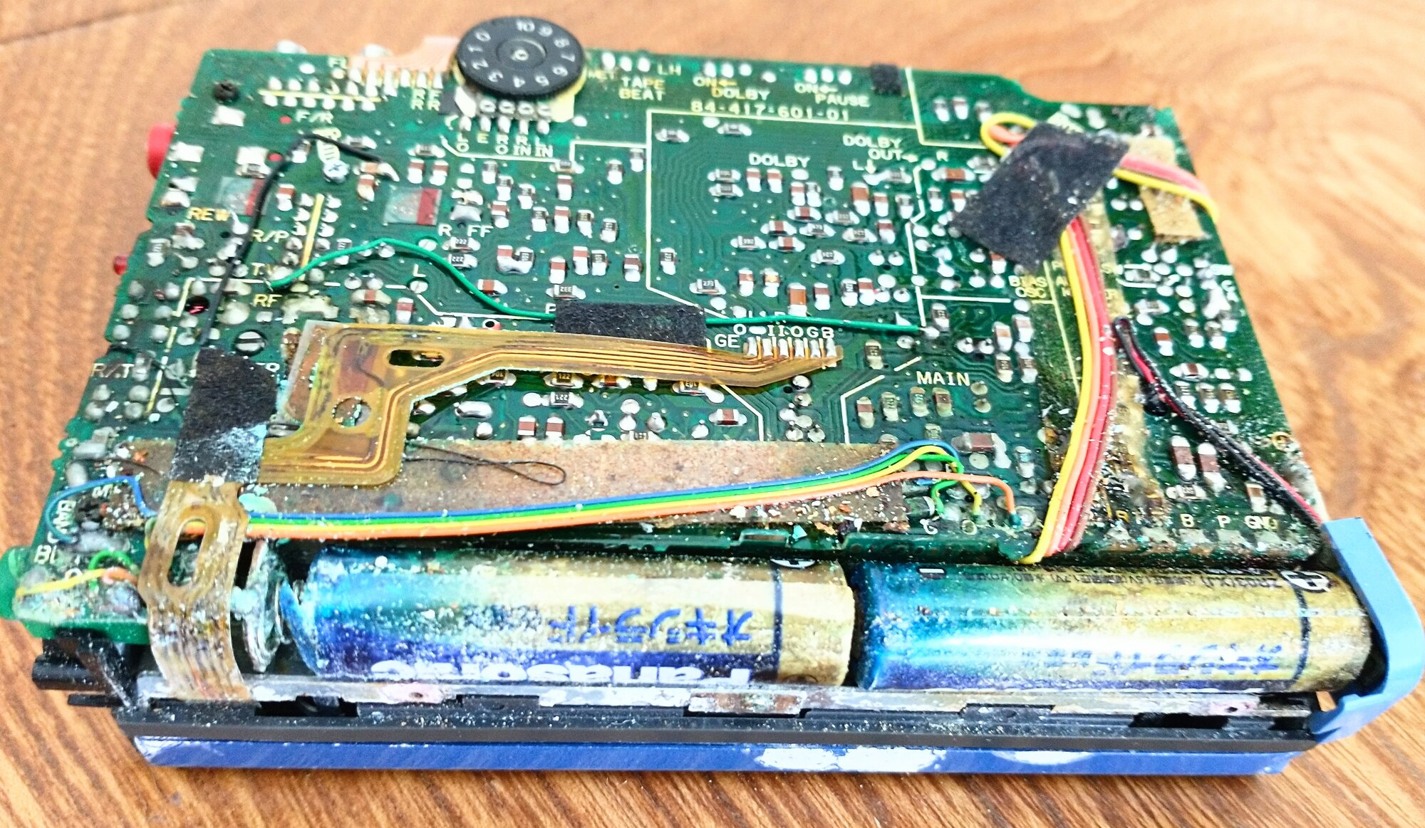

    Corrosion at the farthest areas from the battery compartment and on the motor mounts are very bad signs.

    After everything was sorted out, the silver panels were swapped with the blue ones from the #15 J9.
    Before and After photos. 14-J9-1.jpg 14-J9-2.jpg 14-J9-3.jpg 14-J9-6.jpg IMG_20260720_162703253~2.jpg IMG_20260720_162732265~2.jpg IMG_20260720_162805801~2.jpg

    This was the first player I've bought that was totally dead. The main board and the mechanism were extensively corroded. As you can see from the photos from the sales ad, the corrosion extended all the way from the battery compartment almost to the head. The sides of the painted aluminum front panel were corroded. Even the power led would not light up. I bought it for the blue panels, but decided to see if it could be coaxed back to life. Not surprisingly it was a big job.
    Rather than fix up the corroded mechanism, I used the previously refurbished mechanism from the #7 donor.
    The first repair was to get the power led to light up. First I disassembled and cleaned the corrosion out of the 3vdc socket. This didn't fix the led. (Rather than fiddling with batteries, which is very awkward when these Aiwas are not fully assembled, I use an Aiwa RB-100 charger while working in them.)
    Physically checking every trace on a populated 2-side main board to find corrosion breaks is just not practical. Instead, the process was to locate on the schematic diagram, components associated with the problem, use their part numbers to find them on the circuit image, map out the order and orientation of those parts, find the actual components on the main board, and finally check for continuity (or voltage, resistance etc.). Eventually installing a jumper wire bridged a break I never found and supplied power to the led. But there was still no audio and I didn't know if the tape drive worked.
    The earphone socket was also destroyed by corrosion, so I borrowed one from a J36.
    The tuner was corroded solid so I removed it, and with a combination of vinegar, contact cleaner and brute force, got it rotating. Still, radio silence from the radio. I couldn't tell if the tuner was good. I had bought a cheap J85 because it has tv reception, thinking I could use its FM/AM/TV tuner. But alas, the tuner in the J85 won't fit in the J9.

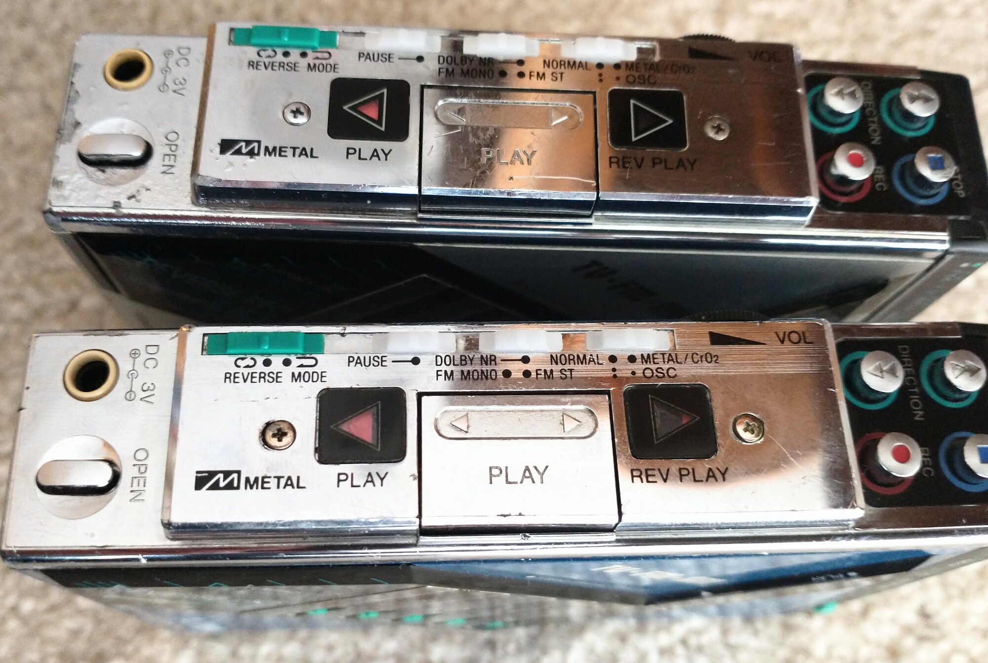

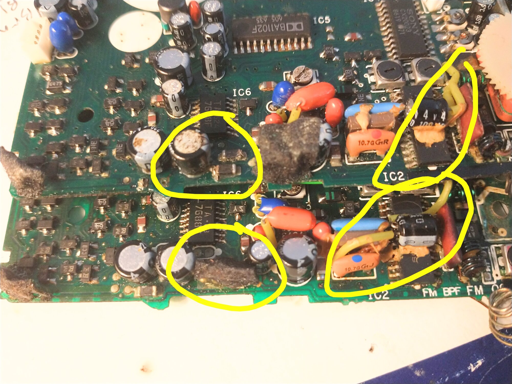

    To illustrate some of the differences between the early production Aiwa HS-J9 main boards, here are two of them. Among other differences, the two inductor coils are mounted on opposite sides of the boards. And again, these are different from the later production, and the J09/600. Of course these differences are concentrated right where battery leakage is most likely to corrode the board. IMG_20260711_130908957~2.jpg
