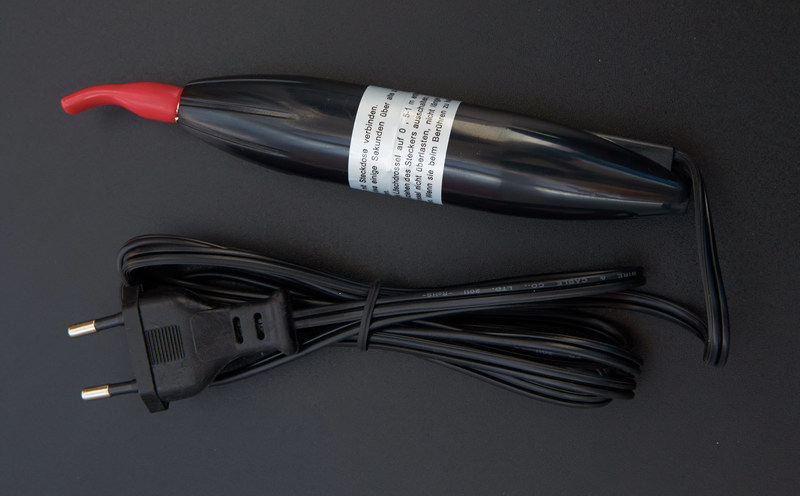

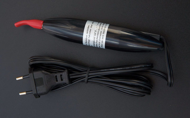

    I think I have to buy a head demagnetizer (I do not have it) ... any suggestion on what to buy ?
    thanks

    I have this one and also another one that is way more powerful:
    I bought it at eBay years ago and it has served me well to demagnetize my decks. You should be very careful with it, though. It has a very strong magnet field...

    That is the most readily available on ebay but i'm afraid too is it too powerful for walkman heads. Do you also use it on your DD's ?
    I think it is intended for R2R with bigger heads and more robust electronics.
    thanks
  8. walkman archive
    1,896
    I think it can be used with decks and walkmans too, but @Doctor Walkman can answer that.
    You have to put it very close to the head (a pair of mm), connect it and slowly take it away from the head. When it's about 1,5m or so, you can disconnect it.
