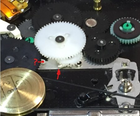

    Installed new belt from Marian: belt appears to work, however doesn't play , but will rewind one direction: I notice there appears to be "reversing gear" that flops around, and it's not very clear from service manual, but i think a linkage has come apart... can someone with more experience confirm? I have taken off larger white gear and notice smaller reverse gear seems to have place to link, i marked with question mark on photo...
    tries to run in REW and stops, but FF will keep running, but noisy... maybe this gear is "flopping?

    ..Also, I pushed in the solenoid and spun the left capstan pulley, which then changed the FF/REW position, but can't figure out how to get it back in the center position... advice appreciated here too...

  3. Valentin
    2,130
    What is depicted in the service manual is not useful, it only shows the parts without explaining how the mechanism works.
    The floppying gear should have a spring, so that when it is initially rotated, the whole arm on which it sits rotates together with the gear. That gear is used for FF/REW. FF and REW are engaged just by rotating the motor clockwise/counterclockwise.
    Then FWD and REV (forward and reverse play) are engaged by the cam gear, moving the head towards the tape, engaging one of the pinch rollers and moving one of the gears to drive the respective takeup reel.
    You bring the mech back to middle position by turning the capstan pulley backwards.
    First, you need to check the mechanical operation manually. If everything is working ok by hand, it means the problem is in the electronics.

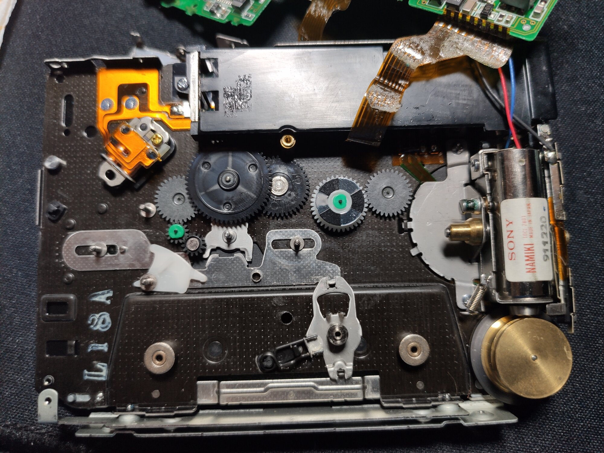

    Comparing EX808 with donor EX707 mechanism (included free artwork!)
    There is a difference on one gear with green keeper (clutch?)
    small gear for direction shift, mounted under lower white gear, moves left/right freely depending on FWD/REV direction (just like EX808)
    the EX707 mechanism shifted FWD/REV pretty easily, i had to manually push solenoid to start shift sequence... I will inspect cam and white arm.

  14. Valentin
    2,130
    The 2 mechanisms are the same, apart from that magnet for the hall sensor to pick up table reel rotation signal which is bigger and more elevated on the 707,
    but I think the magnet can be taken out (look it's hold with 3 clips), so in my opinion everything looks identical and the 2 are interchanghable (unless one would need exactly that magnet, but it's unlikely).
    Even the motor looks to be the same, although seems to have a different flex cable going to the board, but that can be swapped anyway. I'm stating for other people reading, in this case it's not needed and donor motor is trash.
    Dfcruiser likes this.
