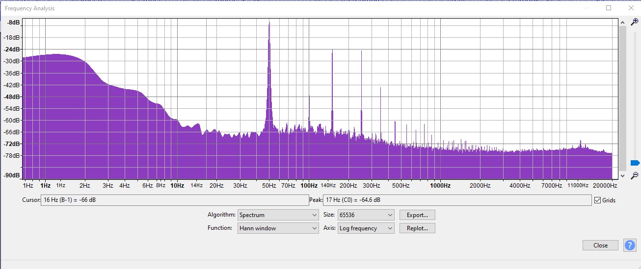

    I attach a frequency analysis done in Audacity on the file you attached. It can be clearly seen that the main tone is 50Hz, not 100Hz. I assume the device uses a full-wave bridge rectifier (this needs to be double checked on a schamtic), which would generate 100Hz ripple.
    I'm interested to see the schematic, cause I don't know if the power amp is a single IC for both channels or separate amps.
