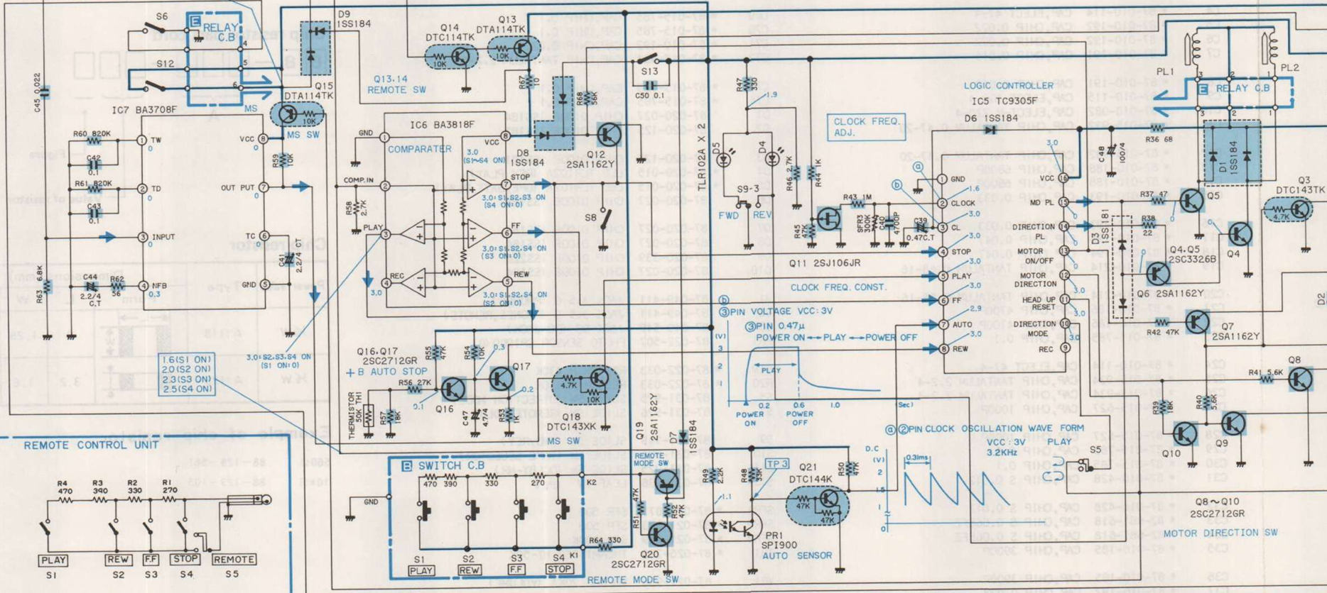

  2. Valentin
    1,997
    First thing I would check is what happens at pin 4 of IC5. This should stay high (3V) and be pulled low (0V) briefly only when STOP is triggered.
    The buttons generate an analog voltage (through the resistor ladder) which is fed to IC6 comparator which generates the digital control singals that control IC5.
    The STOP signal can come either from IC6 or from Q20 (pulling pin7 of IC6 to ground). If this pin stays at 0V all the time, I would desolder Q20 to isolate the problem.

    I just checked pin 4 of IC5; it provides a constant 3V. When I press play, it drops to 2.7V, and when I press stop, it goes to zero. I removed Q20 as you suggested, but there was no change. I had also tried removing Q16 and Q17, which seem to be related to the autostop activation, but there was no modification in the behavior.
